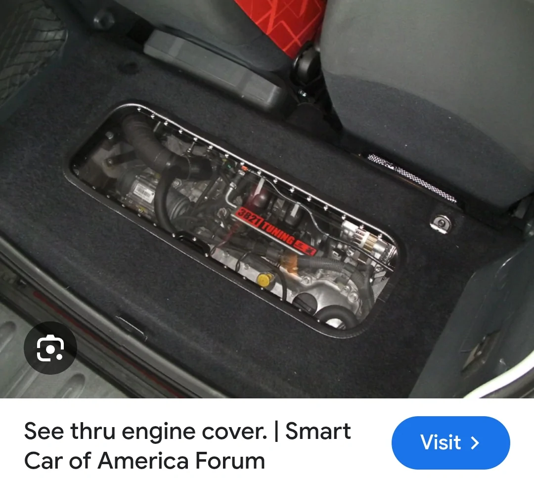

smart car had a see-through engine cover available from customizers.😆😆
Ford Maverick Intake noises - anything to be gained? Screenshot_2026-07-01-16-56-03-76_40deb401b9ffe8e1df2f1cc5ba480b12
