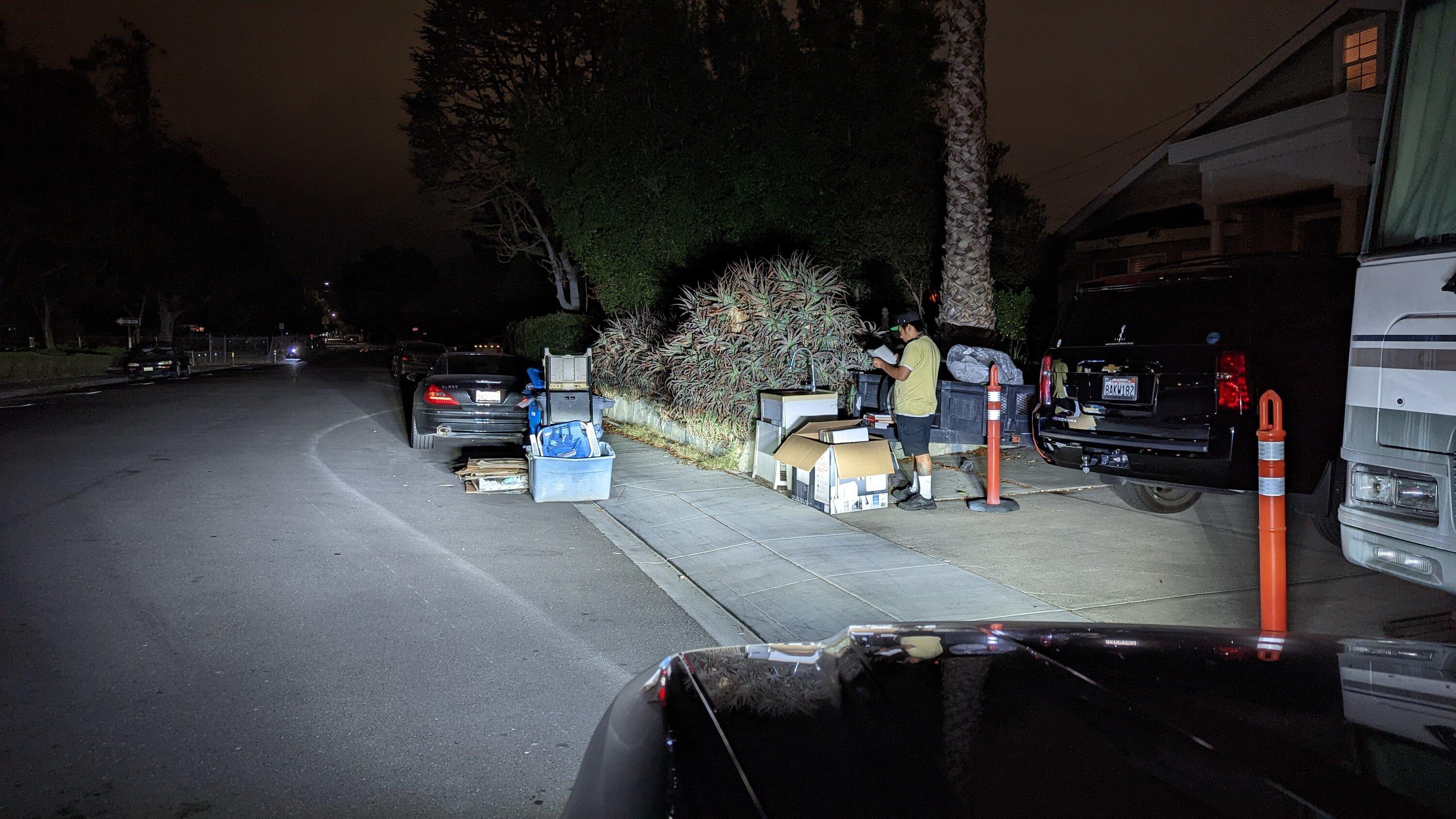

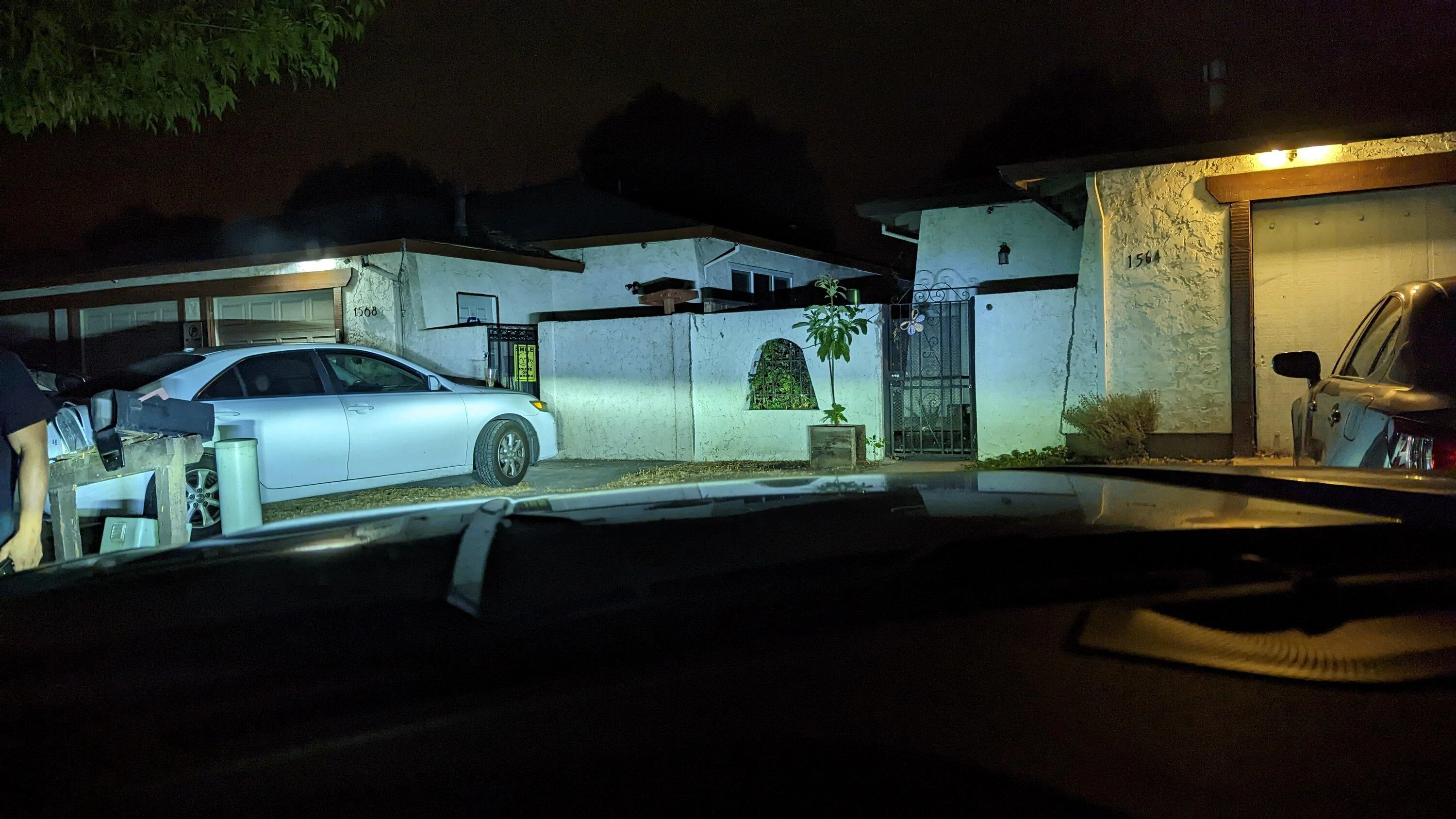

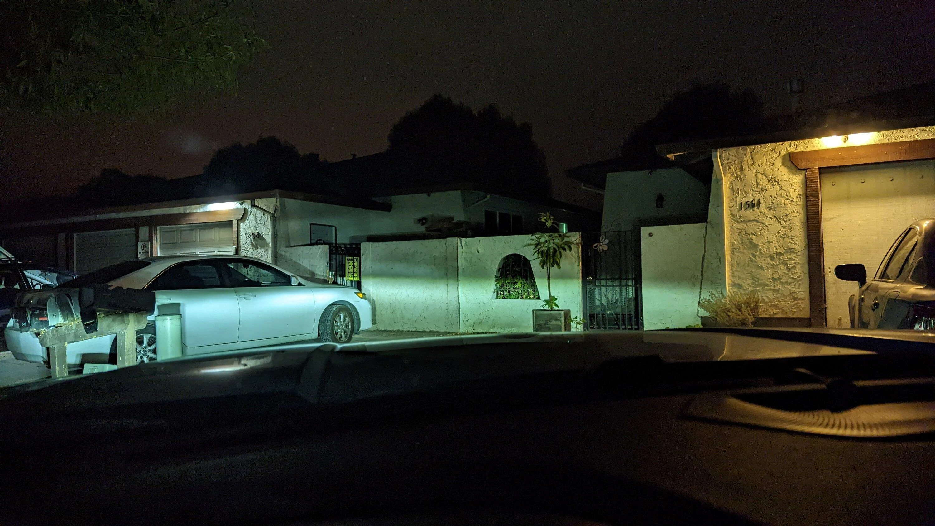

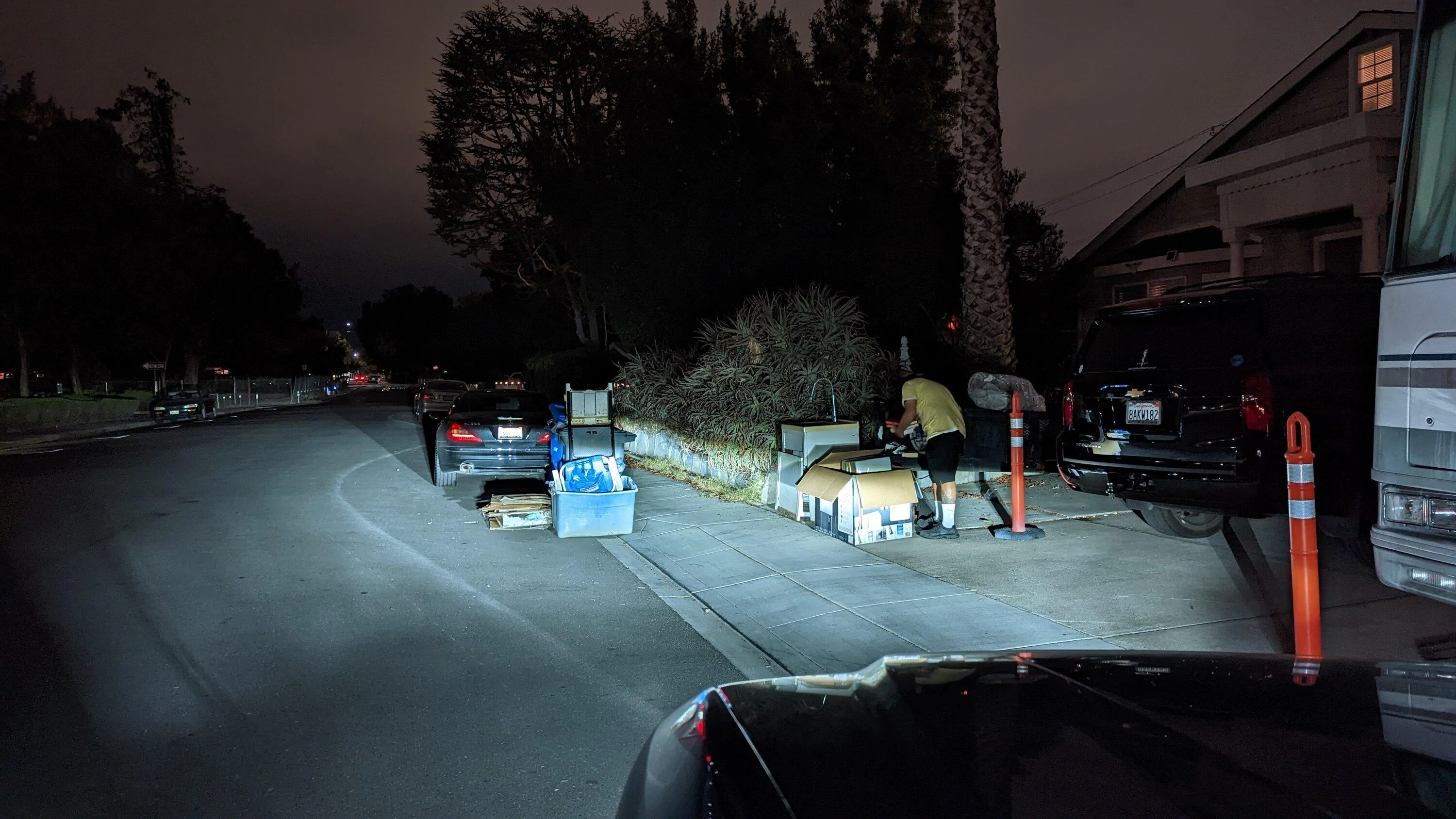

This is the best looking aftermarket light install I have seen. So clean and prefect fit.
Over the years I have had cars / trucks with, Fog lights, driving lights, or off road LED lights. They can make a huge difference if you live where they are needed.
Where are you putting the switch for the lights and where are you getting power for them?

I currently have a switch just dangling. But I plan making a bracket/mount for the switch pros to go in the area next to the radio/H.U. display hole .
