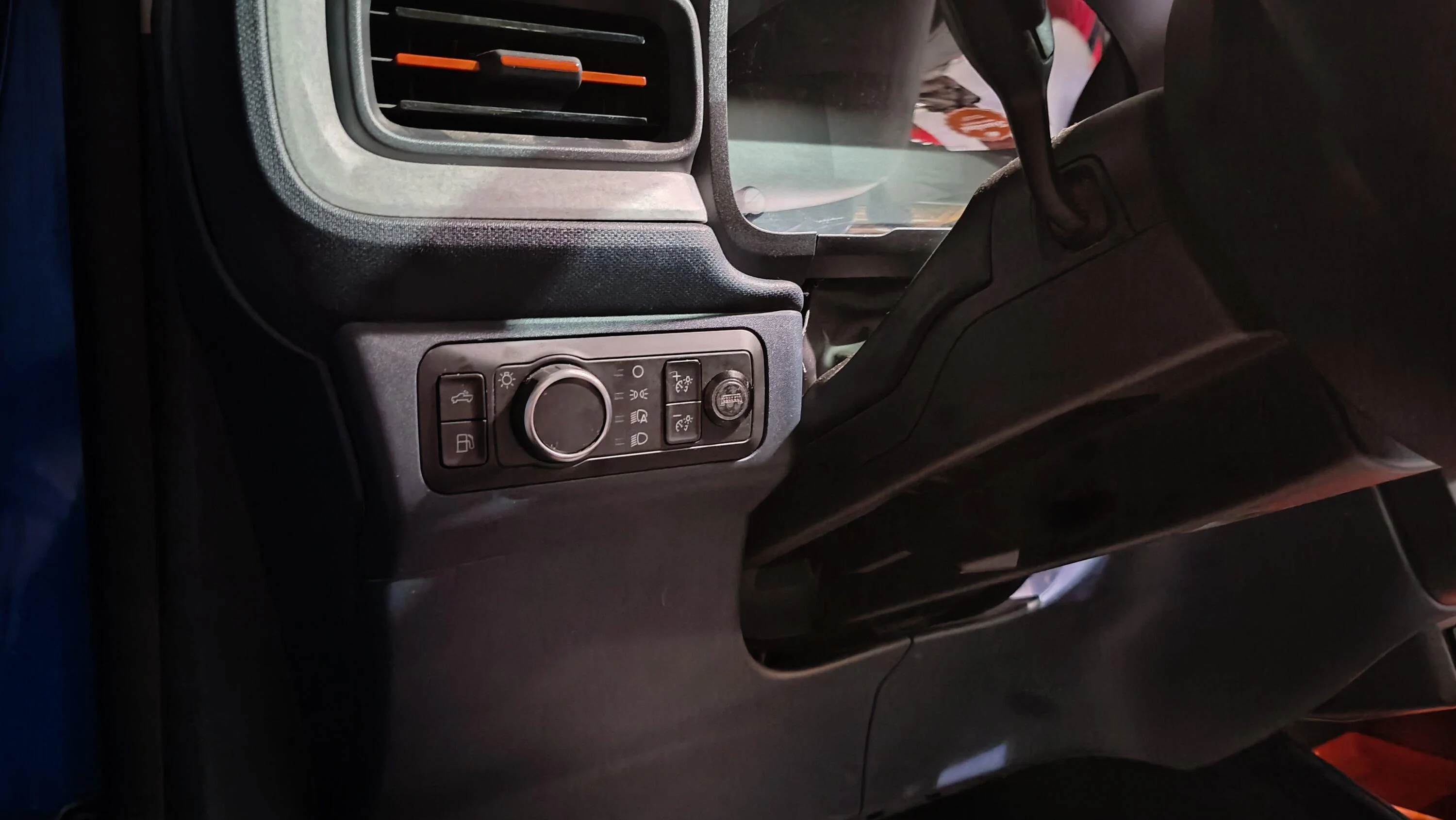

I have one of the Raptor style grills on my Maverick which helps me a lot with the decision to mount it, as it means I don't need to cut the factory grille to install the light bar. I also think the Raptor grille suites the light bar better. I am extremely happy with how the install turned out. I am not going to make a detailed install tutorial because I am definitely no pro and there is a fair amount of risk when it comes to wiring and cutting. I had to have to take the whole front fascia off, drill the mounts into the a securely mounted plastic piece (behind the grille but in front of the radiator shutters, it seems to be there to make the radiator function like a ram air intake and is just molded plastic), wire the relay to the frame and the positive to the positive terminal next to the jump terminal in the engine bay, and run a fuse tap from the footwell through the bay to the switch that I mounted with the rest of the lighting adjustment by the steering wheel.

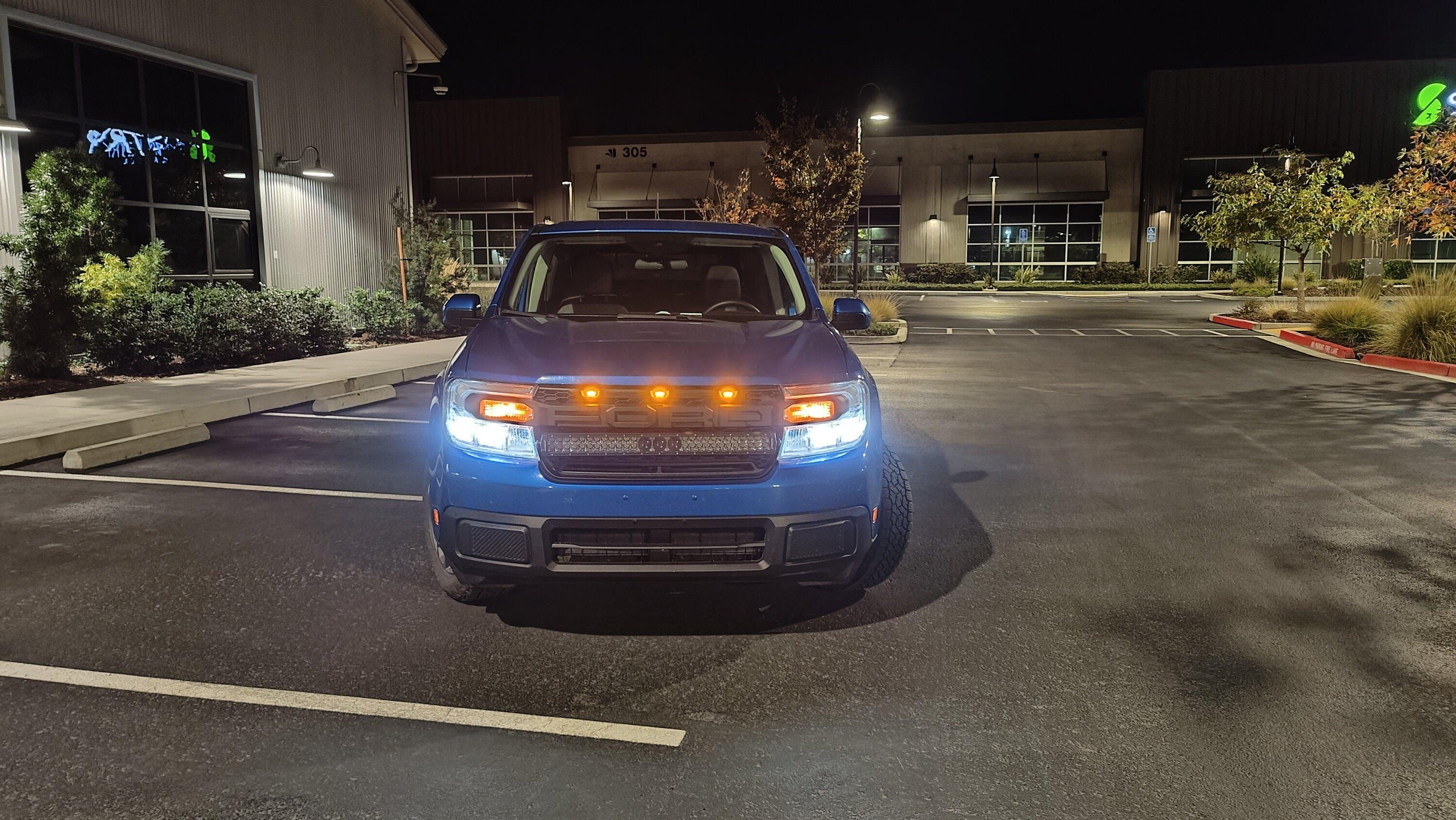

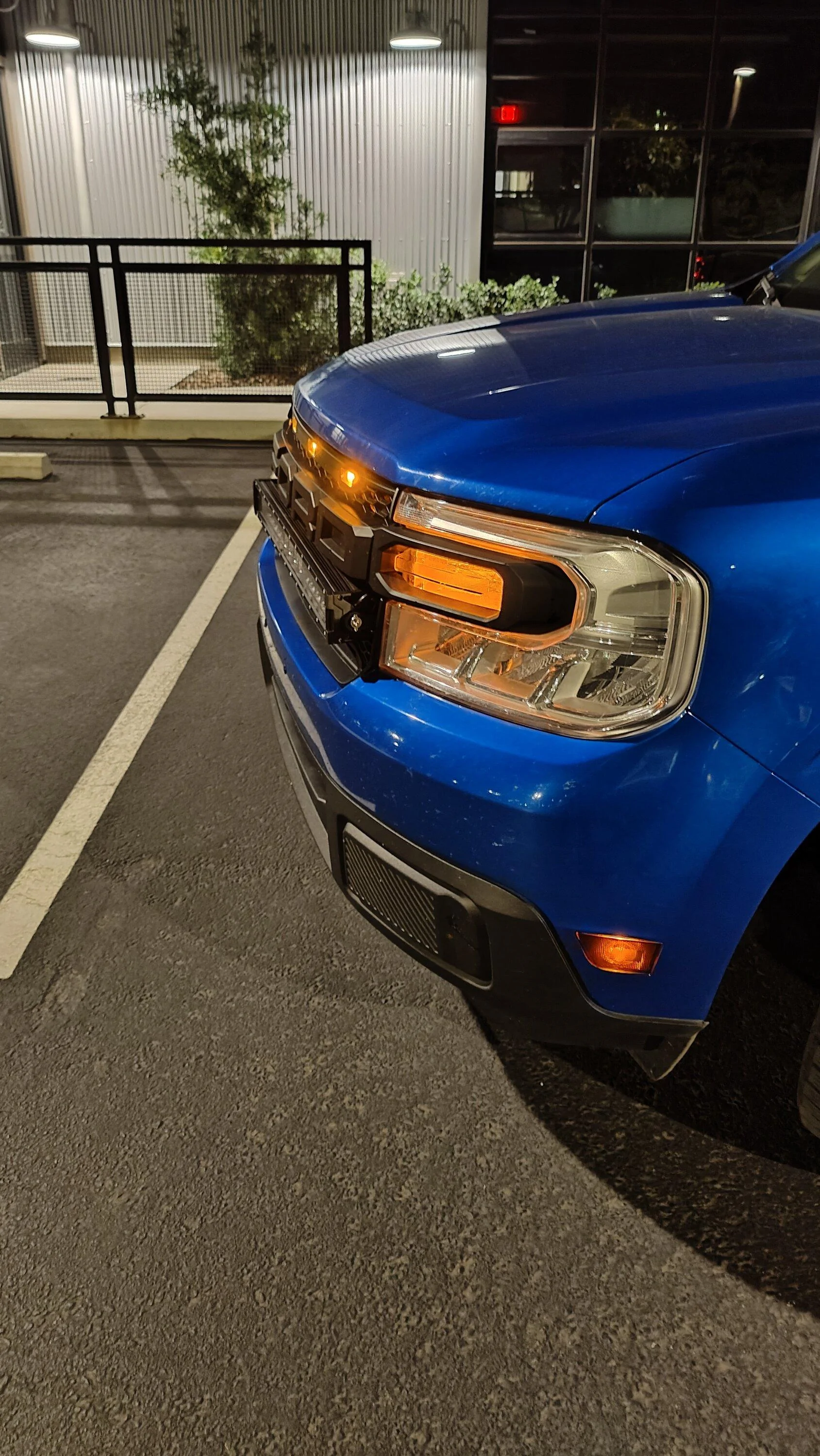

Not invisible, but I don't think it's too ugly
Trying to keep it looking OEM

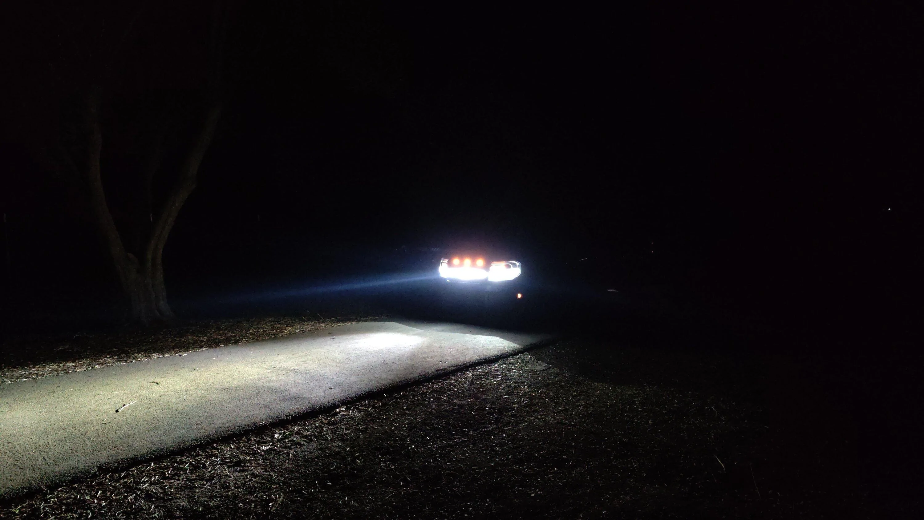

Due to the radiator shutters system the light bar cannot be set back any farther than it is here. But the bar still does not stick out any farther than the bumper.
