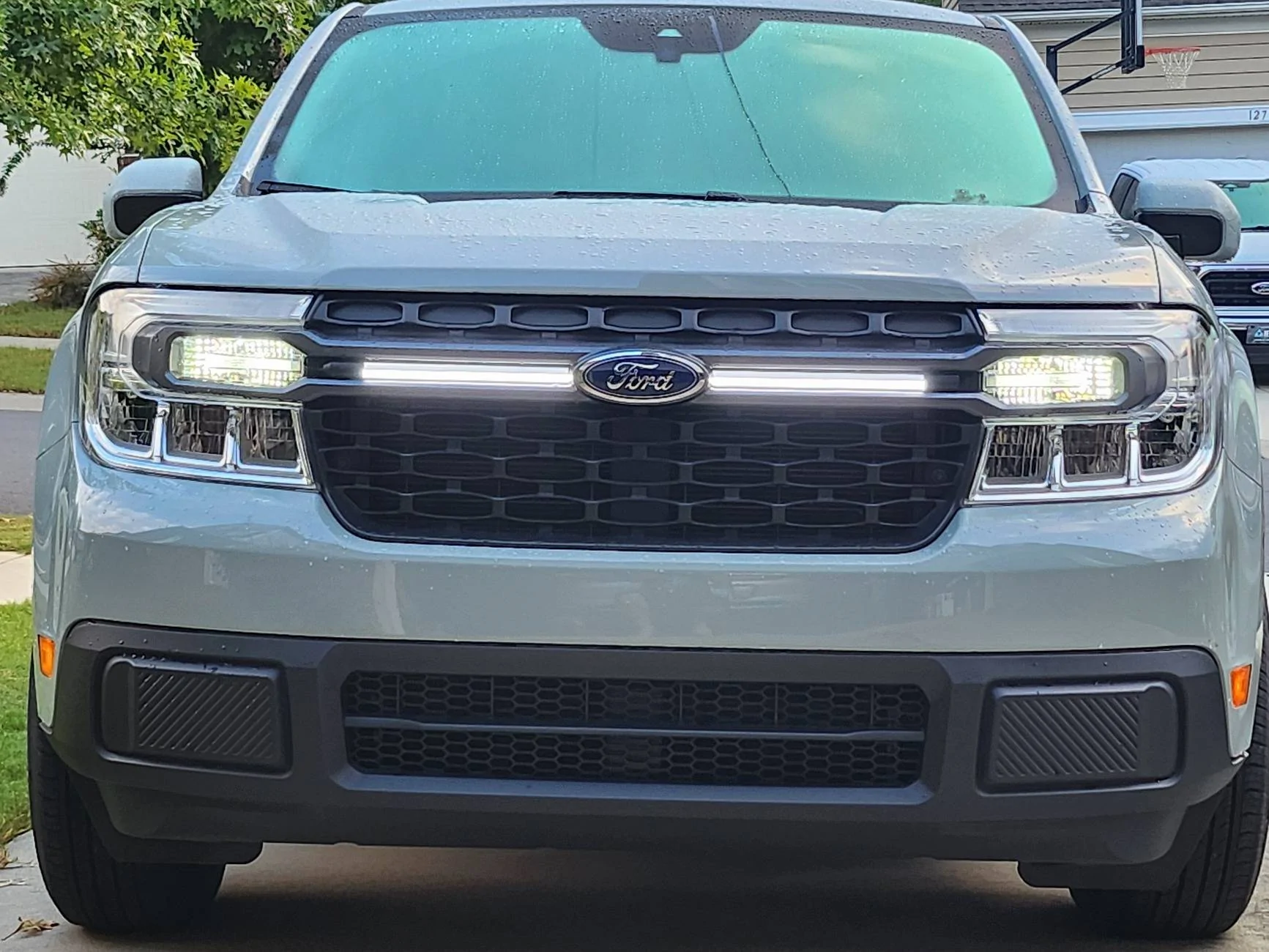

Here's an option for the XLT lights used a Putxo light bar and lasfit switchback turnsignals. I hope Putco eventually releases an illuminated Ford emblem for the Maverick.
The lightbar looks great on your Maverick, David 🤩 enjoy your truck!
I'm surprised you didn't get more compliments on this setup. It looks great. Can you post details on the install? Maybe a video of startup? Thanks.

Unfortunately didn't make an install video here is a video of the start up. Thanks! Biggest challenge is getting the grille pulled back, the molding removed and Dremel around the emblem on molding to fit the light bar. There are videos out there showing how to remove grille and emblem molding. I will try to find the one I used and post.

Did you use the 32" or 37" blade? Did you tap a fuse or drl connector? You actually already answered most of my questions as far as fitment. The rest I can probably figure out. Thanks!
