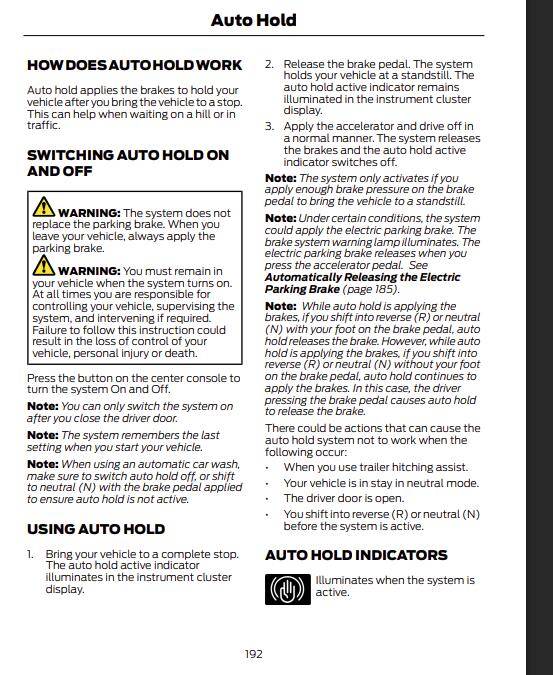

In the book
Ford Maverick ICON on my dash - what is it? {filename}
Apps on paper. Very useful.
very good, thanks for posting that. I couldn’t find it anywhere. The icons page doesn’t show it as an icon.
Hard to search for it when you don’t know what to call it.

Auto Brake Hold. Ahh, that makes since.
