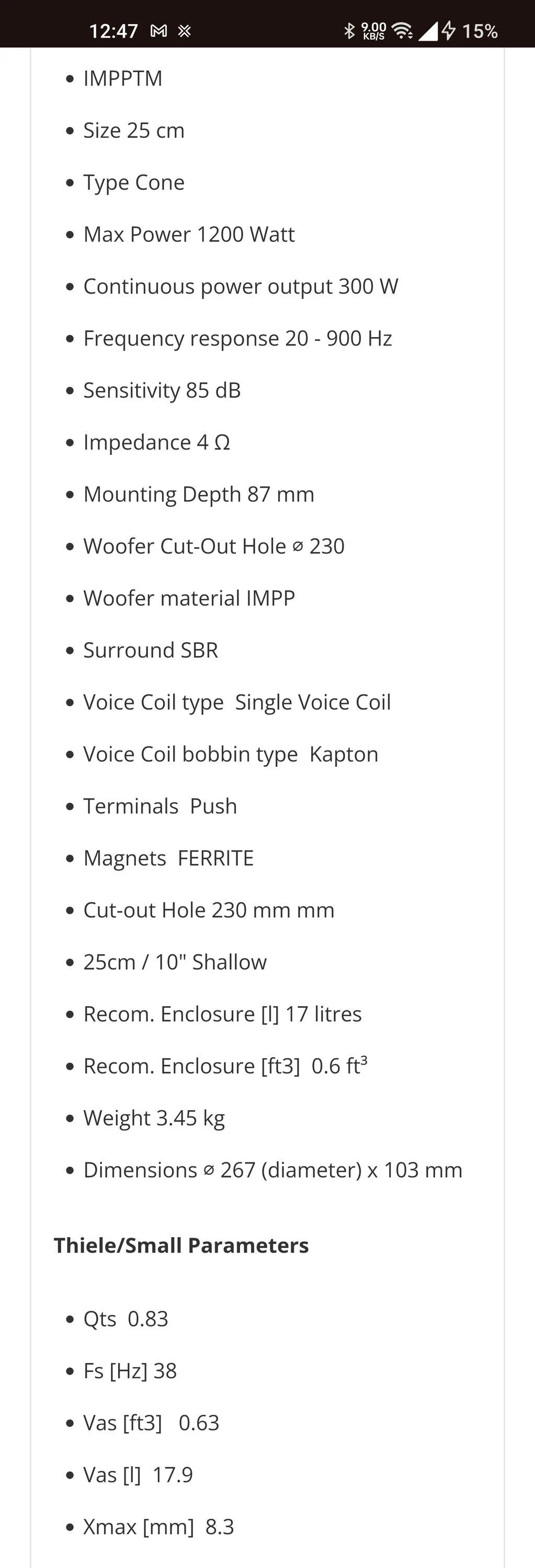

I've attached the T/S for the pioneer 10" I'd like to use. The only useful information I can understand here is that .6cuft is recommended, I have room for a 1" MDF ring to make the woofer occupy .15 cu ft meaning I have .25 cuft of effective volume.
Now how do I add the passive rad to the equation? Buy one create it and test it? If I understand this right I won't know my woofers TS without the volume of my particular enclosure?

Adding a passive rad doesn't synthetically increase the perceived volume of a sealed box. It creates a tuned box system. Even if it doesn't have any air moving through a port, the passive rad acts like a port by resonating within in a certain frequency range. It is more to boost the output, than to act like a bigger box. Overall, it is not recommended for a DIY car audo approach, as I mentioned previously this is the realm for advanced calculations by audio design engineers.
If you want to do this right (meaning good sounding bass, not "ultimate bass"), go spend some time over at https://www.diymobileaudio.com/forums/
I suggest reading there and not posting, since they will rip you alive with this kind of stuff.
