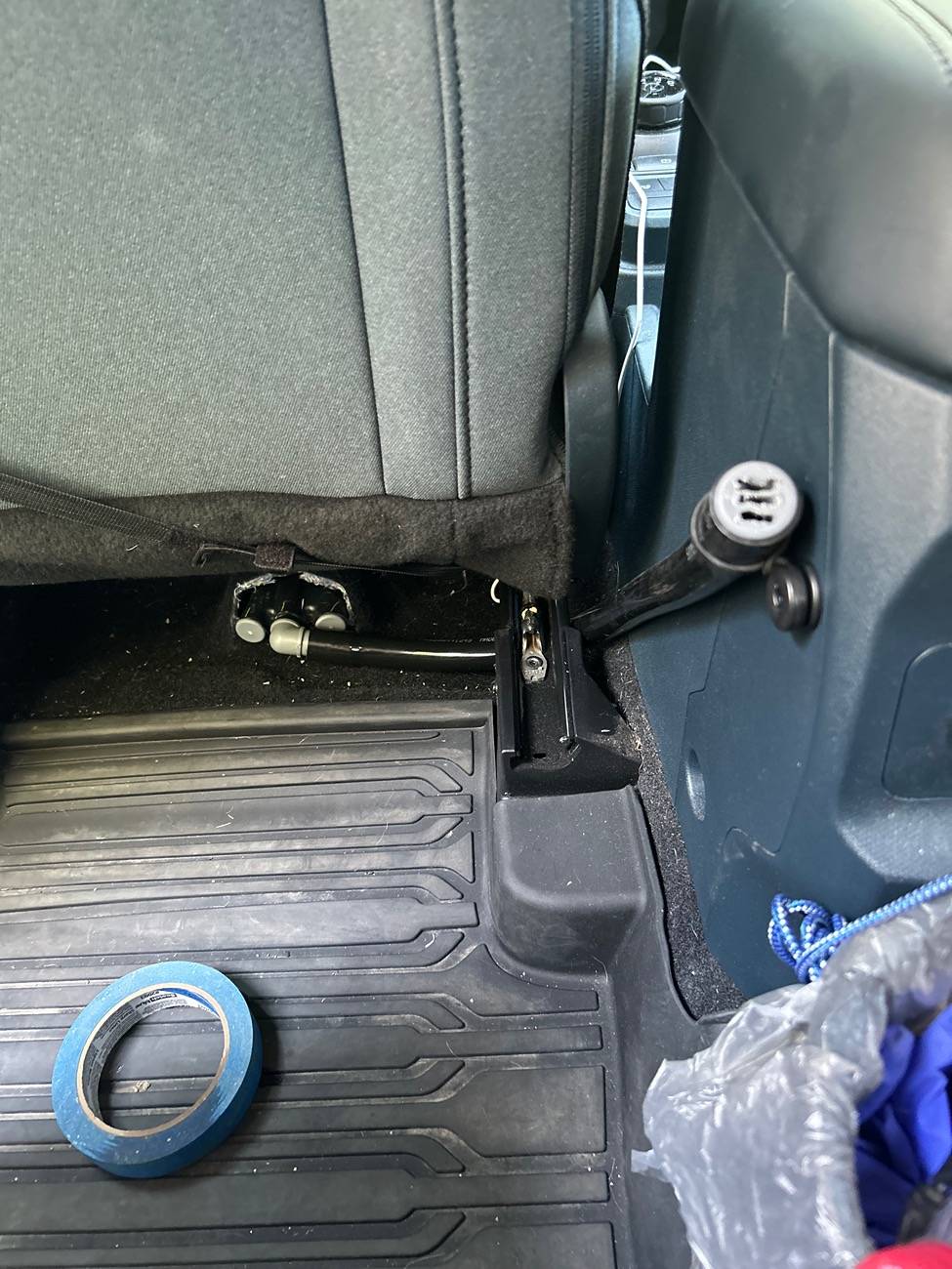

in my 22, I found the back seat HVAC was blocked by the all weather floor mats, so I plugged up part of it and connected vinyl tubing to it and routed it beside the center console to the back seat, mostly for air for the dog when she's in the back, but it helped a bit with heat also.
Ford Maverick Hybrid: winter engine temp? IMG_0482
