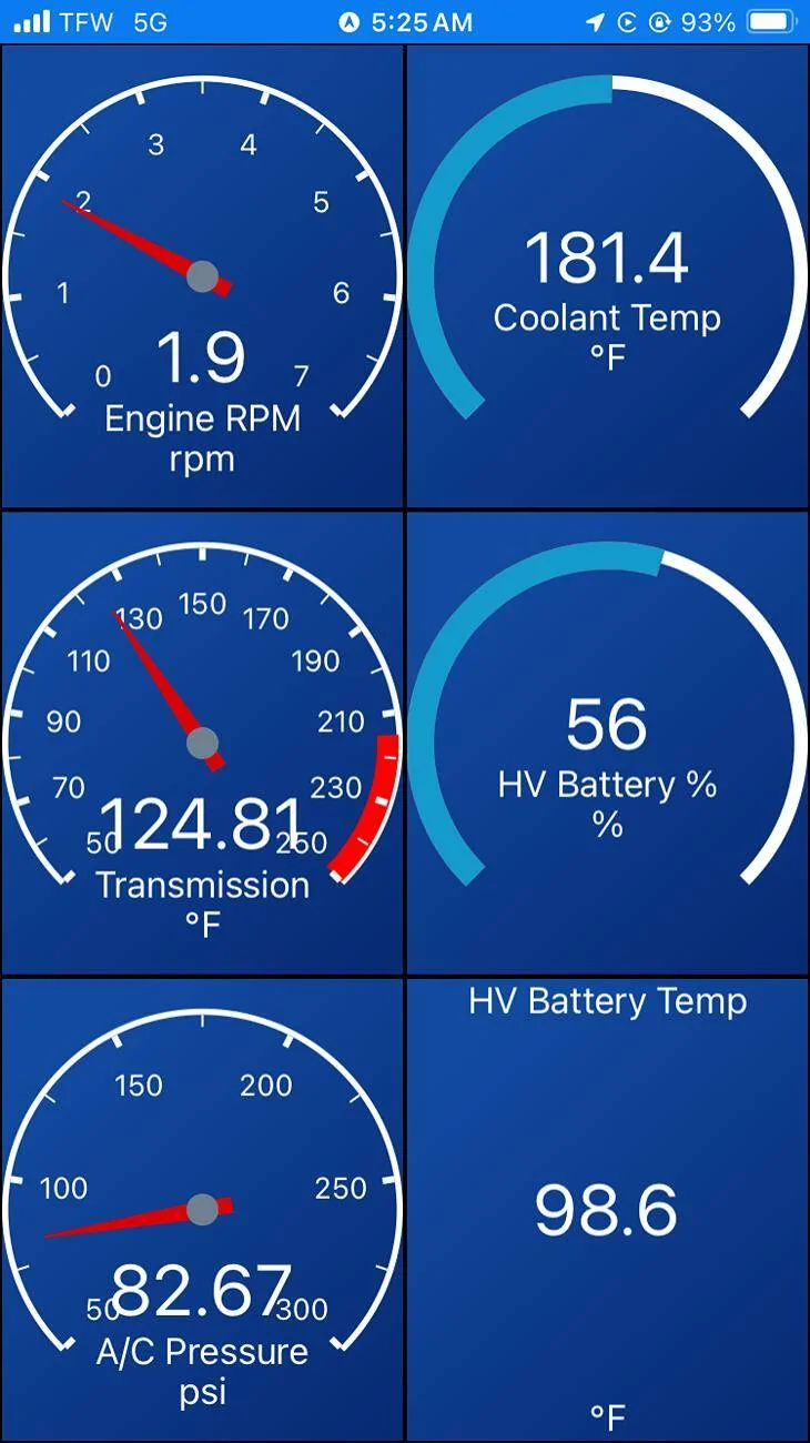

I use car scanner pro, it's $6 for lifetime use IIRC.
They have several profiles, the Maverick is one of them. I noticed the generic hybrid profile had a few things the Maverick does not and the EV profile has a few things as well.

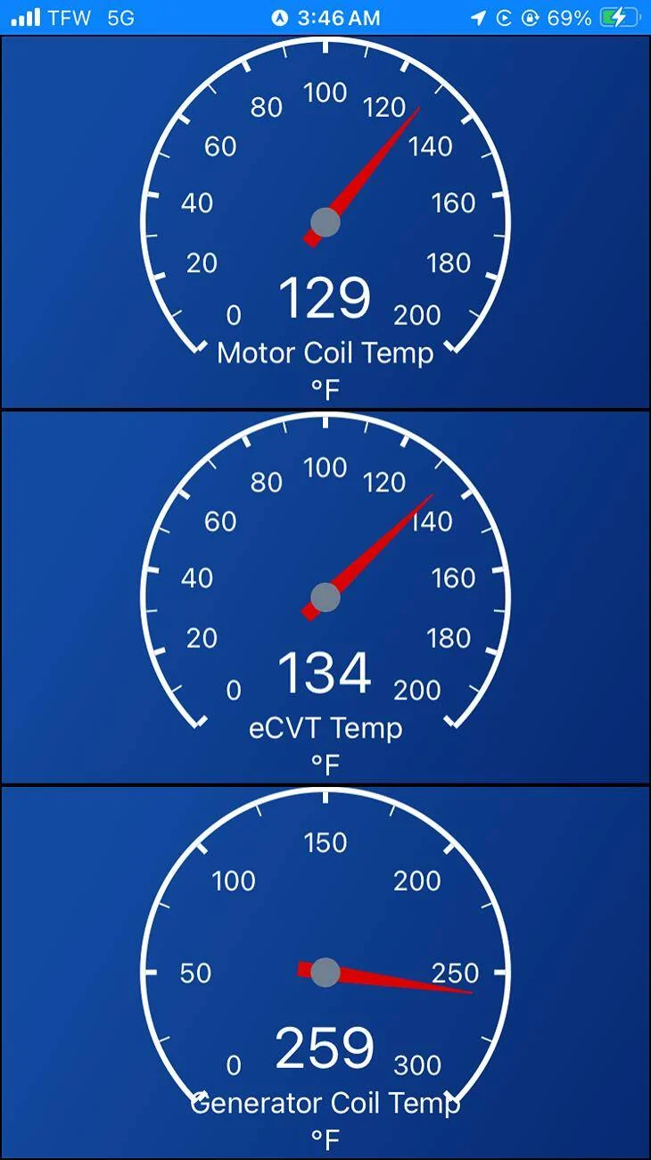

Also I don't think that generator coil temp is correct.
Ford Maverick 2025 Lariat Hybrid CVT Temp IMG_3477
Ford Maverick 2025 Lariat Hybrid CVT Temp 20250404_074636000_iOS

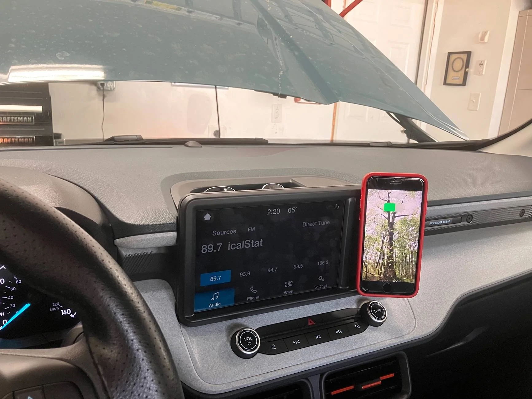

This is how I view it:
Ford Maverick 2025 Lariat Hybrid CVT Temp IMG_6262

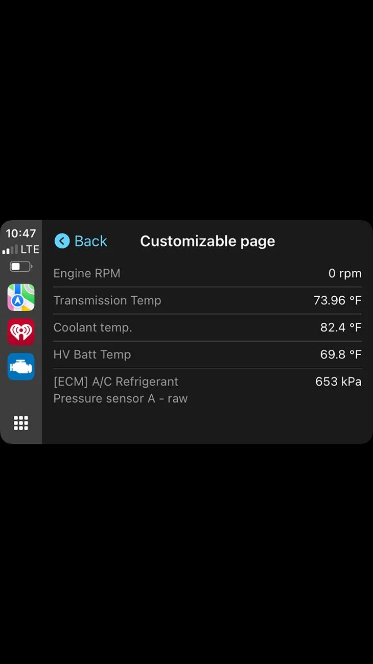

You can also monitor from within CarPlay:

@inline_five
I have seen generator coil reach 259°F but I was working it really hard... towing 3200 lbs uphill at 55 mph on a 96°F day.
At that point I backed down to 45 MPH and the generator coil dropped to 220°F.
Fear not. 285°F should be "redline".
Fun test: what do all your temperature sensors say on a cold morning? Are they all within 5 degrees of each other?
Then check again parked on a hot day.
That's my sanity check. Mine are never the same, but all within 5-6 degrees which is fair and probably normal calibration or manufacturing tolerances.

Thanks, I was playing with settings early in the AM. This was on a cool morning, level ground, 70 mph, unloaded vehicle.
So I do not think that temp was correct. I haven't had time to cross check but will like you suggest.
