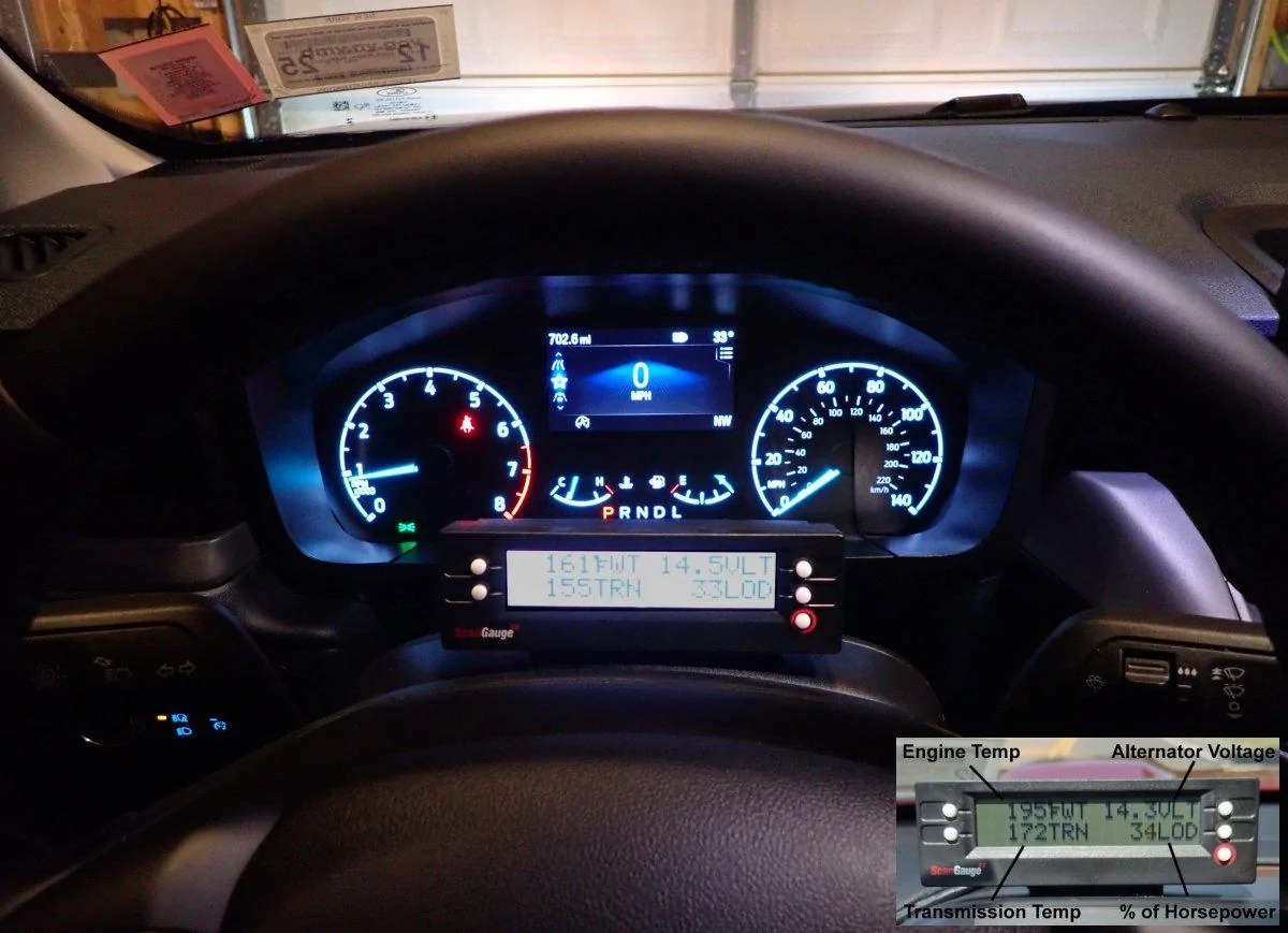

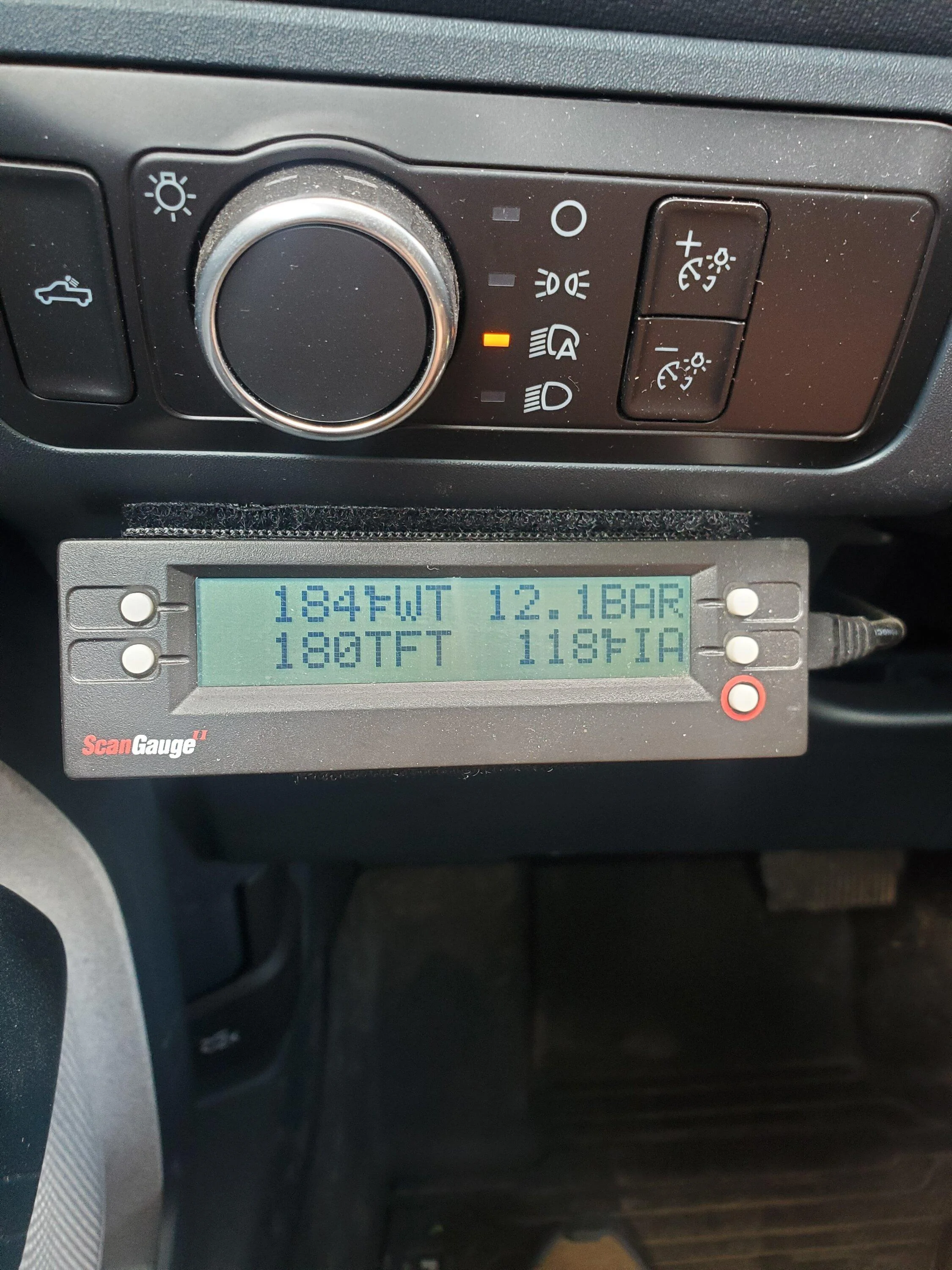

This truck (and most vehicles on the road) run with coolant temperature between 180°F and 190°F.
On a 100°F day it might hit 195 if you are going uphill unloaded. I've seen 215°F MAX and for a very brief interval while towing 3,000 lbs up 6% on a 99°F day. Most of that day it was 195 to 205.
I'm convinced the engine will not overheat in the hybrid. It just won't with proper coolant level.
Think about it. It's using 25% less gas than the Ecoboost, and naturally, makes 25% less heat while doing so.
