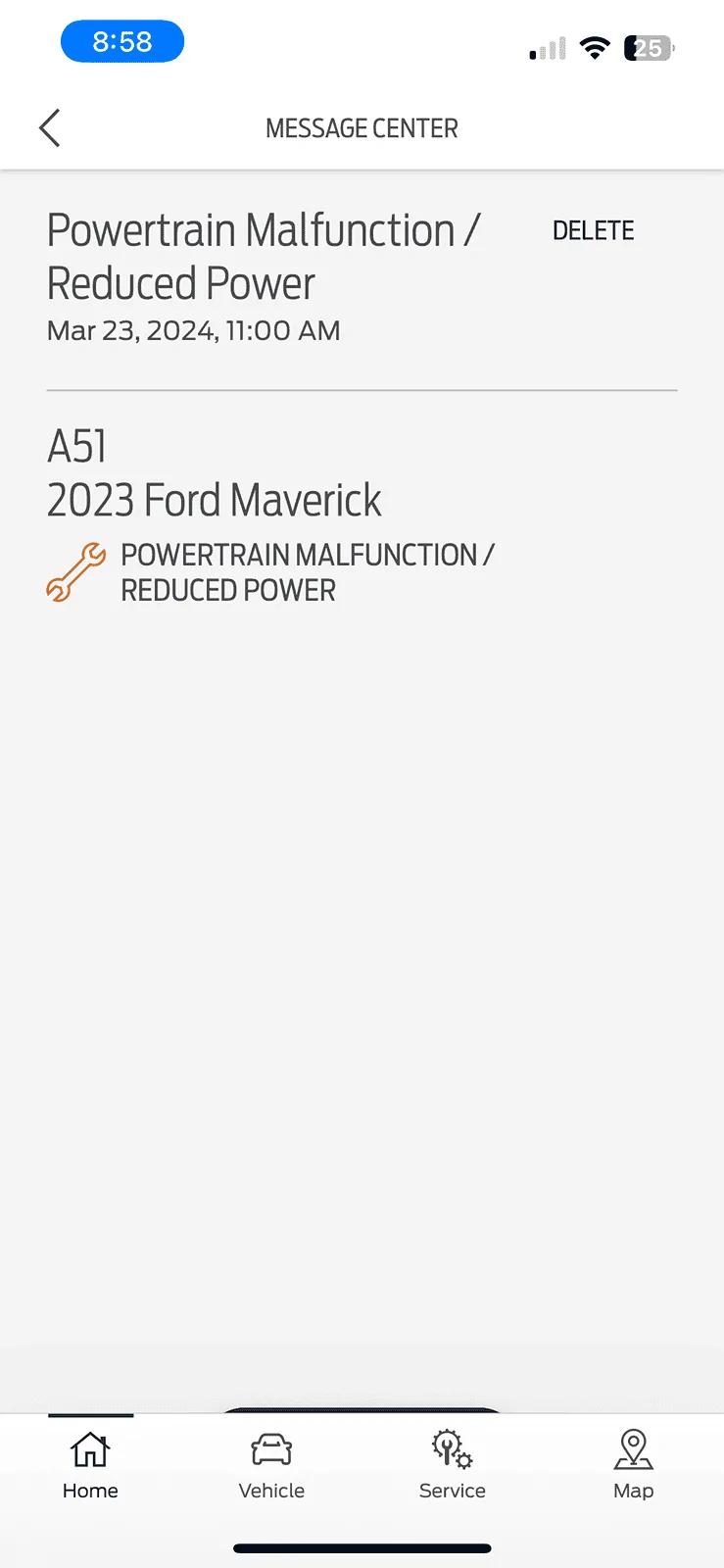

Had my 2023 for 13 months, 11k miles. First 1yr was 10k miles with zero issues. Got my 10k service done 3/1/24 where 3 recalls were applied, main culprit being the 23P18 PCM recall.
Since then my gas engine has shuddered while turning off about 5 times (never done that before 3/1/24).
On 3/23/24 the truck went into limp mode while on the highway with an engine light and Ford Pass service required message. Was able to wait a couple hours and get the truck back home (was 70 miles into a short road trip). This issue self cleared on 3/25/24.
I’m now also noticing a shake during hard acceleration that is getting worse and worse since yesterday. The truck is going back to Ford this Friday and I have to rent something for my kid’s spring break trip to FL. No loaners anywhere but I can get $60 per day rental reimbursed but I must rent a Ford.
I hate to think about selling it but I've owned so many power train/driver-train trouble free new and well used vehicles over the last 25 years. I really hope they can get my Maverick back to normal.
