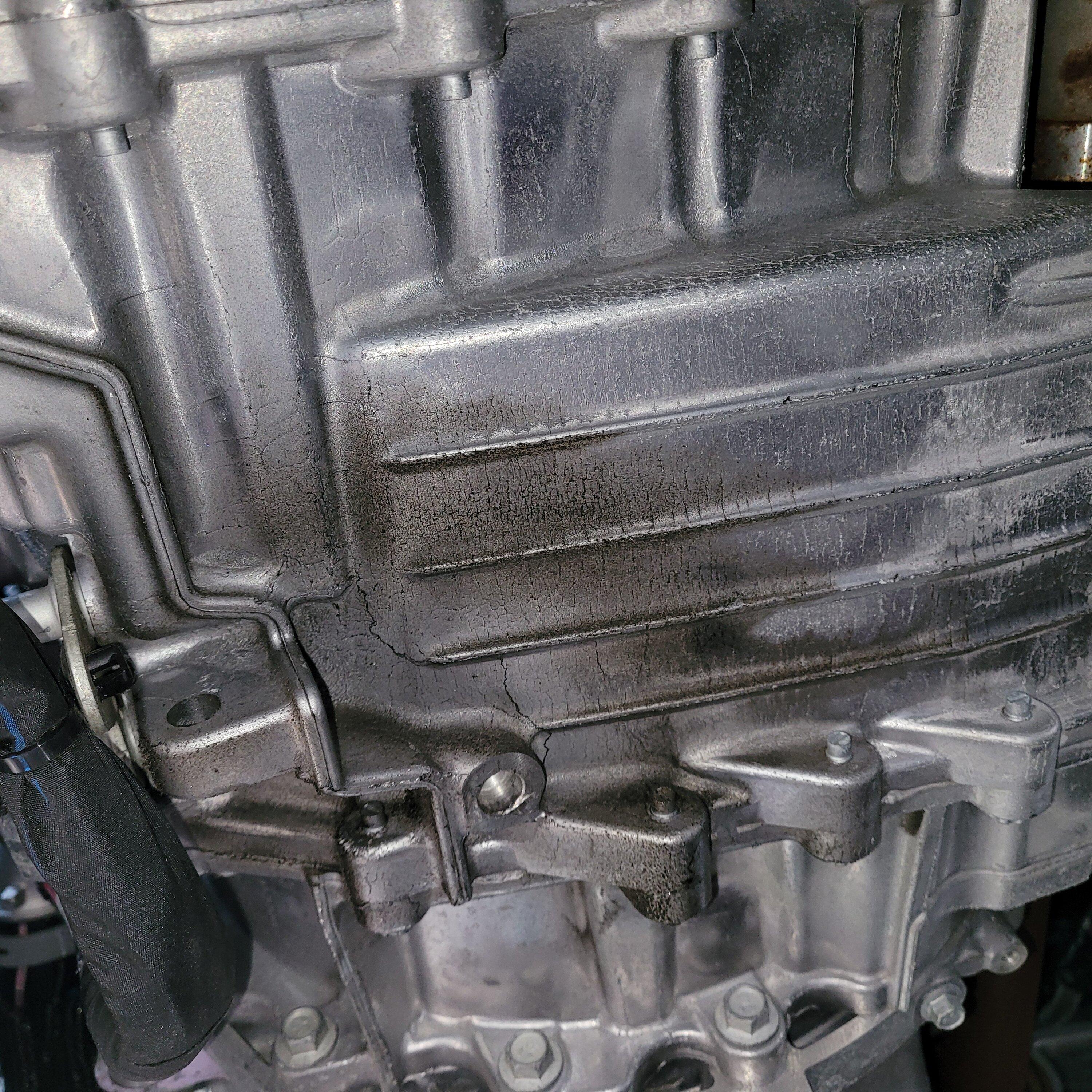

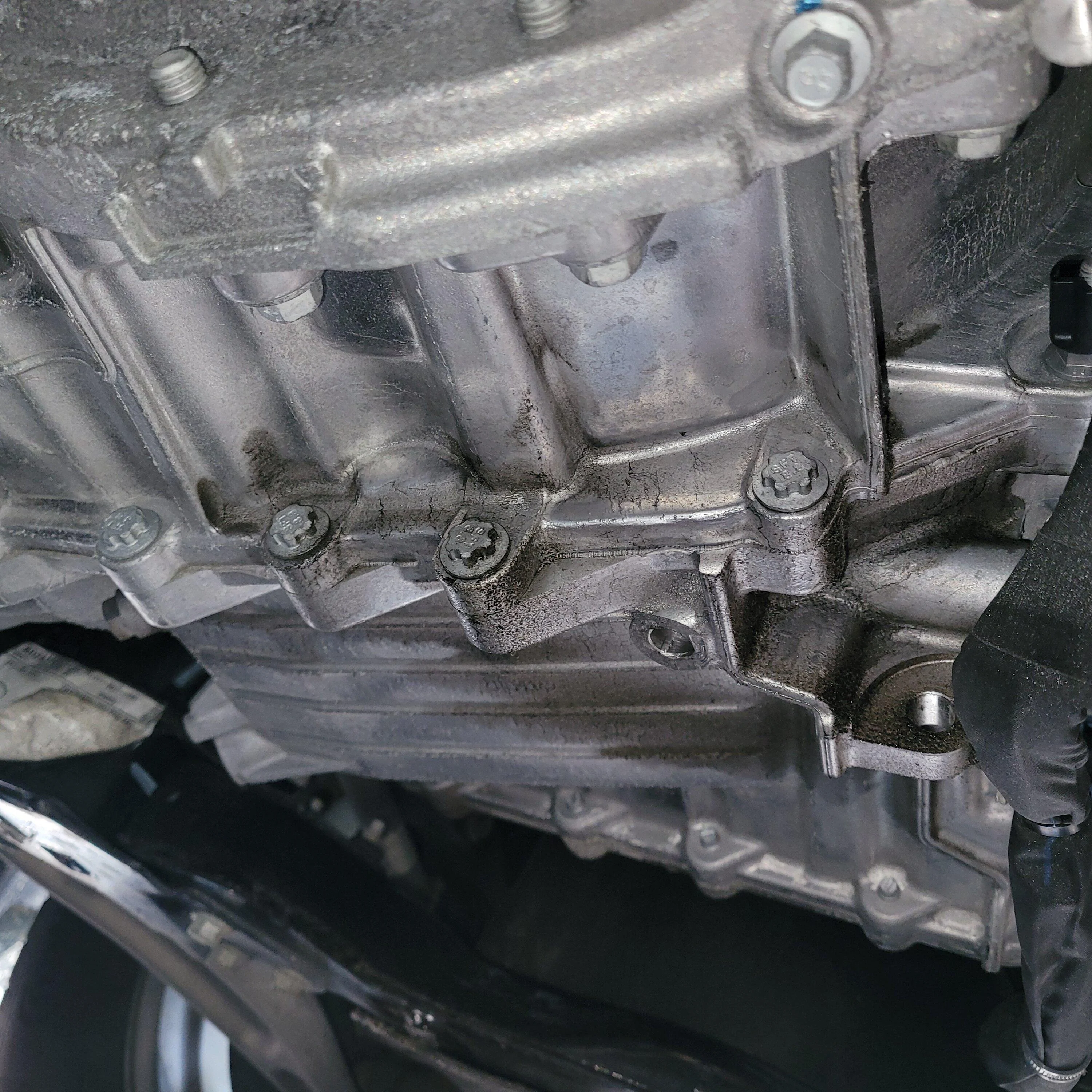

Did an oil change a couple of days ago at 67k miles. 10k miles since last oil change but oil life monitor still showed 25%.
I'm seeing oily wet area where the transmission and engine meet. It may just be bolts needing tightening but the bolts require a special socket. No big deal or should I get it taken care of?
Usually when it’s where the motor and transmission meet, it’s a rear main seal.

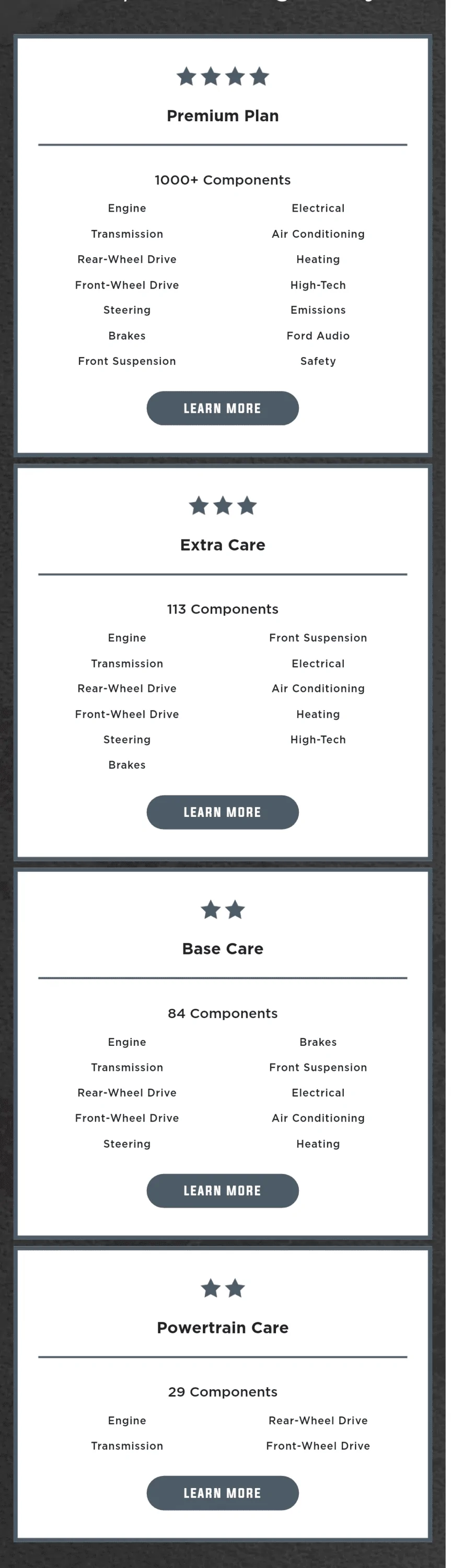

It's at the dealer today and they just called me. It's the transmission cooler that's leaking and IT'S NOT COVERED UNDER THE ESP!!! Really disappointed. What does the FORD ESP cover? I got the 5Yrs/150000.
I was quoted around $600. I should have looked more. Maybe all it needs is the bolt tightened. It currently has 84k miles right now. They are also doing the second fire hazard recall.

Exactly which ESP did you purchase? There are 4 different levels of coverage. I'd buy one but I'm afraid that they will cleverly exclude all the stuff that's likely to go wrong.

I have the Mav back but I just sent a message to my service advisor. It appears to me that labor and parts were billed twice.
Anyway, they replaced the SPECIAL SEAL, RING, and TRANSMISSION FLUID that drained when they removed the lines.
I didn't know there were four different levels. It's from GRANGER MOTORS and did not include any type of maintenance.

So the trans cooler sealing rings were leaking and not the trans cooler itself. Keep us updated on the fire hazard recall repair.
