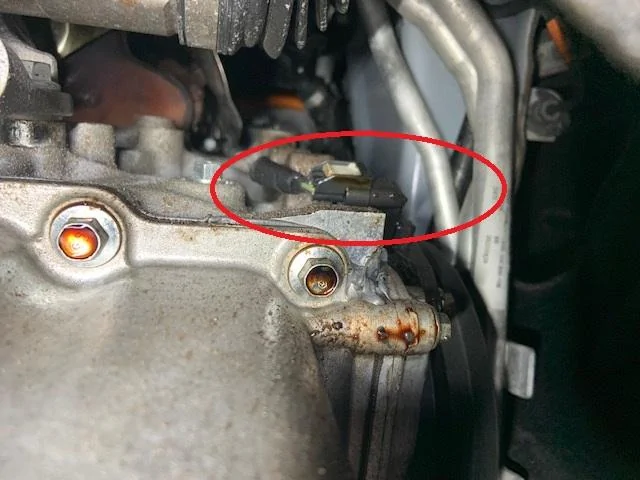

I discovered an oil leak during a recent oil change at 24k kms.
I'd say it was coming from the oil pan gasket looking at the hack job of applying sealant (have a look at the goop on the corner in the pic) but it's coming from somewhere higher because of the oil on the connector circled in red. It's soaking the fabric cover and I'm surprised (or maybe not surprised) the dealership never mentioned it when they covered the TSB for the venting issue and drilled a bunch of holes in the cover last week.
This photo is just above the oil drain plug on the front side of the engine near the harmonic balancer.
Anybody ever see this before?

I have the same exact leak on my Hybrid ☹👎 Noticed it also when I change my oil . 9000 miles also has oil on pan and the pan that had the holes drilled in it . Have told my dealer but stopped him from doing anything we need to stay in touch.
