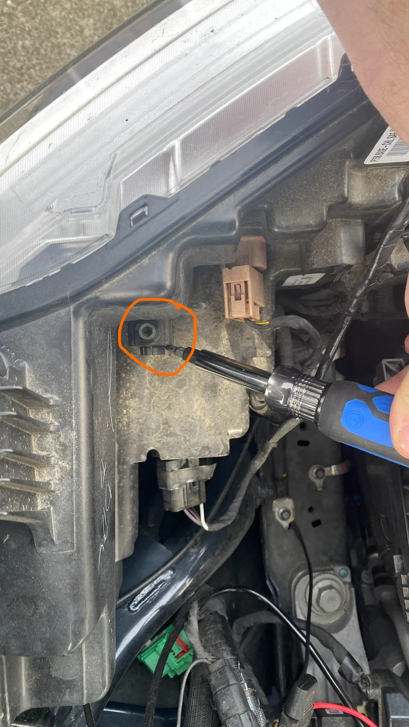

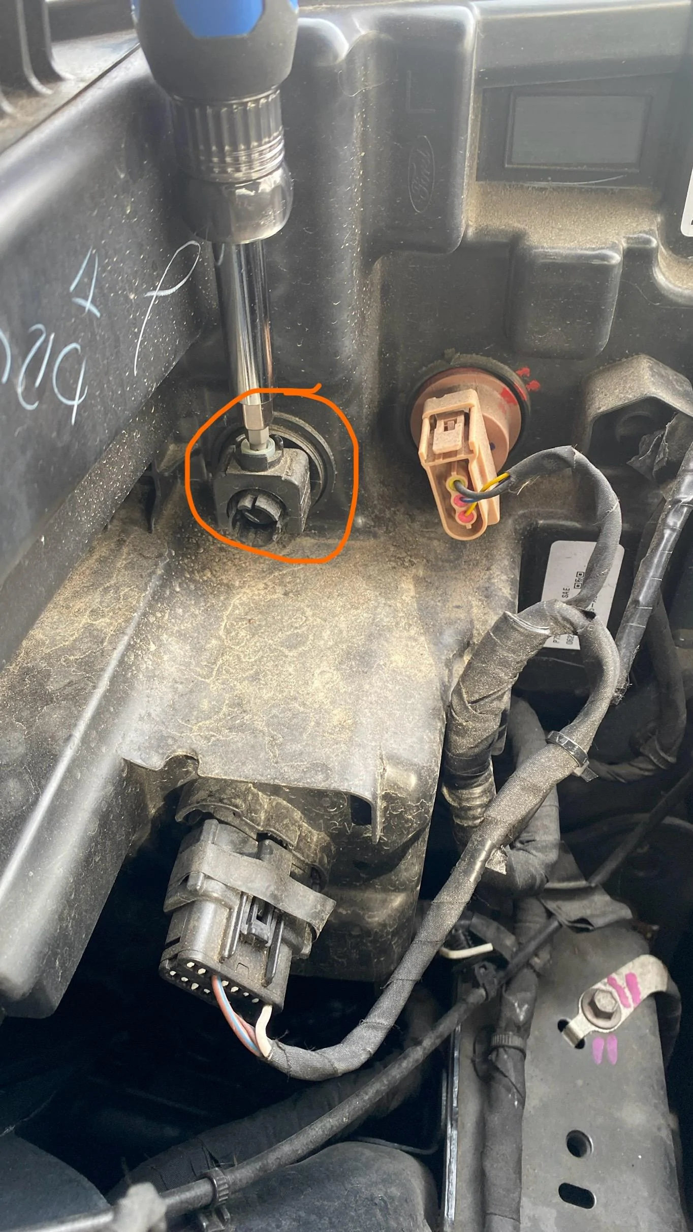

But had pre-arranged hotel to reach. The first time I drove after dark, I quickly realized my "projector" headlamps were pointing at the sky. One hour from first hotel I dealt with it. At hotel, got out the manual, and found it is:
REALLY FAST AND EASY TO ADJUST YOUR HEADLAMP BEAM HEIGHT.
I wish all Mother Truckers would do this. A full 20% of drivers on the roads have "projector" beams pointed too high.
I had to rotate the screw EIGHT FULL REVOLUTIONS which I think was all the way down. The screw got stiff and I didn't want to force it any more. Was near perfect like this.
Side note, after 1.5 year of ownership I fully believe mine were misaligned from the factory. For 1.5 year I have believed my "high beams" didn't do anything. Because they didn't. Turns out I was driving with "high beams" all the time.
This is my first vehicle with projector lamps. So I thought that's just how they were. What a wonderful difference now. Now I don't get blinded by reflector signs. It took a heavy load for me to notice this important FACTORY MIS ALIGNMENT issue.
UPDATE:
After unloading, I then turned the screws 4 revolutions back UP.
THIS SEEMS ABOUT RIGHT.
AND WHAT A DIFFERENCE!
For the first time in 1.5 years my low and high beams work as they should.

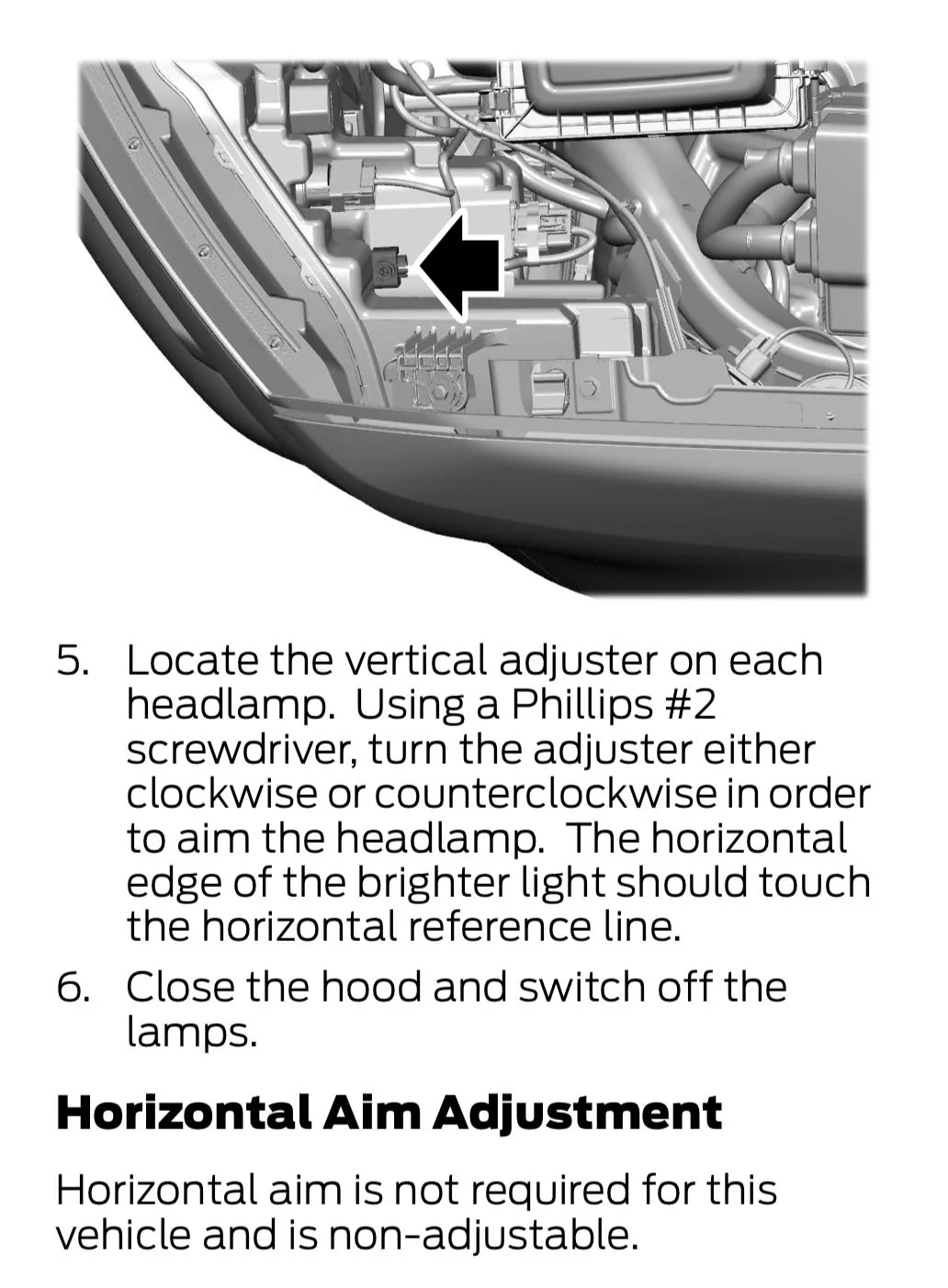

Page: 320-321 of 2022 manual:
TAKES ONLY 1 MINUTE PER SIDE!
SO PLEASE PLEASE PLEASE DO THIS!

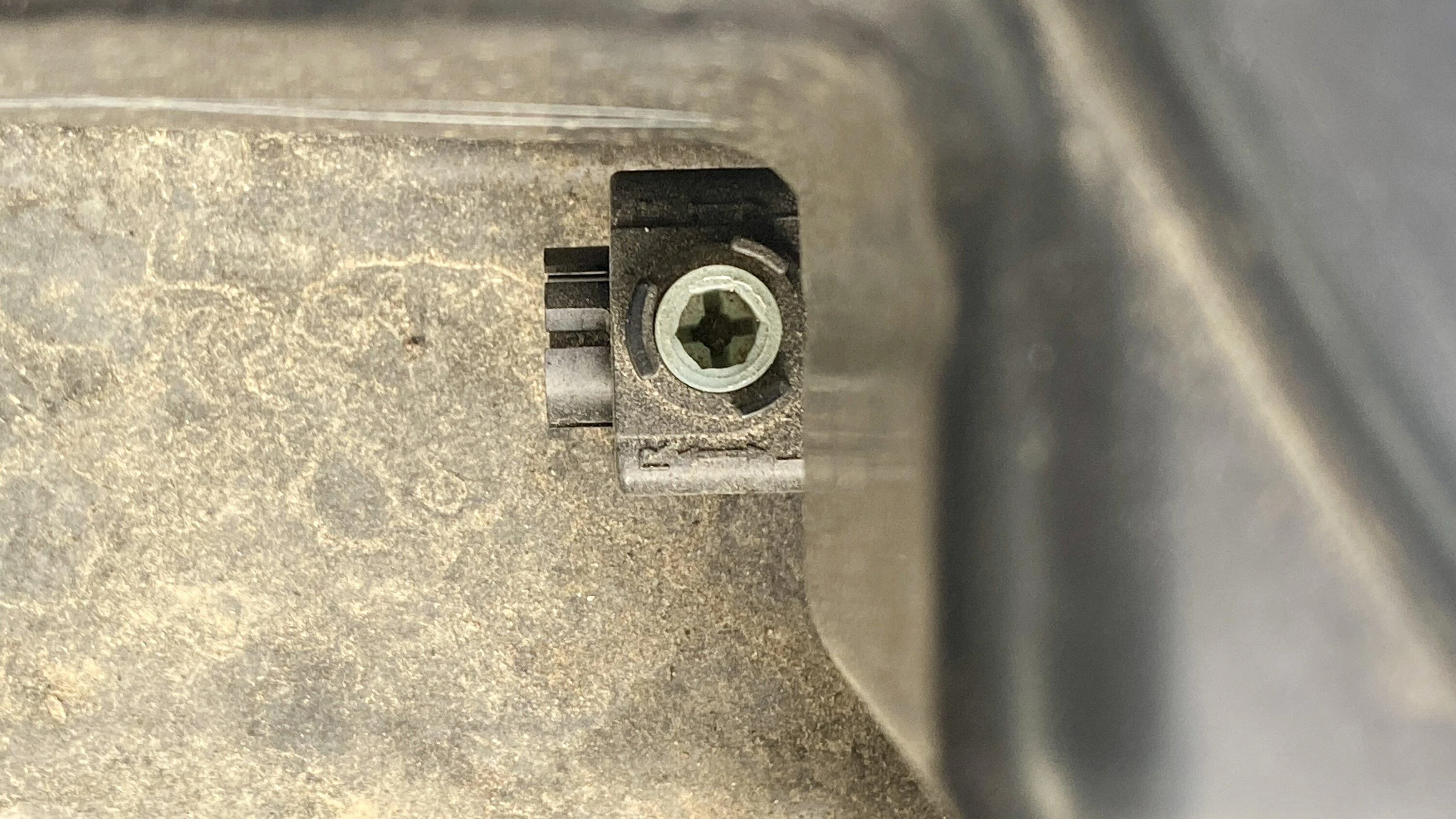

Phillips or a 6-point star adjuster? Looks like a six point.
Edit: I meant to say a hex (Allen wrench). The stars are the Torx type, sorry.
First Sergeant
Jan 2, 2024
836
1,056
Fruitland Idaho
Well, heck! As they say in the NFL, "After further review" looks like a hex on the top portion, then down below that looks like a Phillips? Maybe us either one, not sure.

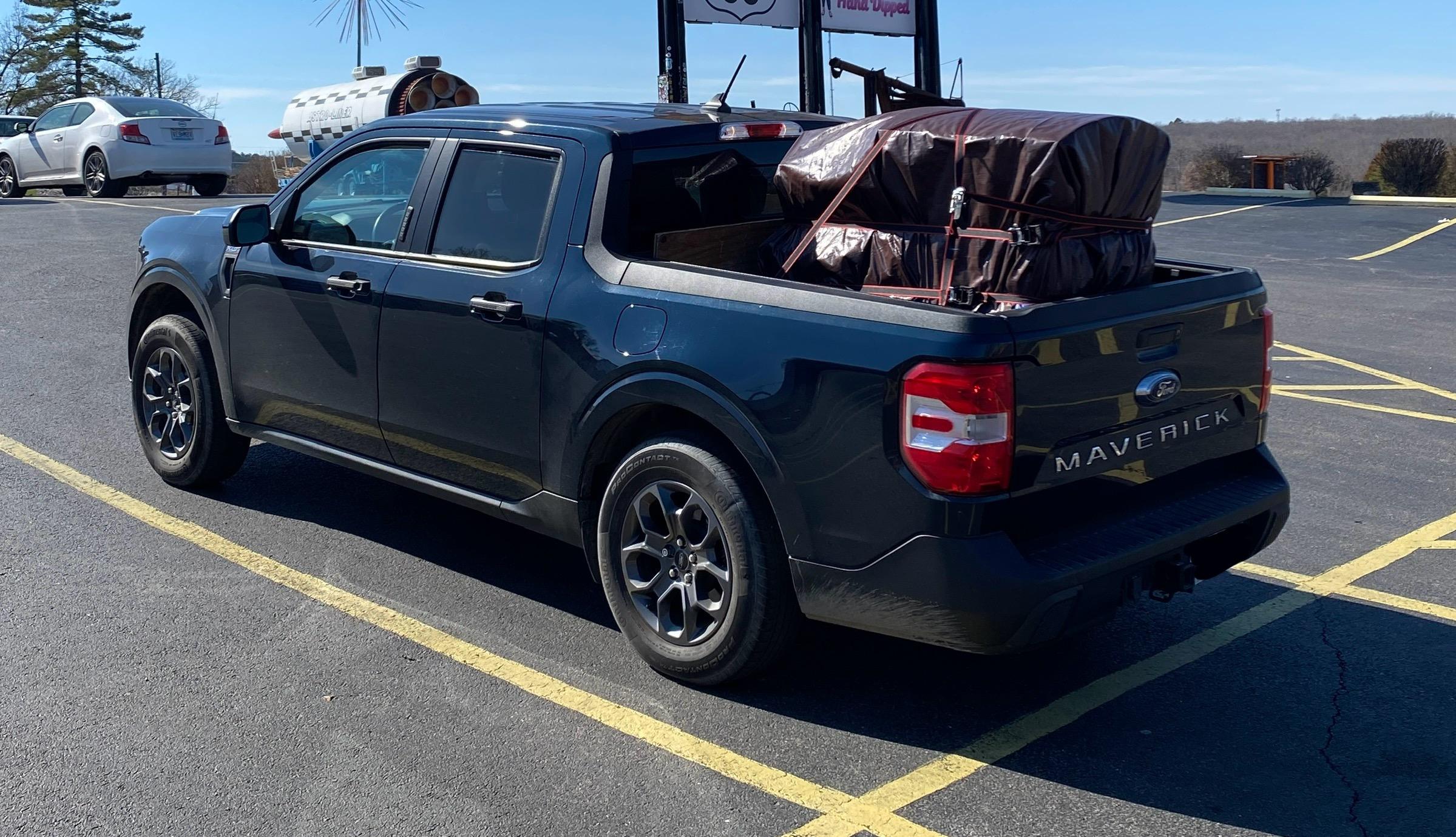

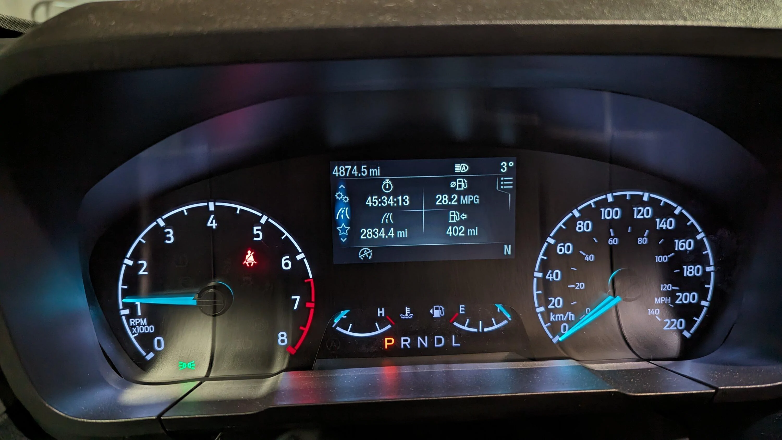

My trip last week, an extra 100lbs in the box for the trip home. Most of the mileage on interstates likely averaging 75mph. Kawartha Lakes Ontario Canada to Daytona beach and back.
Just realized the clock runs on this trip even when the truck isn't moving.

It's phillips.
Just went out to shop and checked it. We can use either one. It is also a 6mm hex (Allen wrench) Nice to have options!
