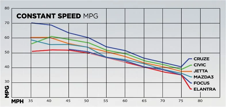

Hybrids will have the most extreme performance difference in stop and go traffic or places where there's a lot of idling, thanks to regenerative braking and great stop-start functionality with electric assist.
Steady state cruising, even at lower speeds, is where the difference won't be as extreme. Traditional ICE and especially small ICE with turbos like cruising at reasonably steady RPMs. For example, our turbo little Fiat was rated at only 33mpg highway, but if you went between 35mph to 55mph you could easily get mid 40s and that's just because of less drag. Most vehicles that aren't built for super aerodynamics will max out on fuel economy at a mere 40mph.
Ford Maverick Hybrid efficiency when speeding up to highway speed and slowing down going through small towns? MT_constant-speed-chart
So your hybrid Maverick will get great fuel economy in your use case, but the ecoboost may exceed its EPA rating as well in that scenario so the delta won't be as huge as when you have lots of traffic with speed and surge and speed and surge or stop and go with red lights and stop signs, where the hybrid would blow the ecoboost away.
