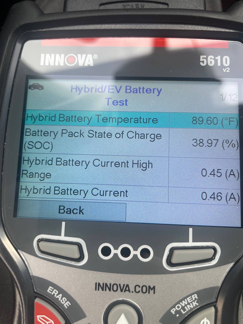

Don't suppose you also graphed SOC PID for these temps? Lower SOC's (under 60/70%) would also allow somewhat higher operating temps without significant cycle life penalties.
I assume there is also a pump PID, either in percent or current draw, or at minimum on/off ?

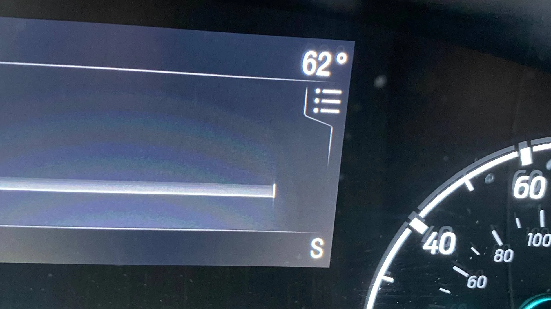

ON A RECENT DRIVE HOME I did something unusual for this ~53 MPG guy. I put it in Sport and pressed "L" at the same time. Jackrabbit starts. Maximum regen. City.
62°F day

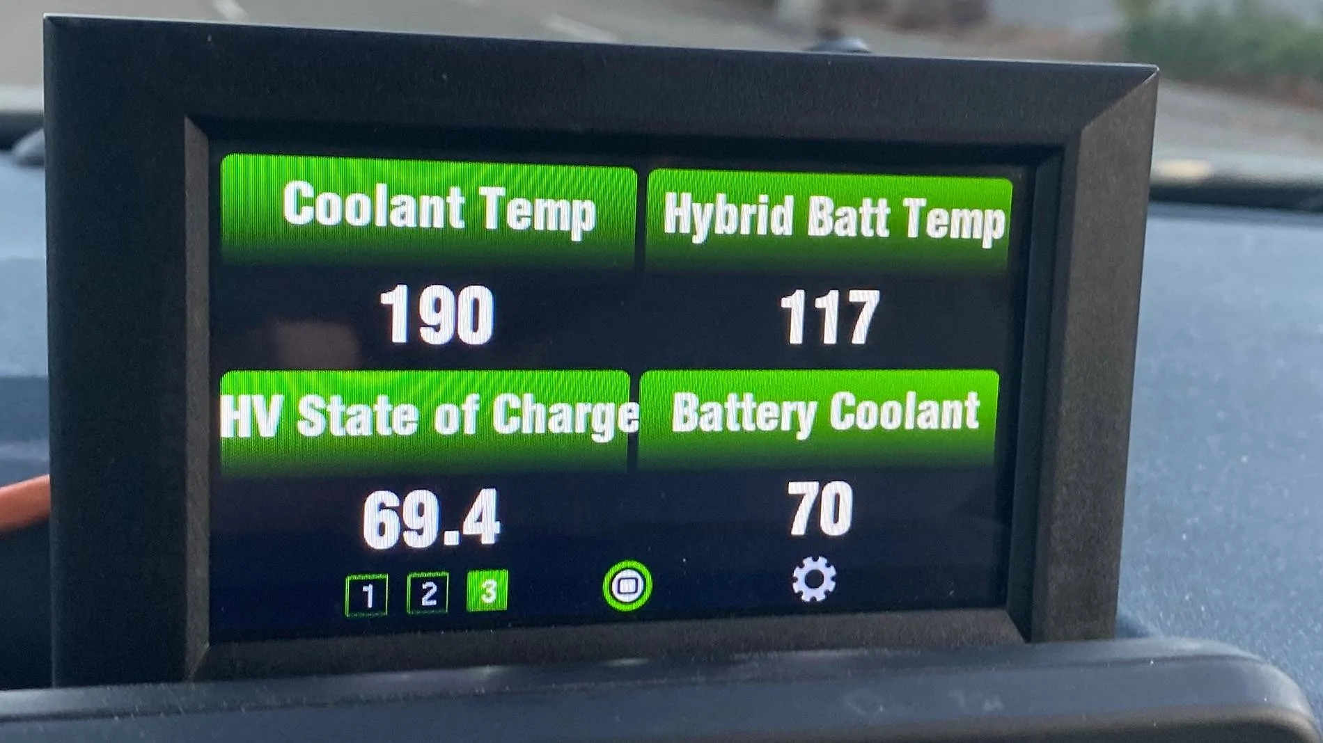

HV battery Temp vs Battery Coolant Temp
°F. °F
94. 68
96. 68
99. 68
100. 68
102. 68
104. 75
106. 77
108. 77
111. 75
113. 72
115. 72
115. 72
115. 70
117. 70
115. 70
113. 70
111. 70
108. 72
104. 79
102. 79
102. 81
99. 79

Up to 102°F I infer the coolant pump is not pumping.
104°F to 111°F I infer the coolant pump is pumping to the battery radiator and return.
111°F and above I infer the coolant pump is getting help from the freon circuit OR the pump sped up to about double speed.
On the cool down, last few data points I was parked in my driveway with hood open. Right at 102°F internal battery temperature I could hear a circulation pump turn off.
