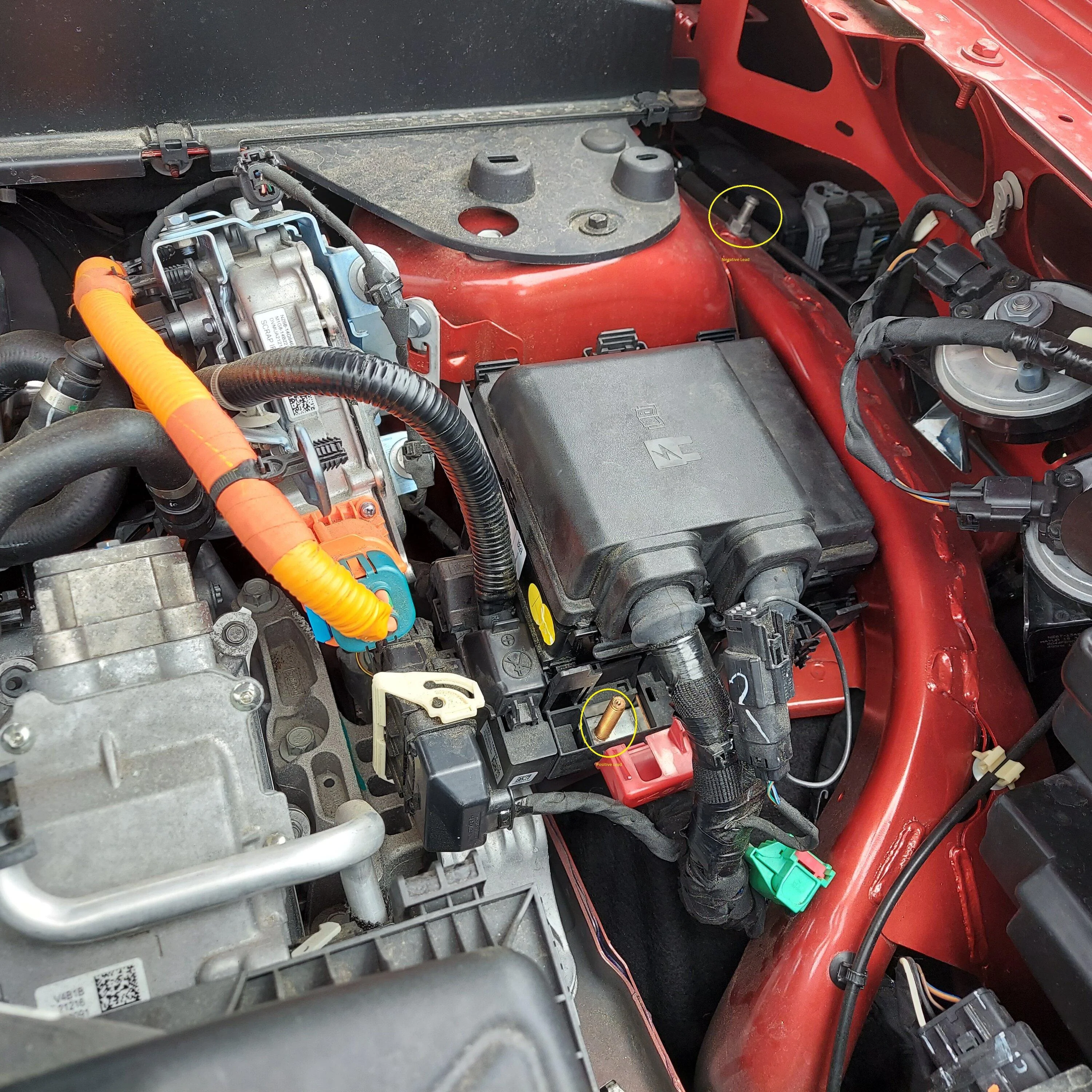

My battery was 0 vdc when I checked it after it died. You can charge it here, but it will not jump-start the truck from here. You must do that under the hood.
VAMavOwner
Jason
Jul 6, 2022
Moyock, NC
2022 Ford Maverick
Having a hybrid Mav with 1,200 miles on it, I too am concerned about a possible breakdown. Taking the Mav on vacation tomorrow. As this is my first hybrid vehicle- for clarity purposes, if I do encounter a loss of power, do I jump the hybrid battery underneath the back seat?
Sorry for what might seem like a silly question.....
I figured out how to jump my truck today. You connect the positive to the red-covered lead in the engine compartment under the fuse box and the ground pin up and to the right above the driver's side tire (depicted in the image below).
Ford Maverick Hybrid battery went dead jumplocationsunderhood
I used a 12vdc jump box and it started right up. This does not charge the battery - only allows the electronics to come on and your truck to start and run. Once I shut mine off, it died again. There apparently is a cable connection issue where the positive battery cable goes into the fuse box that is messing up the connection from the 12v battery.
