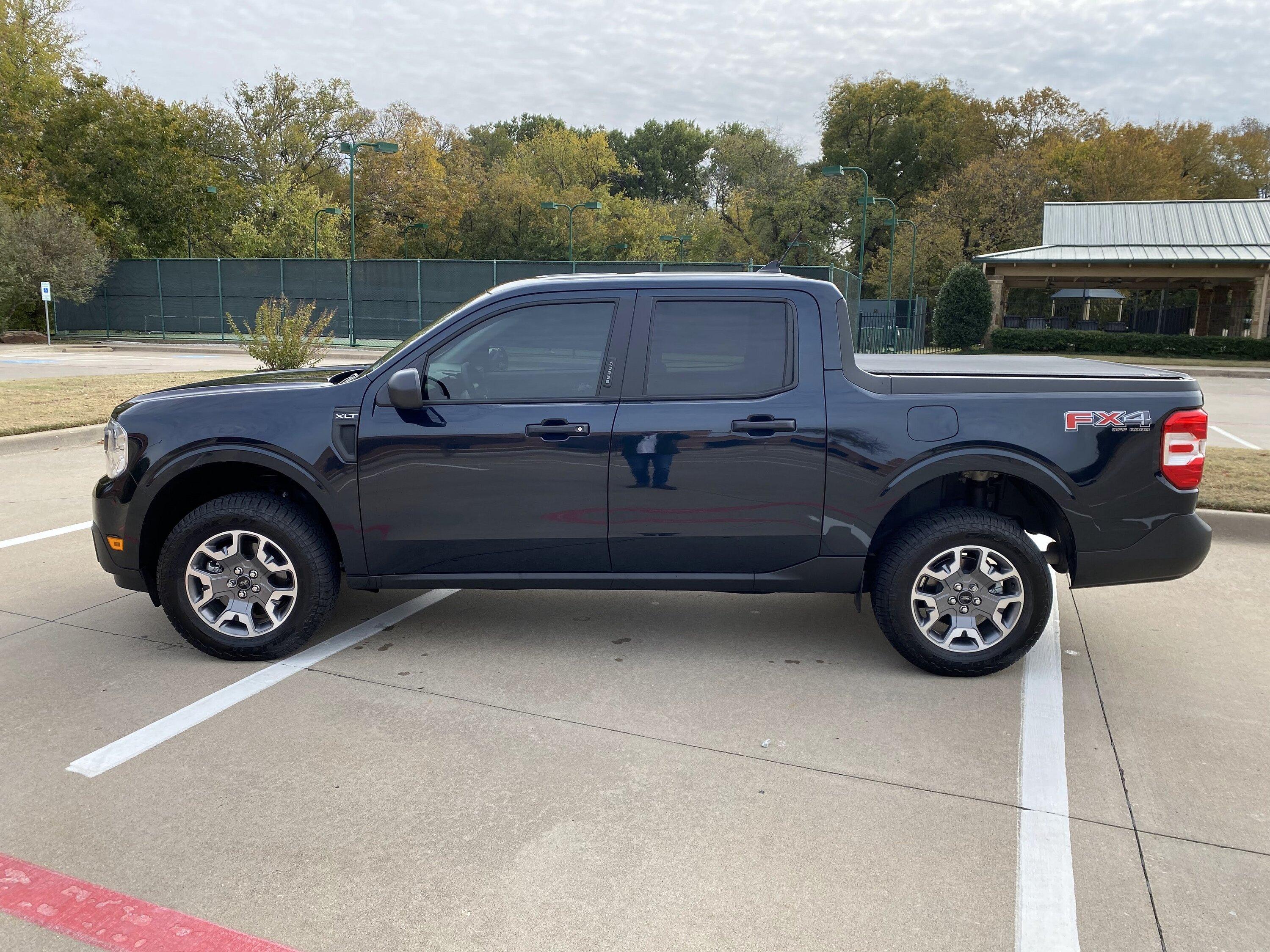

I finally installed my lift. After researching several and considering the comments in this thread and how great your truck looked, I installed the 1.5" HRG kit. I love it. Ride is the same and it aligned easily. Thank you for sharing your experience with HRG.
