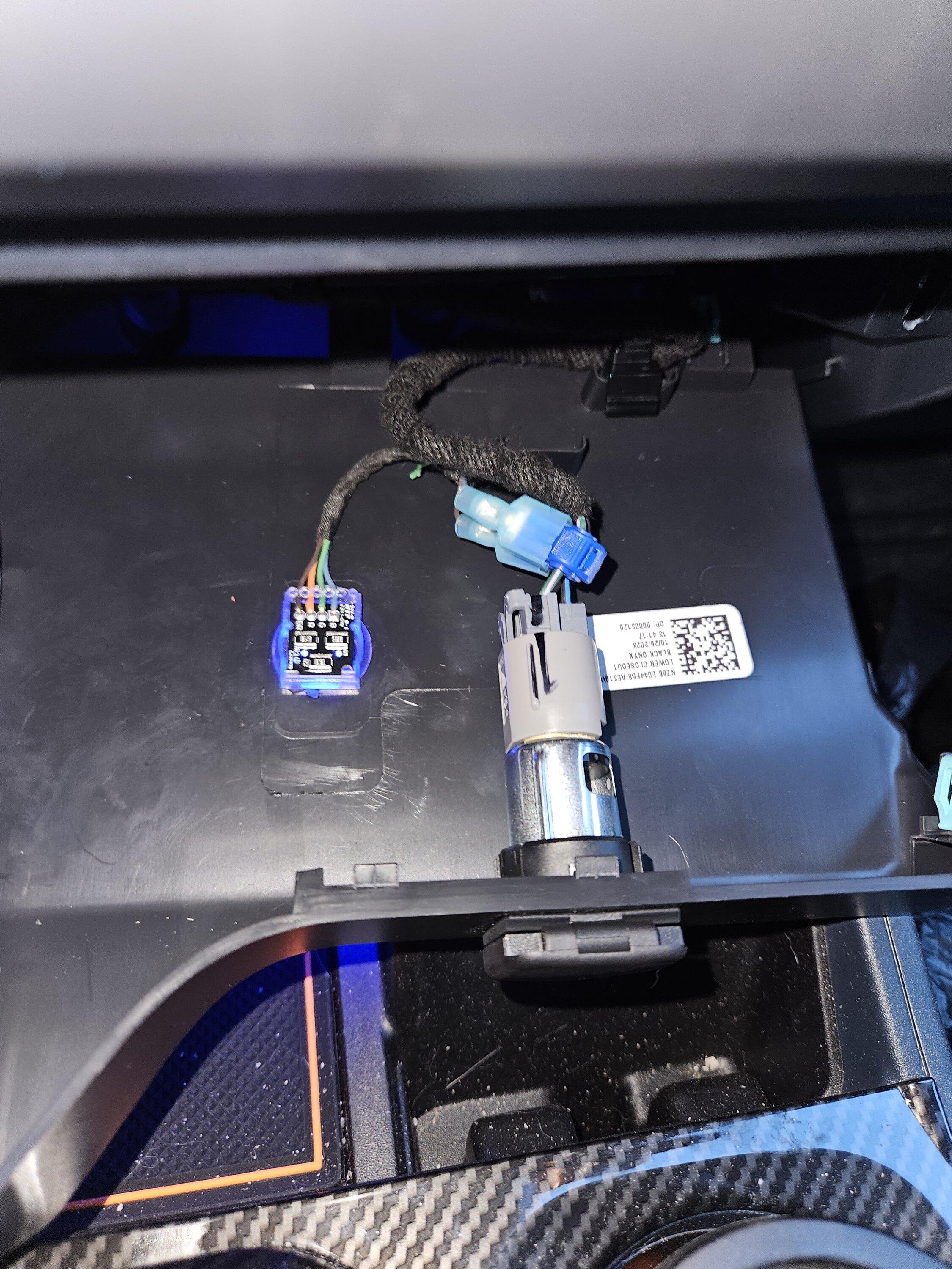

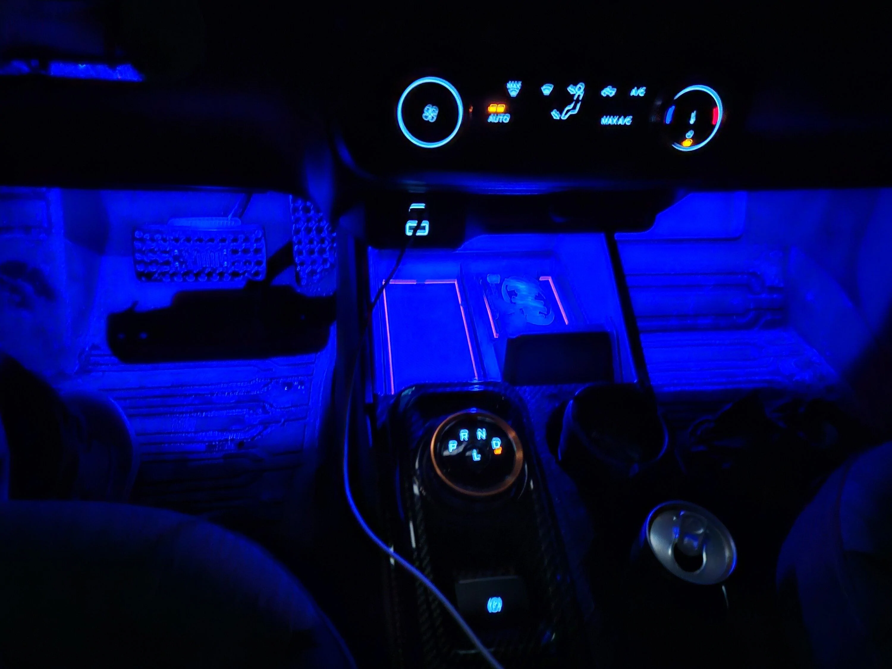

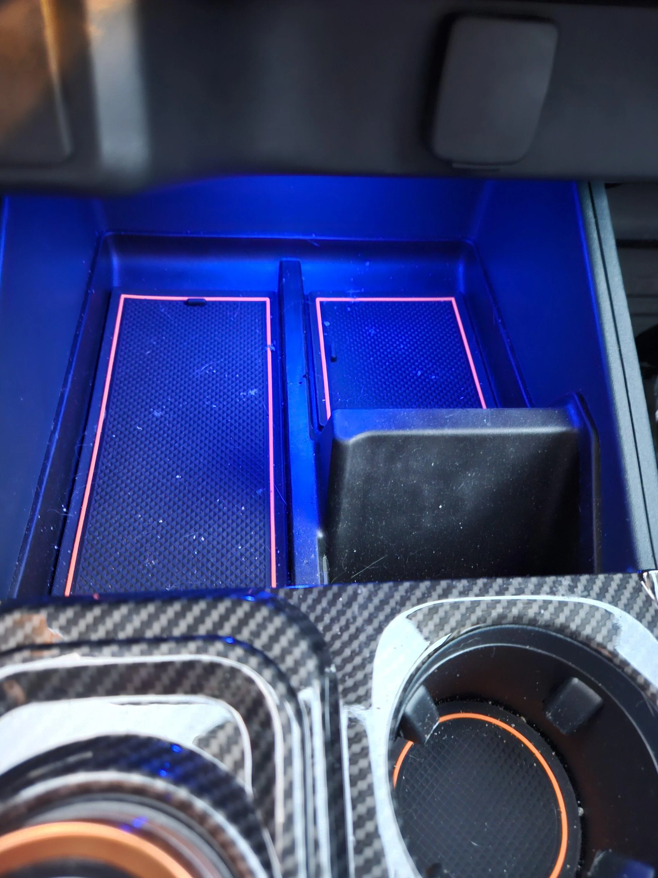

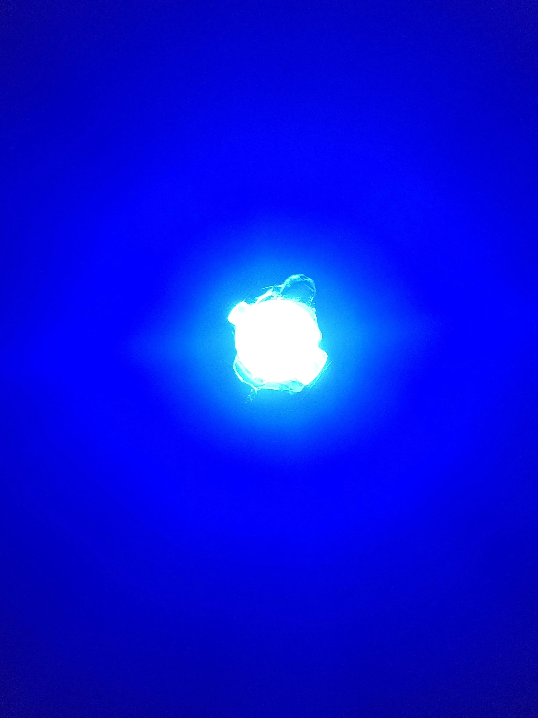

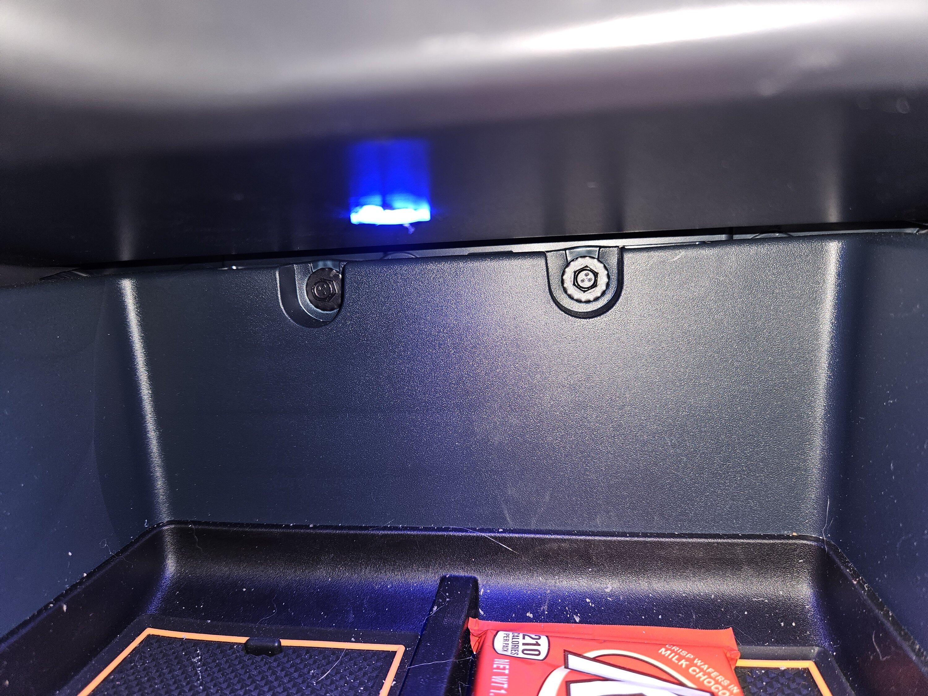

I added my own from a wrecked last gen mustang super easy..2 wires..a ground and power..there are 3 different wires for power..one for red,blue and green..what color you get depends on what wire you hook up
