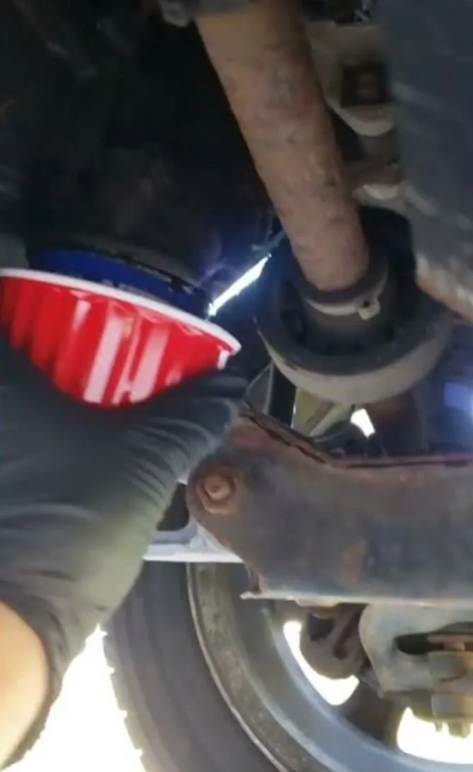

Changed my oil yesterday with 498.5 miles on the odometer. Generally I do this at 1k miles for new vehicles but I decided to it now because I want to drive it a little harder than I have been and I have a potential trip to NC this week and yesterday was my window to do it.
As @Rivers90 pointed out - everything was straight forward. The 13mm bolts holding the skid plate on were difficult to get out and I wondered if they weren't cross threaded from the factory but they all went back in just fine.
I found the drain plug was probably not torqued to 20 ft/lbs and the oil filter was tight as can be.
Once loosened - I used a solo cup to remove the filter and the small drizzle after it did not hit the front plastic fascia.

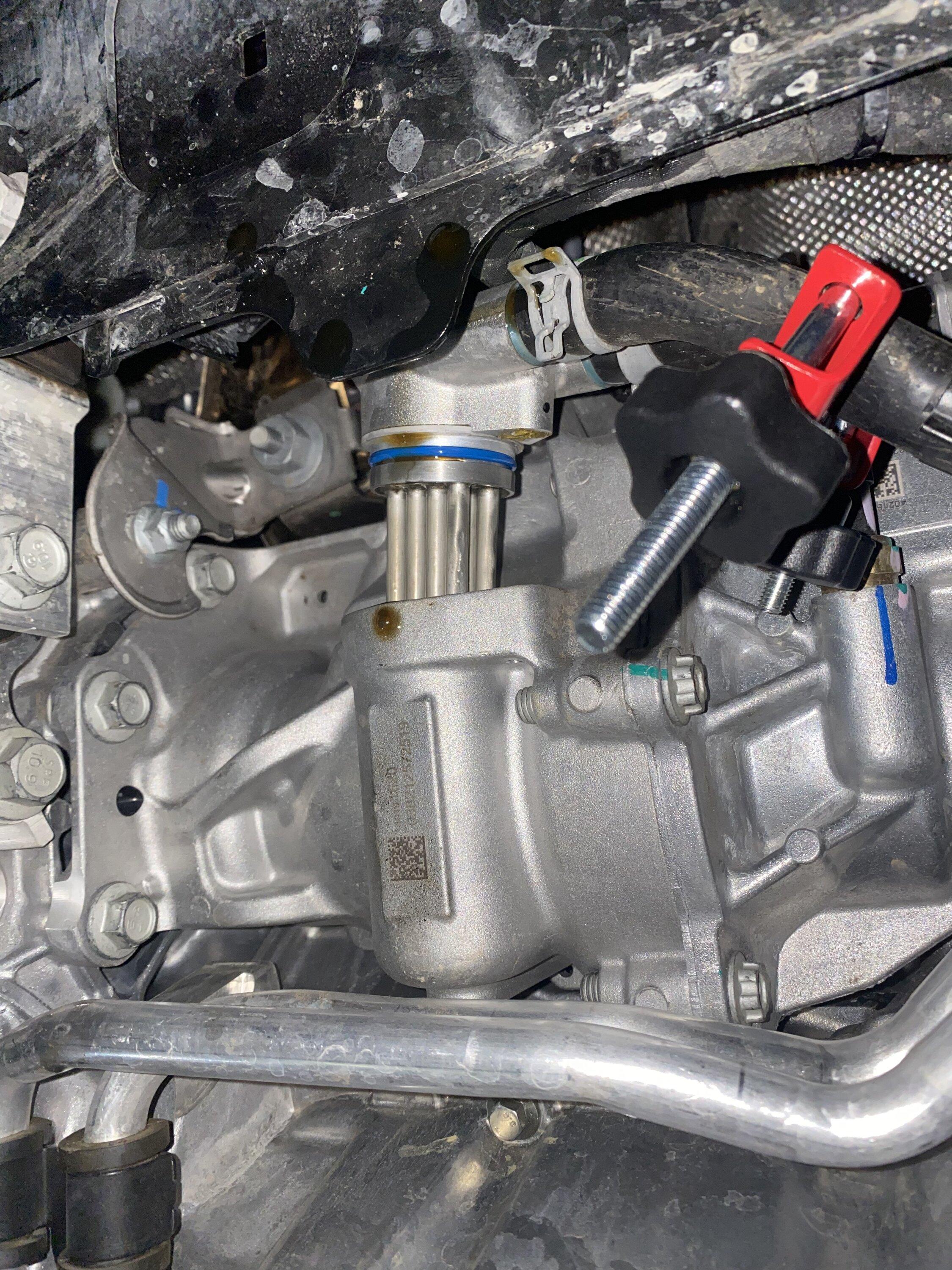

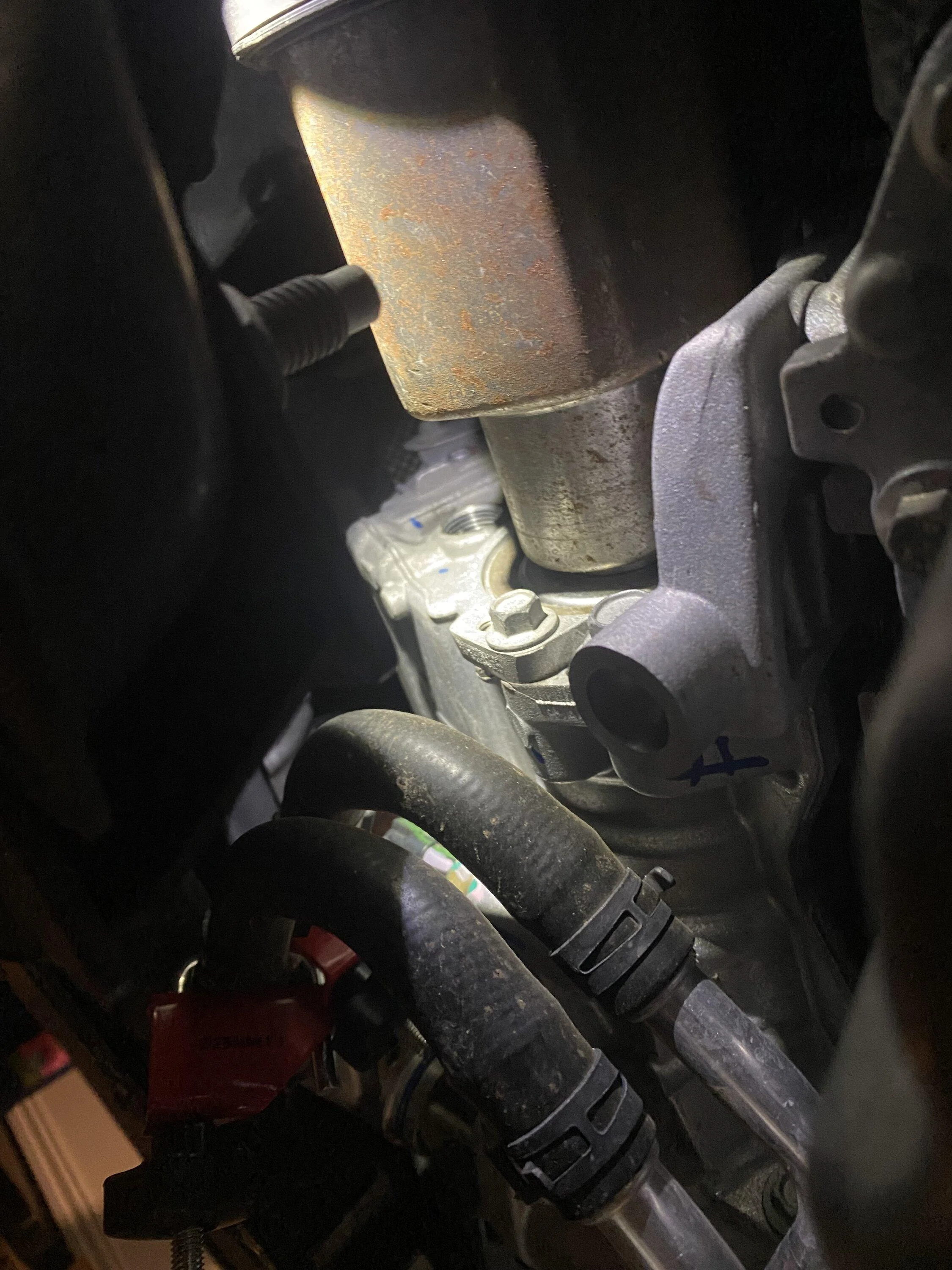

There are some photos on the bronco sport form from a badlands that has the same water cooled PTU as a Maverick Tremor.
Looks like you take the two bolts that hold the water to oil cooler into the ptu and slide the cooler out to get the old fluid out. fill plug is very had to reach on the passenger side by thew cv axle.
https://www.broncosportforum.com/fo...-30k-mile-fluid-flush.8900/page-3#post-160601
some of their photos.
Photo of the water cooling unit slid out.
Ford Maverick How To: Oil Change on Tremor Maverick tremor ptu

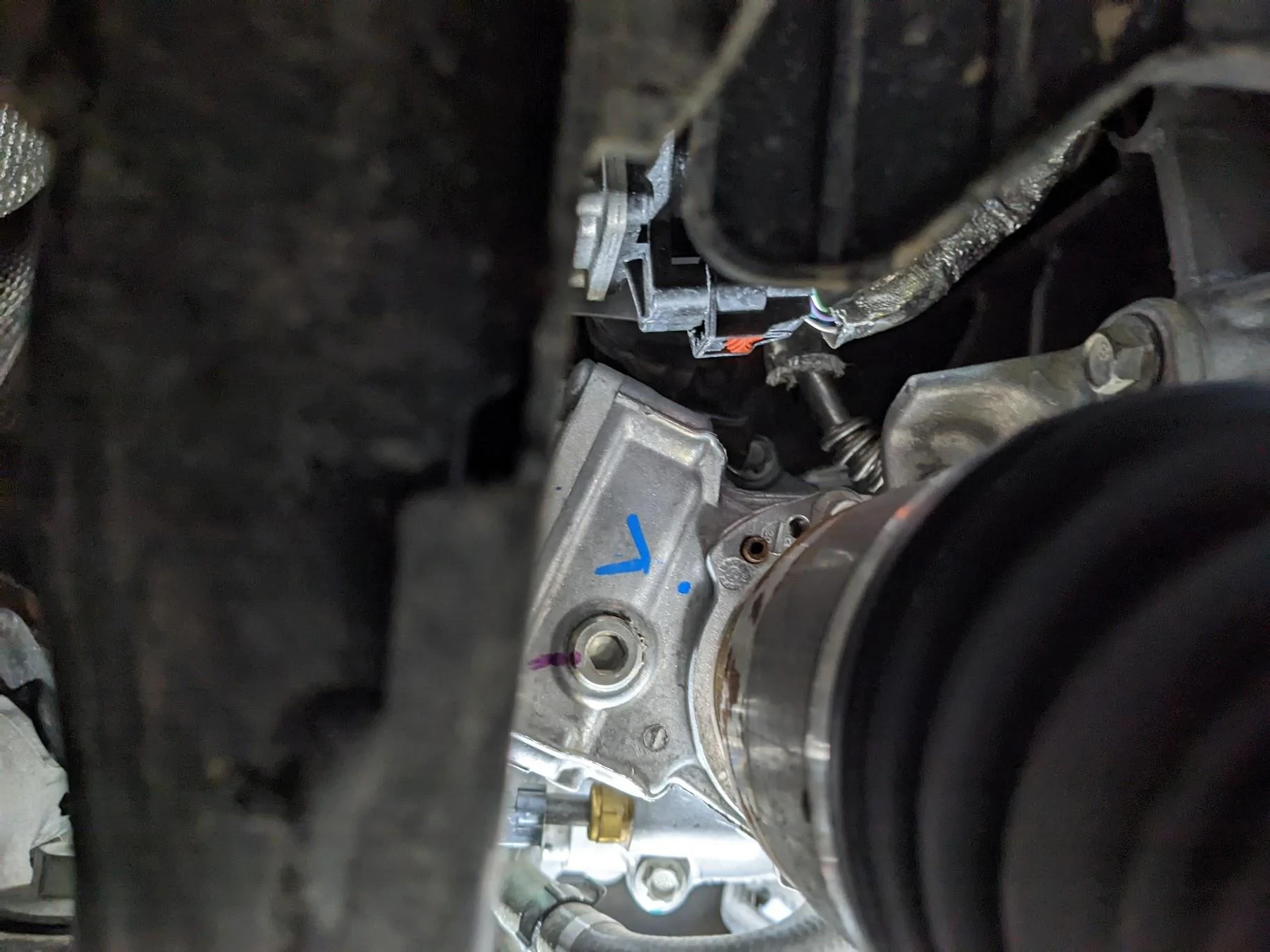

And a photo of the fill plug.
Ford Maverick How To: Oil Change on Tremor Maverick tremor ptu fill plug

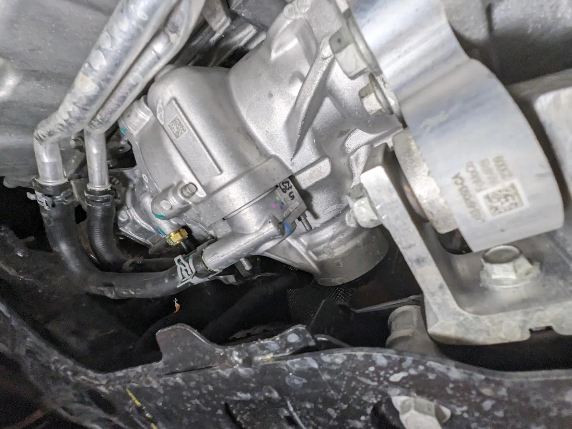

here is a photo of my trucks PTU water cooler still in.
Ford Maverick How To: Oil Change on Tremor Maverick tremor ptu water cooler
It looks just like the bronco sport badlands.
The fill plug is hard to see, maybe pulling off the passenger side front tire would give you a better view. Fill plug is right next to the CV on the passenger side. Transfer case PTU fluid changes I think should be done at 30k miles or sooner with Motorcraft SAE 75W-85 Premium Synthetic Hypoid Gear Lubricant.
Ford Maverick How To: Oil Change on Tremor Maverick ptu fill cv

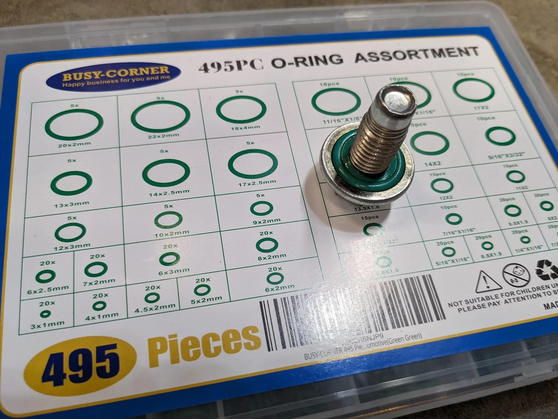

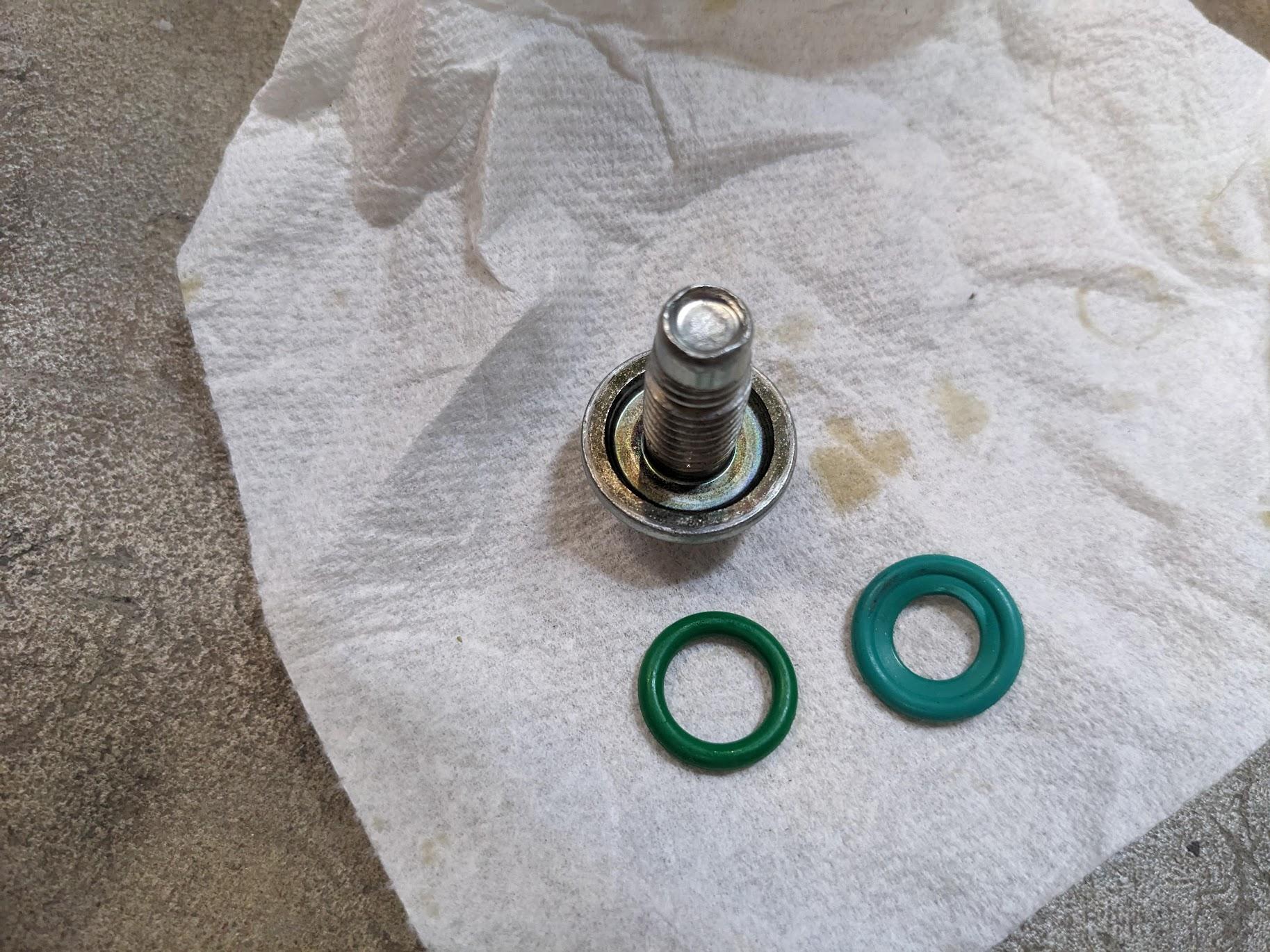

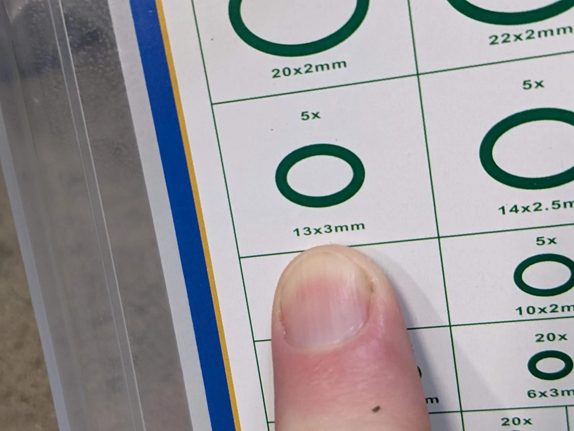

seal, oring, on oil drain plug.
So I got a multi pack of 0-rings from amazon. I still dont have the real ford part number or else I would have ordered one from Ford.
No perfect match but one worked. no leaks yet.
13 x 3 mm
Ford Maverick How To: Oil Change on Tremor Maverick PXL_20230909_200536196
Ford Maverick How To: Oil Change on Tremor Maverick PXL_20230909_200928171
Ford Maverick How To: Oil Change on Tremor Maverick PXL_20230909_200958837
Second oil change and the factor o-ring still looks good. so no need to really change it with every oil change. But it would be good to have a spare for when it does go bad.

I remove the 4 - T30 torx screws holding the fascia to the skid plate, and then use one arm to hold the skid plate up while remove the 3 - 13mm bolts on one side with an impact driver and then switch and do the other side.
Slide the skid plate back (towards the rear of the vehicle) about 3 inches and it drops free of the front fascia. Roll out from under the vehicle with it.
Using a Solo cup on the filter and I get nothing on the plastic fascia - the cup catches 90% and the remaining drizzle misses the fascia.
