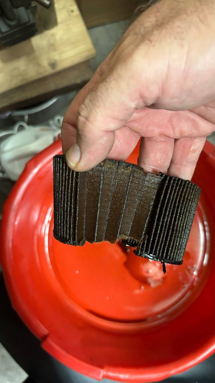

I just did my 3rd oil change and here is the analysis from Blackstone on the 2nd oil change, I did not analyze the first oil change but I did do the factory fill oil at just over 6000 miles which was 50% oil life and this last analysis was at 19% oil life. If the motor is not running for all the miles then it would seem to be bette rot go by the oil life monitor.. Either way the lab recommended going to 11,000 which would be about zero percent oil life or right about when Ford says to change the oil. Was worried about the long block bad crank shaft thing so I cut open my oil filter as well and I could see no foreign material. If you really want to get int he weeds on oil go to Bob Is The Oil Guy forum, those guys go deeeeep!
