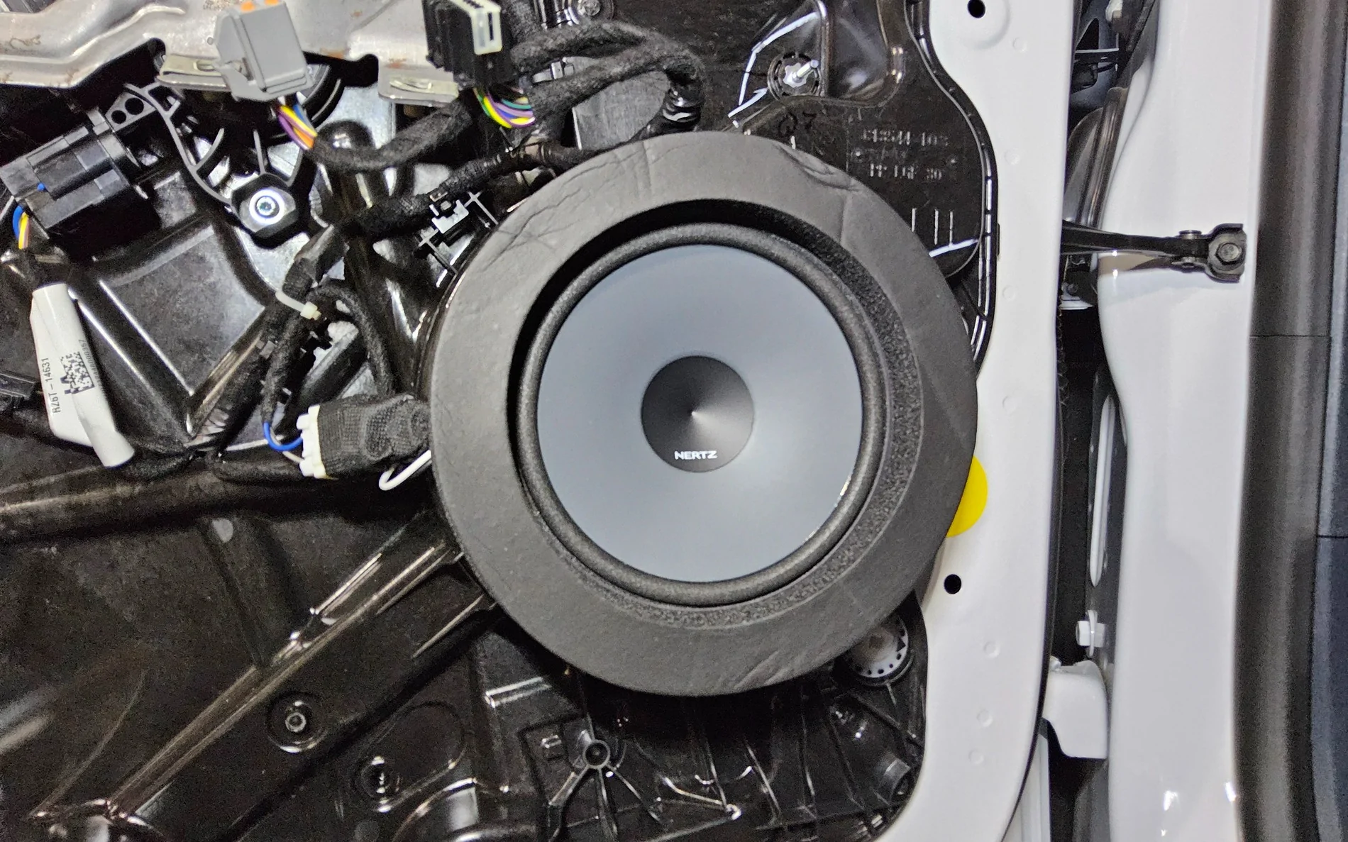

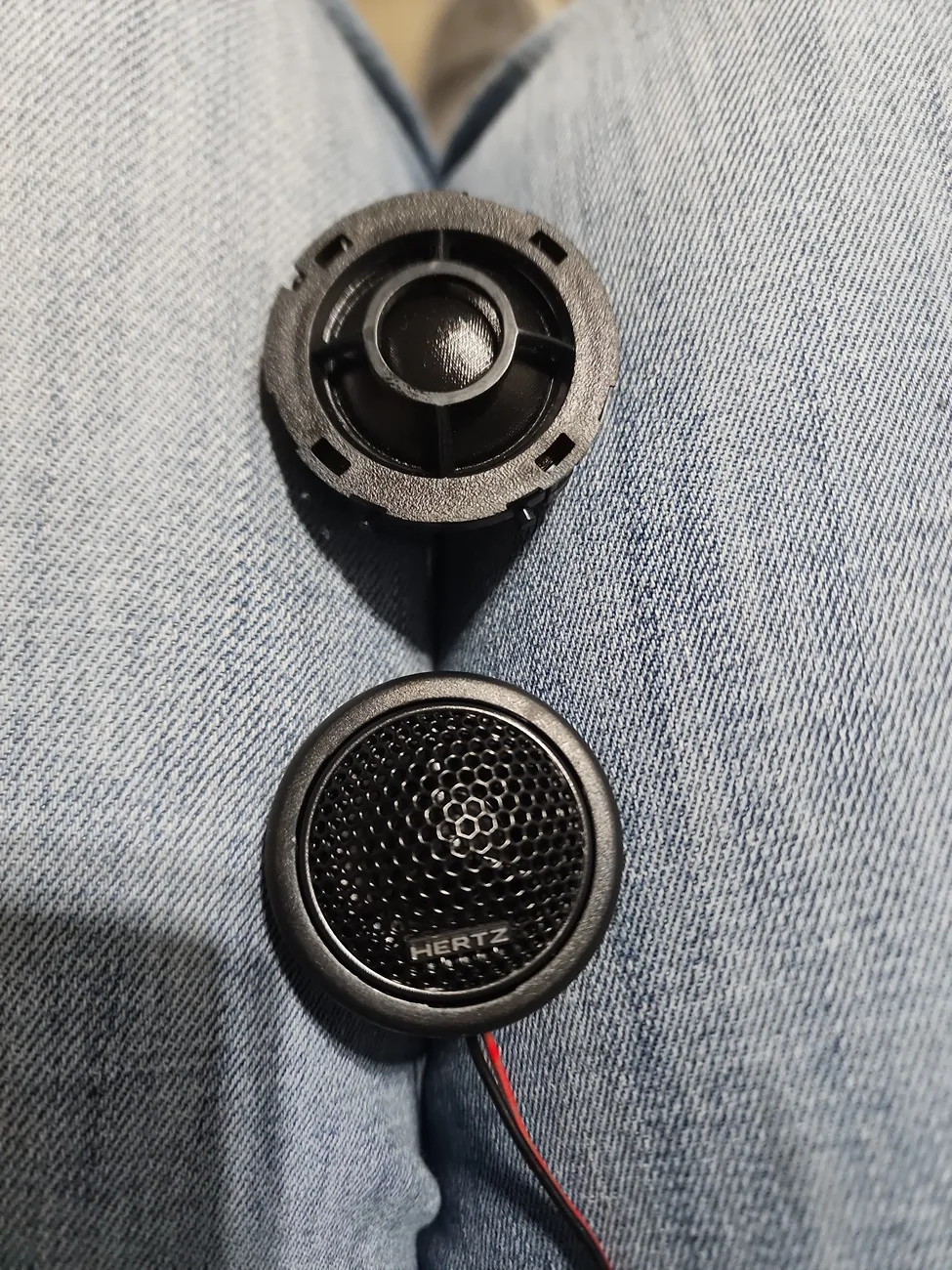

Ford Maverick How Everyone Is Wiring Components On B&O 054b4fbe-21a1-4e65-9571-61d9179cb8f
Ford Maverick How Everyone Is Wiring Components On B&O 20241116_011801

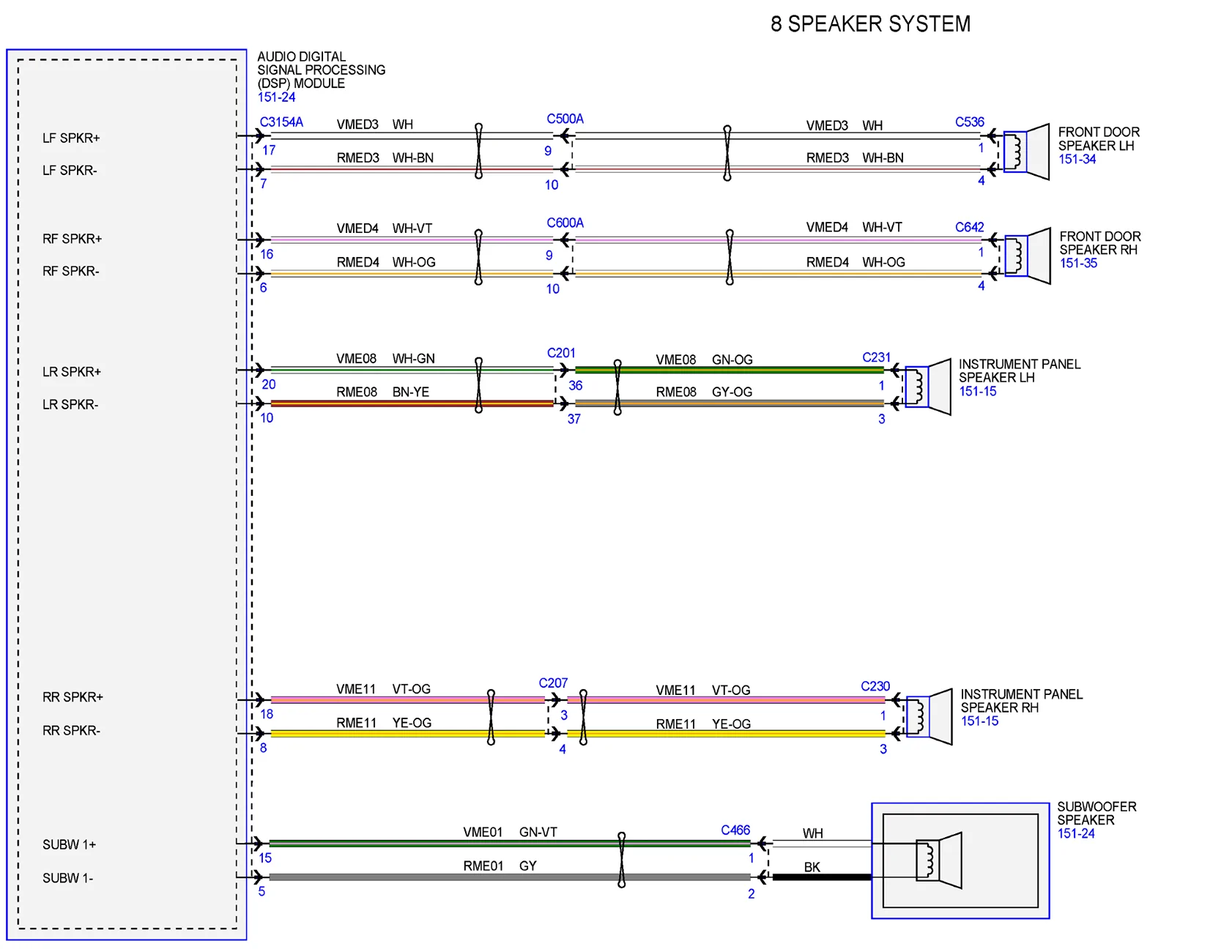

Ford Maverick How Everyone Is Wiring Components On B&O 1781133432852-k6
This is what I found, to mean that has seperate wiring and is probably another channel and I believe Ford says they are 5channel amps
Carlitos_92
Mar 24, 2024
2,263
4,586
You are correct; your B&O is not wired the same as the XL/XLTs. Otherwise I would've chimed in already. 😀
Not to revive the horse we beat to death in your other thread, but in Forscan, the door/dash speakers are probably already configured how you'd want them, since the factory speakers are effectively components too. If there are any caps at the speakers themselves, they are in addition to whatever signal processing the head unit is doing.
It is probably worth going ahead and just replacing the speakers one-for-one without your new crossovers to see how it sounds. You'll know if you're pushing either of the driver sets, so there is little risk of damage. It's been done before, though I haven't searched for other examples: https://www.mavericktruckclub.com/forum/threads/b-o-tweeter-wiring-questions.58606/
