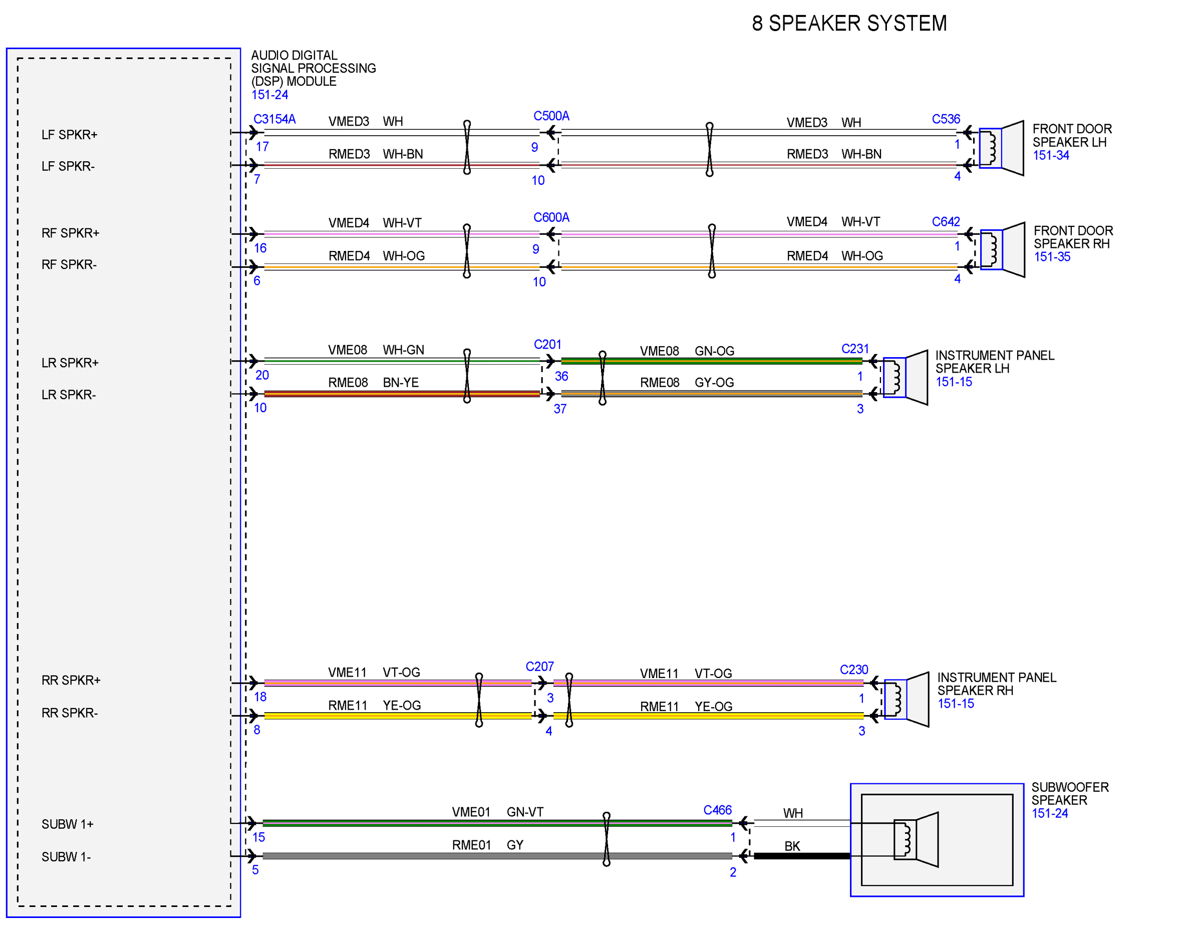

Because the bass of a track could be mixed to one side or the other if pulling from a stereo source. But the extant subwoofer output is already combined mono. So you would only need to connect one channel of the hideaway, yes. Also there's a possibility of a low pass filter on the front channels.
Great advice throughout the thread. I just want to point out that you meant to say high pass filter.

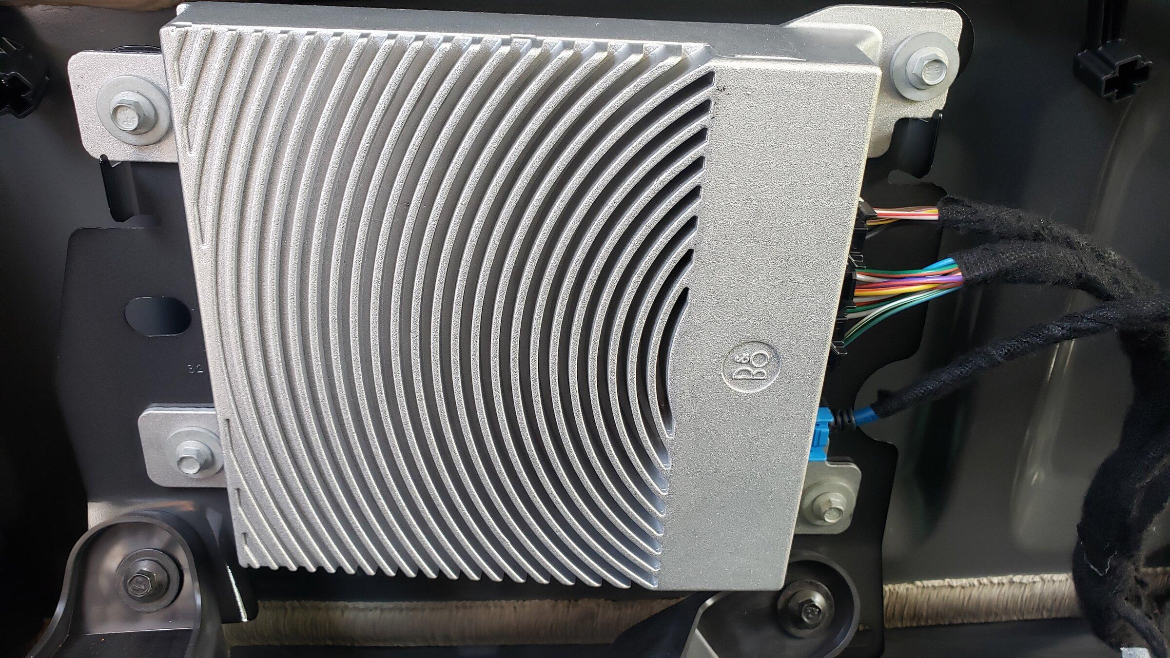

I'm doing an install right now and trying to find the appropriate remote turn on wire that feeds into the existing amp. I'll be tapping off the factory sub wires for audio input.
The stock amp power is hot at all times. It may simply be woken up across the HS canbus. There is the Yellow w/ Violet 'Enable/Clip Detect' line that links it to the ACIM, but not sure if that is relevant. That said it's probably better to connect to more of a known good key-switched power. The ACIM waking up to do things when parked also wakes up the amp (and by extensions auxiliary amps triggered by signal sense).
Edit: Looking at the service manual the Enable/Clip Detect circuit is nominally only some 3-7 volts.

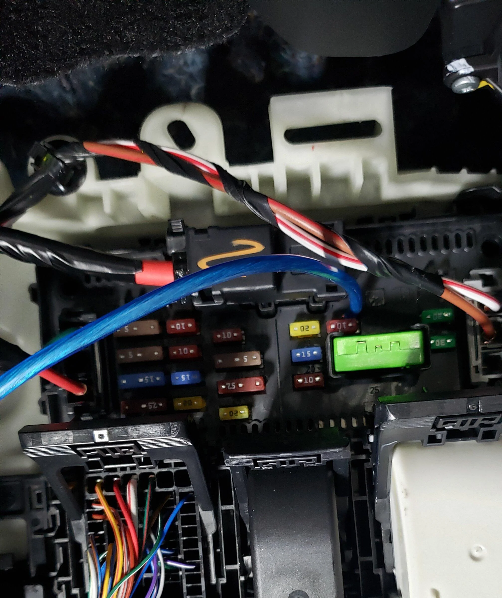

I bought one of these since I need line level conversion anyway.
DO NOT BUY. https://www.amazon.com/dp/B07VKFSLKN?psc=1&ref=ppx_yo2ov_dt_b_product_details
Update. DO NOT BUY THIS ADAPTER IF YOU HAVE A B&O STEREO. You will run into DC Offset issues that will cause your amp to go into protection mode. Amp runs fine if I run the remote input straight to +12v. So I'll be running a remote turn on up front with a fuse tap. The problem is there isn't enough DC voltage to run the remote turn on properly (at least not for my Polk Audio D1000.1).
