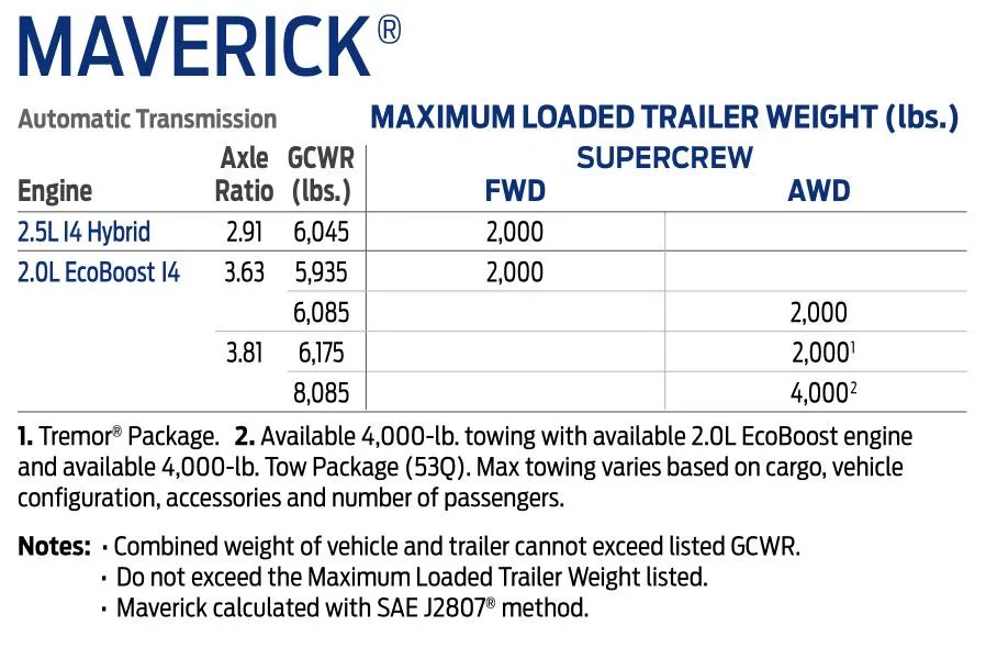

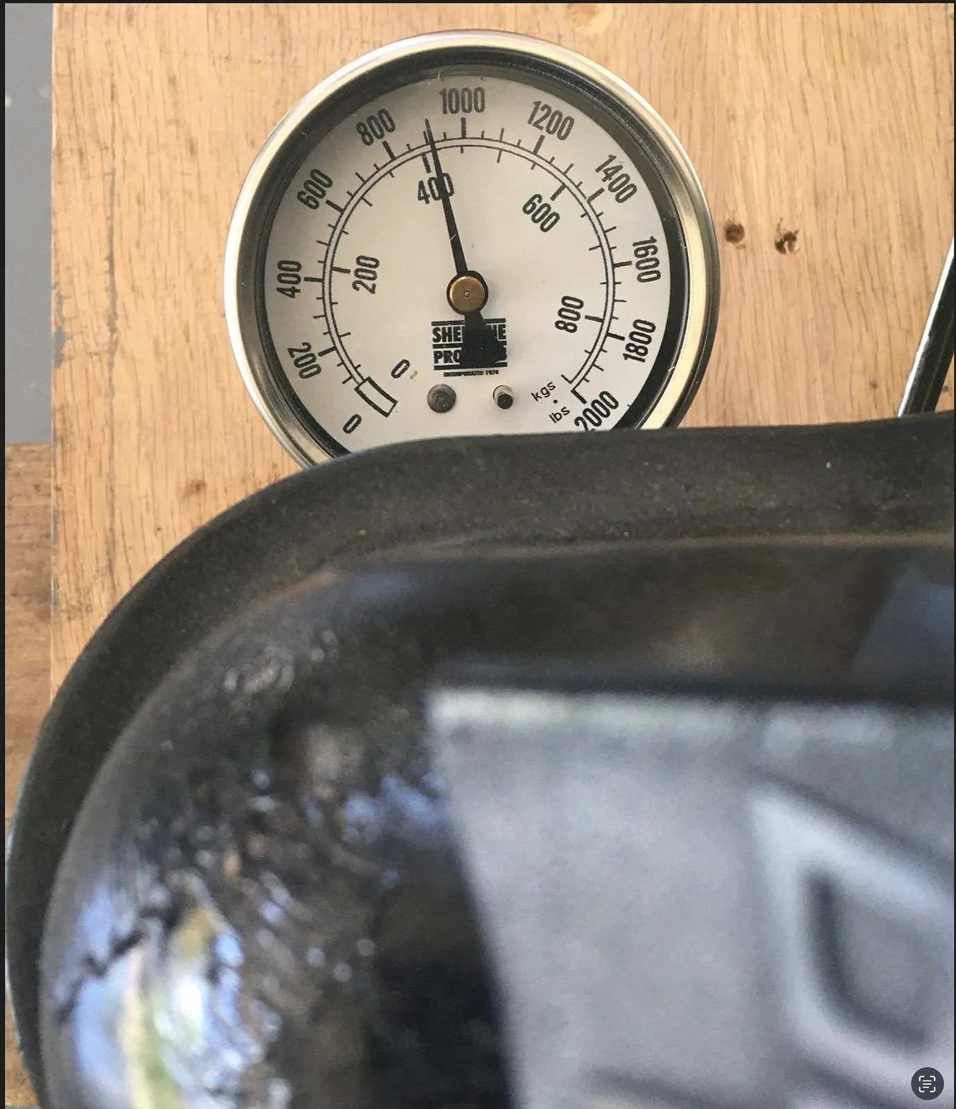

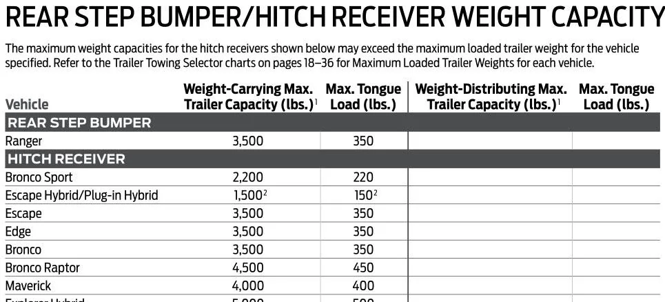

Measure the Tongue Weight.
Hopkins Medical Products EZ Carry 550LB Digital Scale
Fastway SIMPLE WEIGH Tongue Weight Scale
Sherline LM 1000 - Trailer Tongue Weight Scale - 1000LB
Notes: • Combined weight of vehicle and trailer cannot exceed listed GCWR.
• Do not exceed the Maximum Loaded Trailer Weight listed.
• Maverick calculated with SAE J2807 ® method.
Ford Maverick How do you determine tongue weight? Maverick Receiver Hitch Tongue 400 lbs Ford Maverick How do you determine tongue weight? Maverick Maximum Loaded Trailer Weight
