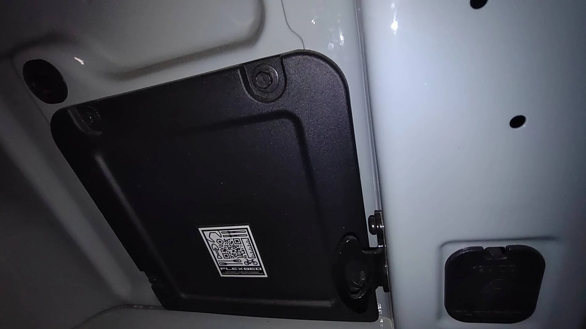

Lots of option to route the wires. Two small grommets or the large panel on either side of the bed.
I imagine plugging something in next to the tow hitch, but then it has to route up to the top of the cap. Doesn't seem like there's a nice way to do it unless you can break into the cabling before the socket, T off and route up into the bed up above and behind the tow hitch. I don't have a truck to tinker with to see if that's a good way.

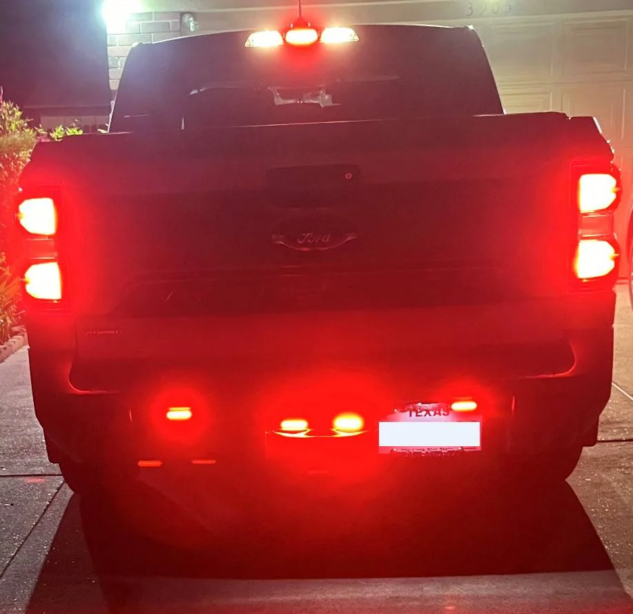

I looked at making a harness with a tap for the 3rd brake light.
I decided accessing it would be more than I wanted to do since it's above the headliner.

In the end I added a tap onto the CHMSL wire coming out of the BCM and used a solid state relay between the BCM's CHMSL pin 57 and the LEDs on rear bumper. Routed the wire thru rocker panel to the grommet on right hand side of rear cabin and back to rear of the Maverick.
BCM YL 22 Awg -->>---> SSR IN+ | SSR Out+ >>---- RD 20 Awg -- +12v
12v Ground 22 Awg -----> SSR IN- | SSR Out- >>---- YL 20 Awg ----->>--- LEDs.
SSR I used:
KF0604D Relay Solid State, 32 VDC Input, 4 Amp, 60 VDC Output, 4 Pin
https://www.amazon.com/gp/product/B00B888YME

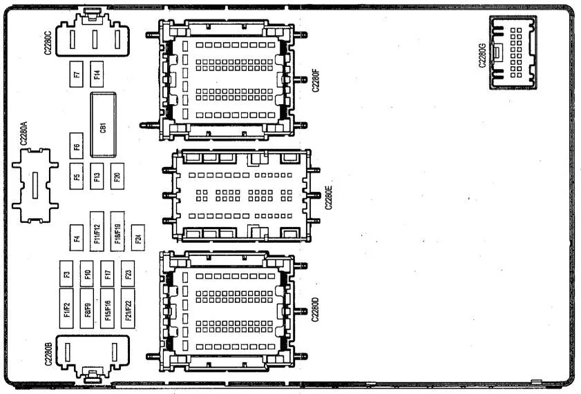

Where did you find info for identifying the pins on the BCM?
For the CHMSL:
Service Manual > Wiring Diagrams > Turn Signal/Stop/Hazard Lights, C2280F Body Control Module.
Ford Maverick How do I move or add another third brake light when adding a DIY canopy? BCM C2280F p57 to CHMSL C475 p3
Ford Maverick How do I move or add another third brake light when adding a DIY canopy? BCM Connectors C2280A thru C2280G, Fuses, CB1
J7 - C2280G
J6 - C2280F
J5 - C2280E
J4 - C2280D
J3 - C2280C = 3 Pin Female TE 22824442-2 A
J2 - C2280B
J1 - C2280A
Ford Maverick How do I move or add another third brake light when adding a DIY canopy? BCM C2280F Pinout
