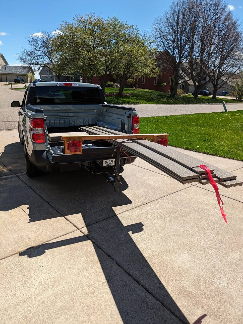

I'm thinking about buying a Maverick, and I've been working through topper possibilities to make sure the vehicle will suit my needs before pulling the trigger. So, I've also been thinking about the third brake light and ended up on this thread. I don't have a Maverick in front of me to verify, but it looks like the best option is to split off from both tail lights and run it through a thingamabobber (2-3-Wire Splice-in Trailer Tail Light Converter)
https://www.amazon.com/Oyviny-3-Wir...6b89adb6cfb50&language=en_US&ref_=as_li_ss_tl
as discussed here:
May still need to include a relay probably on the output instead of both inputs assuming the device doesn't sink current.
I haven't figured out the harness splitting solution yet either. Let me know if you get that figured out. Here's how it's done with a beautiful harness splitter (T) that comes with a Snug bed cap. I don't know if you can buy it separately or how much it costs.
I'm guessing that Snug's light includes all the necessary logic that the thingamabobber and a relay will do.

I think it gave a message something like check surroundings for obstacles. Not sure if that was due to the lights plugged in or the tailgate being down. Either way I didn't pay much attention. Does it really matter if it thinks there's a trailer when there isn't? I'd take an irrelevant message rather than splicing into the wiring.

Could probably put a relay on the trailer output, so that it doesn't know anything is connected. But, how do you get the wiring from the tow hitch up into the truck bed?
