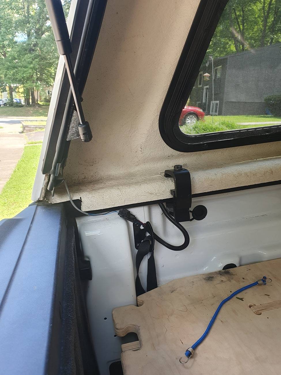

Could probably put a relay on the trailer output, so that it doesn't know anything is connected. But, how do you get the wiring from the tow hitch up into the truck bed?
Lots of option to route the wires. Two small grommets or the large panel on either side of the bed.
I imagine plugging something in next to the tow hitch, but then it has to route up to the top of the cap. Doesn't seem like there's a nice way to do it unless you can break into the cabling before the socket, T off and route up into the bed up above and behind the tow hitch. I don't have a truck to tinker with to see if that's a good way.
