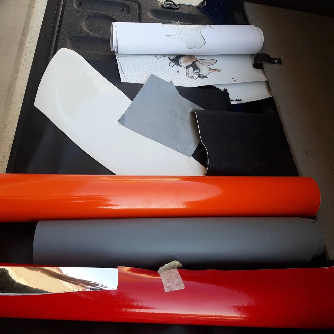

After more than 7 years of co-owning and working in the vinyl graphics and PPF industry.
Try not to pick it up. Off the surface
Be very careful with the heat gun no pulling. Your best results may be using a friend or two with the heat gun, try to reposition by gently sliding it into place. When you're done then remove the residual adhesive.
My biggest advice is patience and take your time.
Keep us updated.
Good luck
