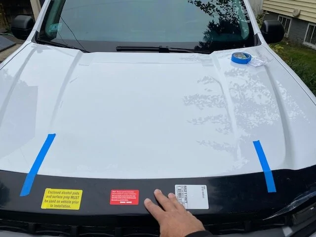

Pro tip: Line it up and use blue painters tape to hold it in place when getting it centered.
Carefully cut the tape gap between the hood and the deflector, leaving tape in place on both. This is your guideline for installation.
Remove some of the red tape from the adhesive tape, and then use the blue painters tape to realign where the deflector goes, then adhere. Remove the blue tape and you're good to go.

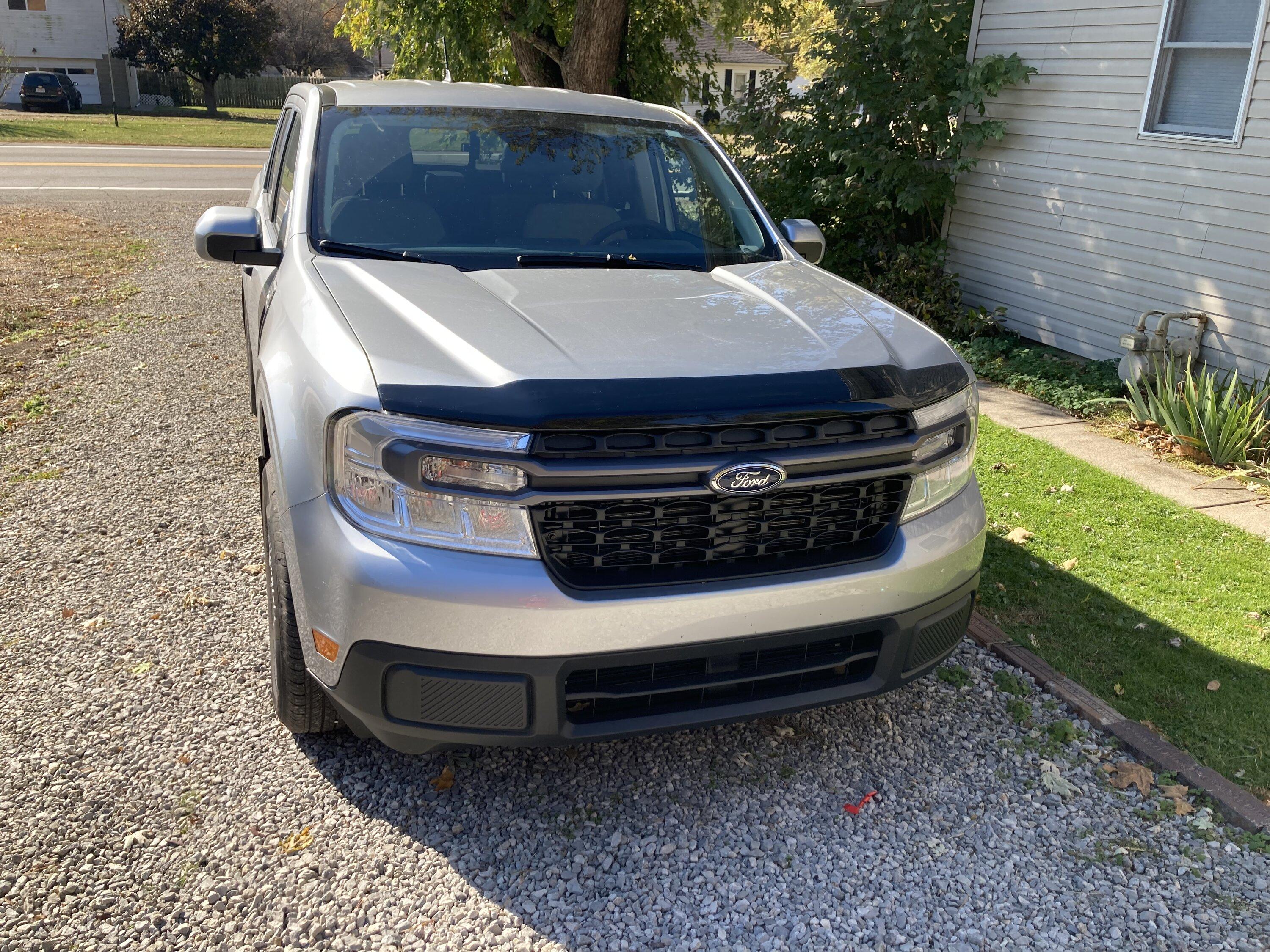

Done this morning after it warmed up a little. Not sure what’s in that prep pad but it has strong smell
