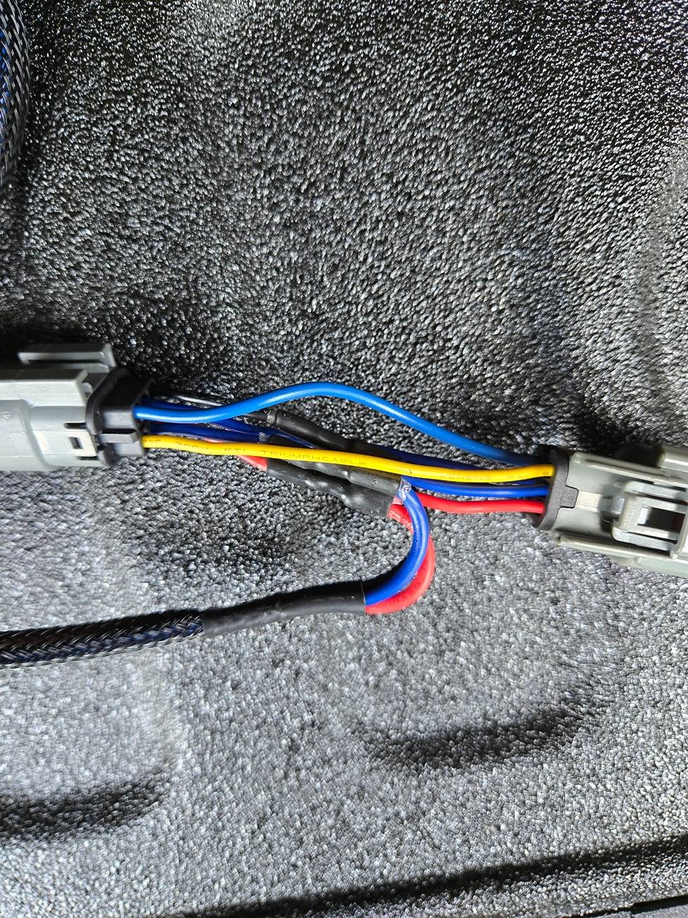

Update on the install. Shaved the keys off and the connectors went right together. I check the issue with the bottom turn signal bulb and found out my truck has a 6 pin connector, probably because being a lobo with the 702a package that has upgraded taillights.

Checked the wiring from the truck and 2 of the wires are used for turn signal. The t-harness is only 5 wire. I added the 6th wire to the t-harness and now both turn signals work. So just some small modifications and it's all good.

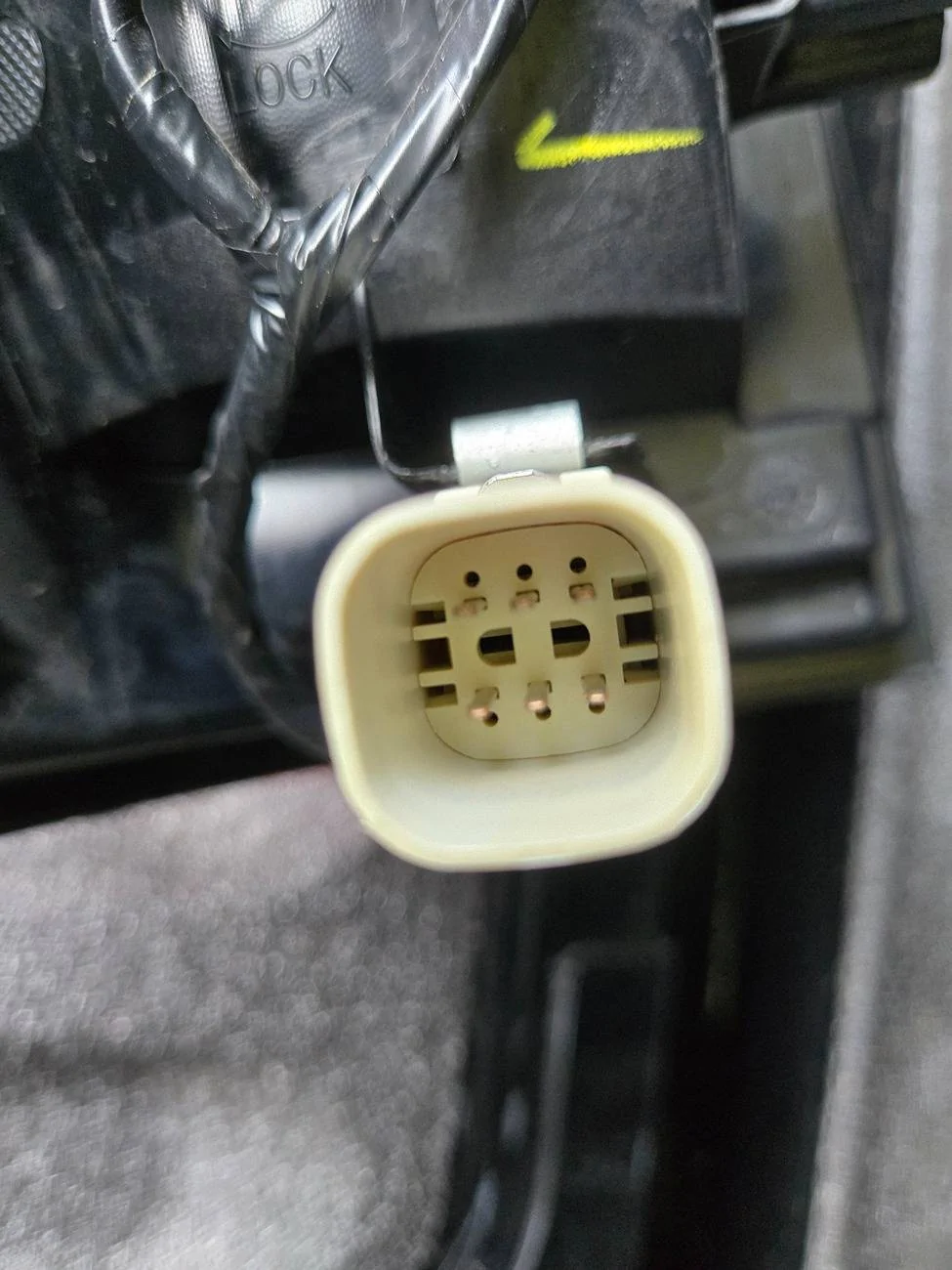

That is WEIRD. 22-24 had at most 5 pins, with both of the brake/turn bulbs powered from the same pin. It's odd that they would change that since there were no other changes to the tails. Ford continues to surprise me.

They keys were just slightly off on both sides preventing it from sliding together. I filled them off and it snapped right together. Was thinking bulb could just be out from doing the install. I contacted dd and they said the 25 wasn't a sure fit.

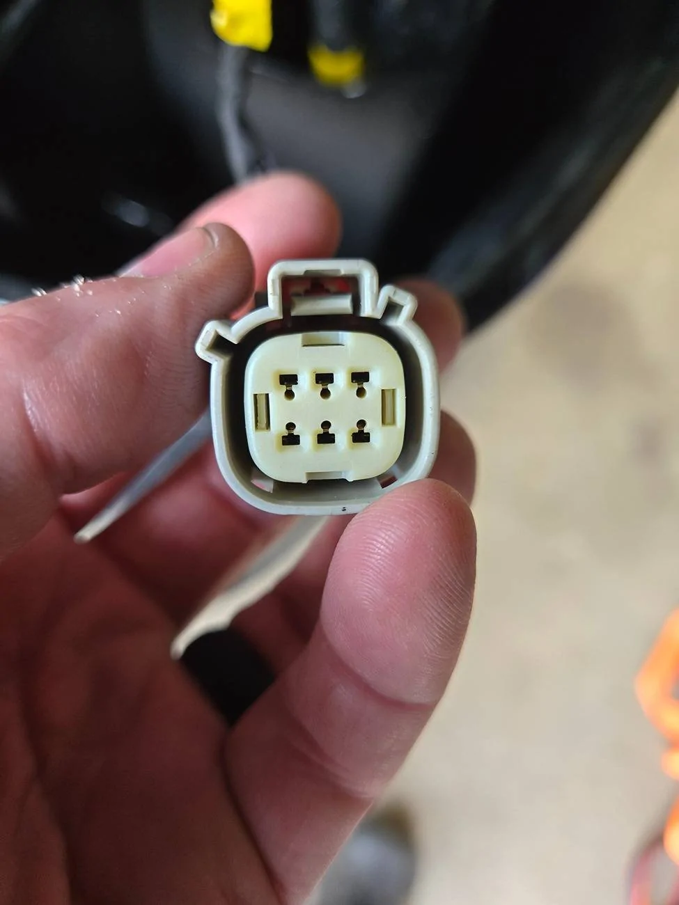

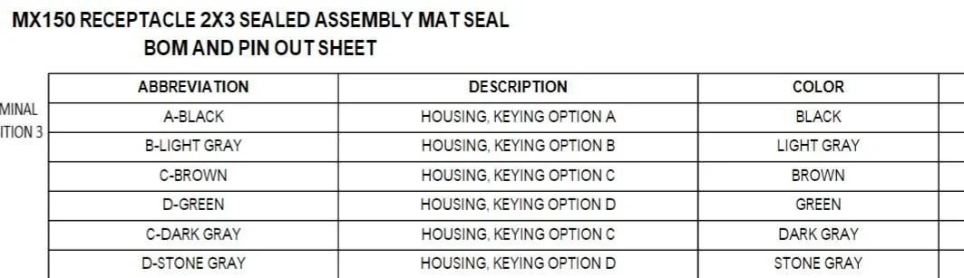

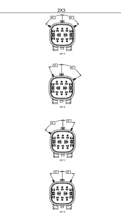

Those are scheme "B" (light gray), not "C" (dark gray, like my photo).

If this is the DD harness, they are using the wrong keying scheme. Those are scheme "B" (light gray), not "C" (dark gray, like my photo).
