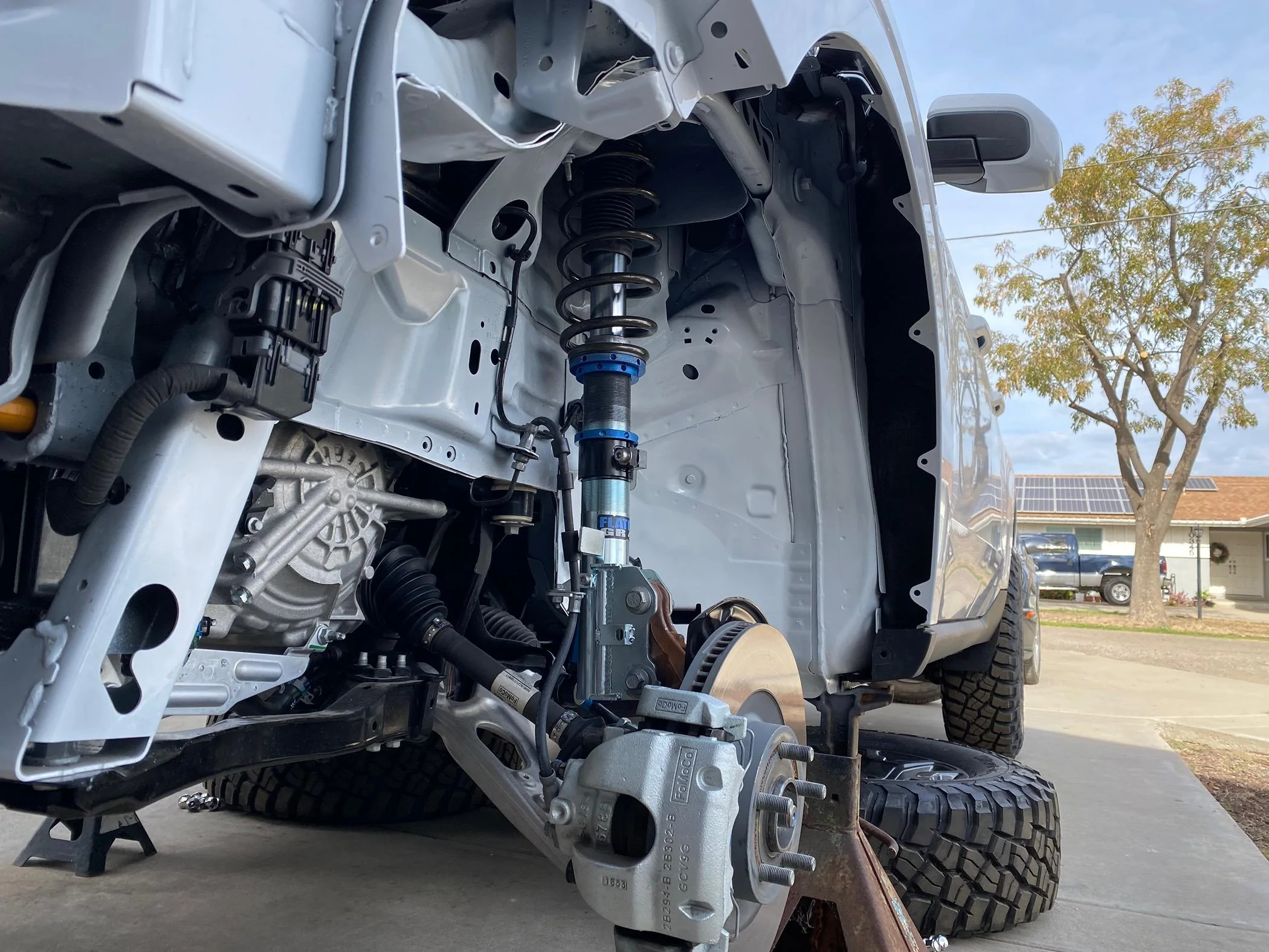

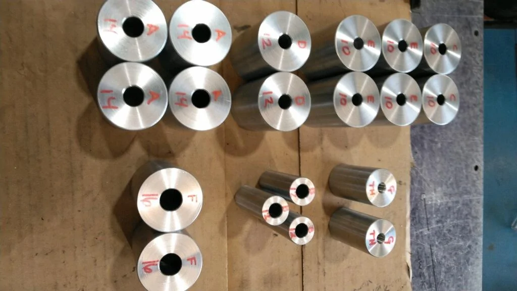

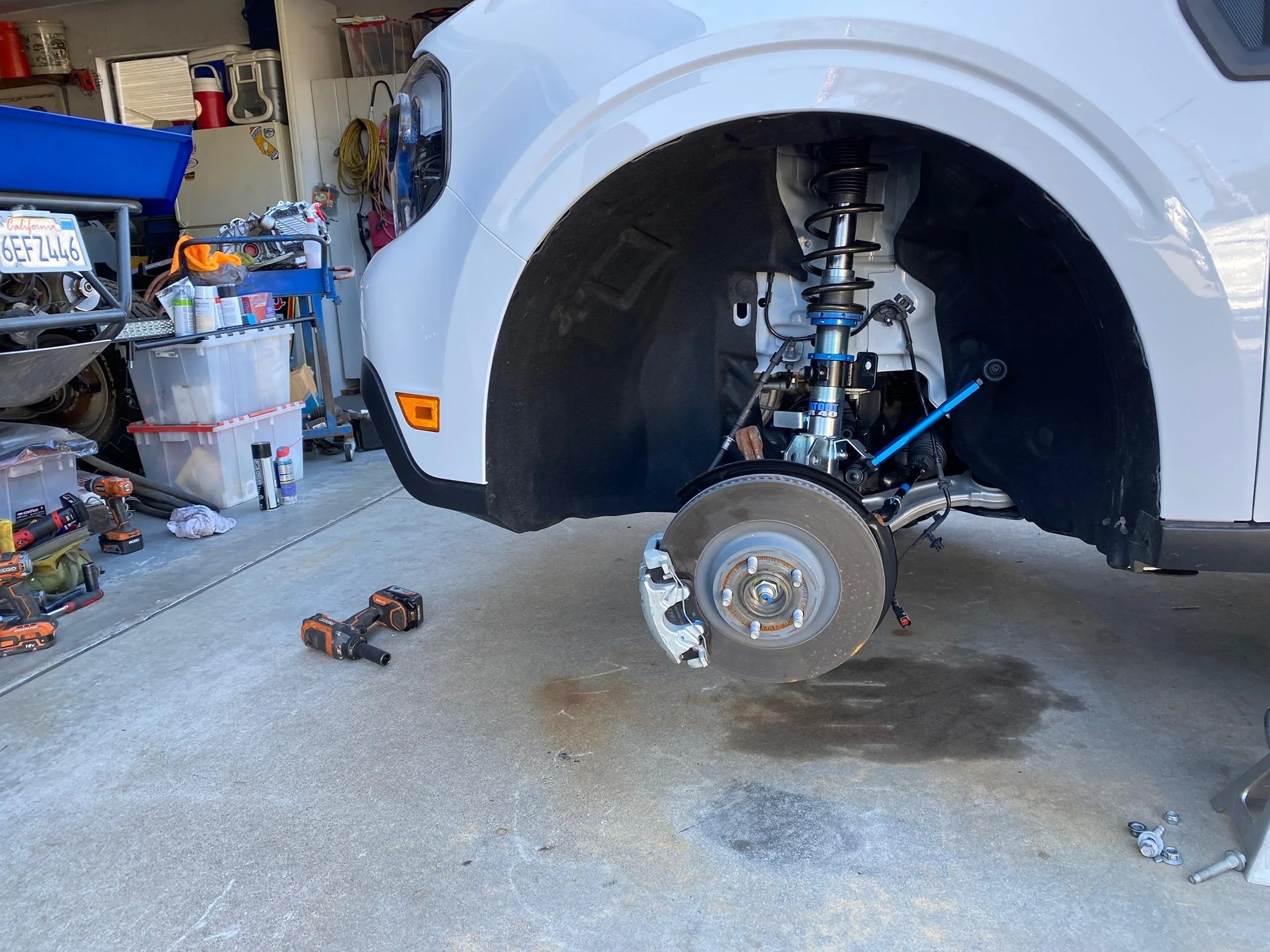

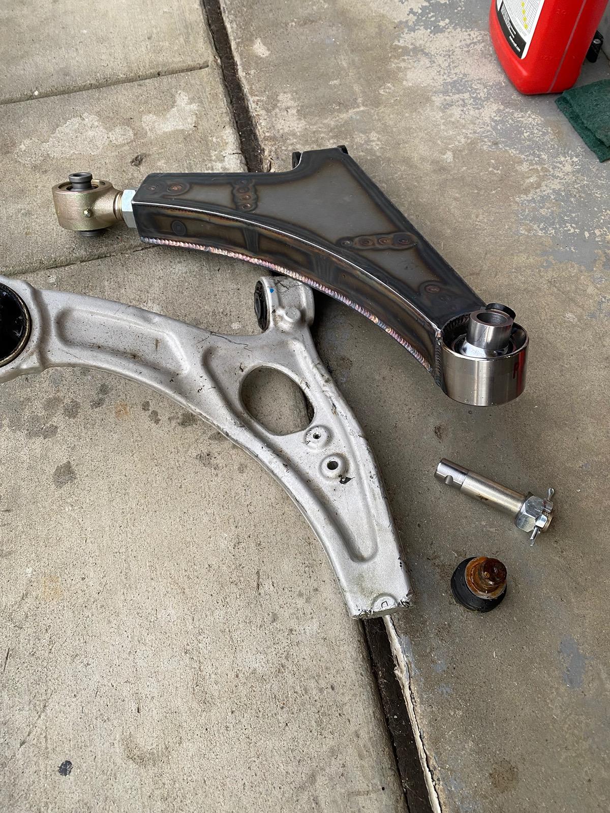

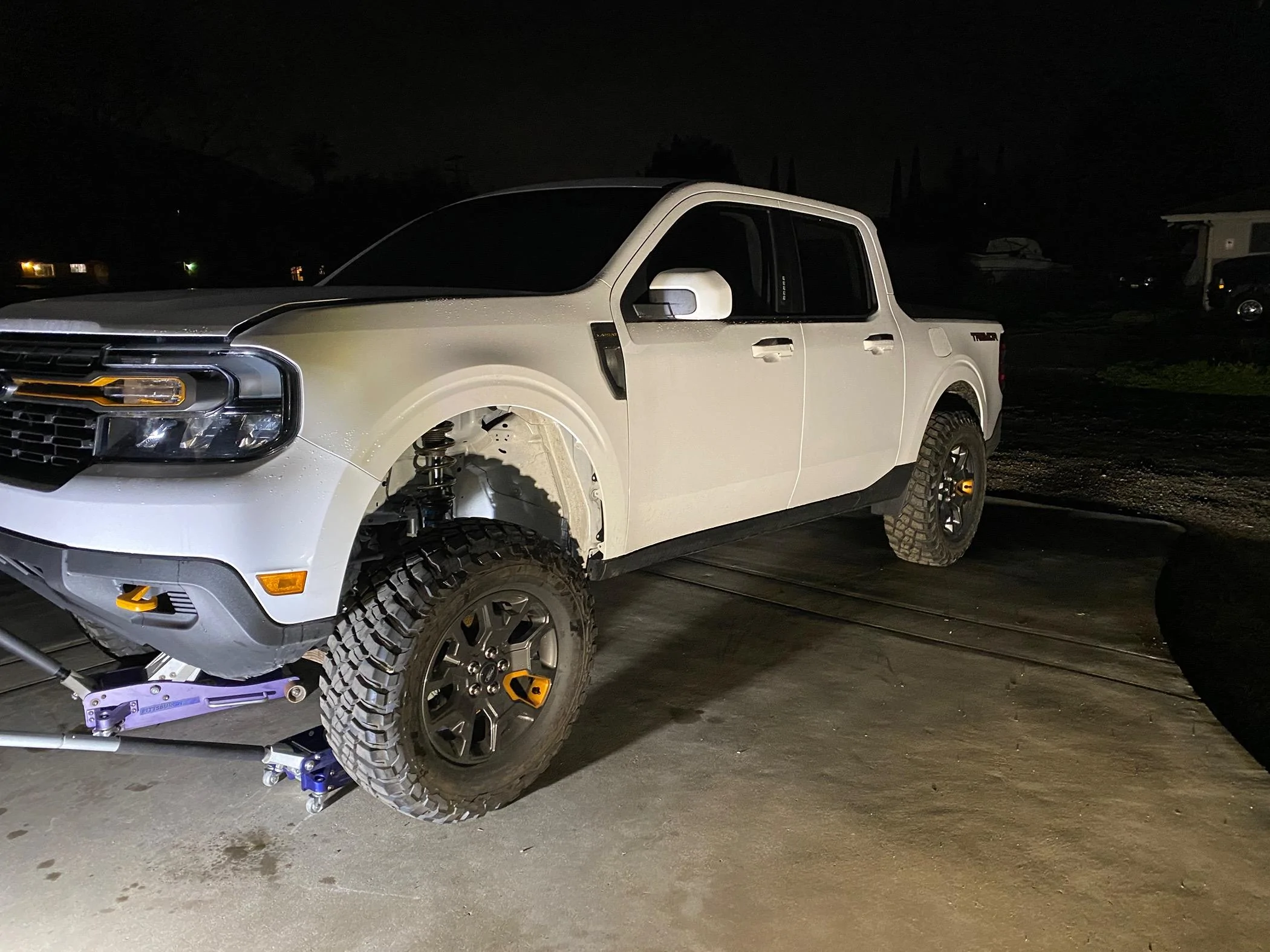

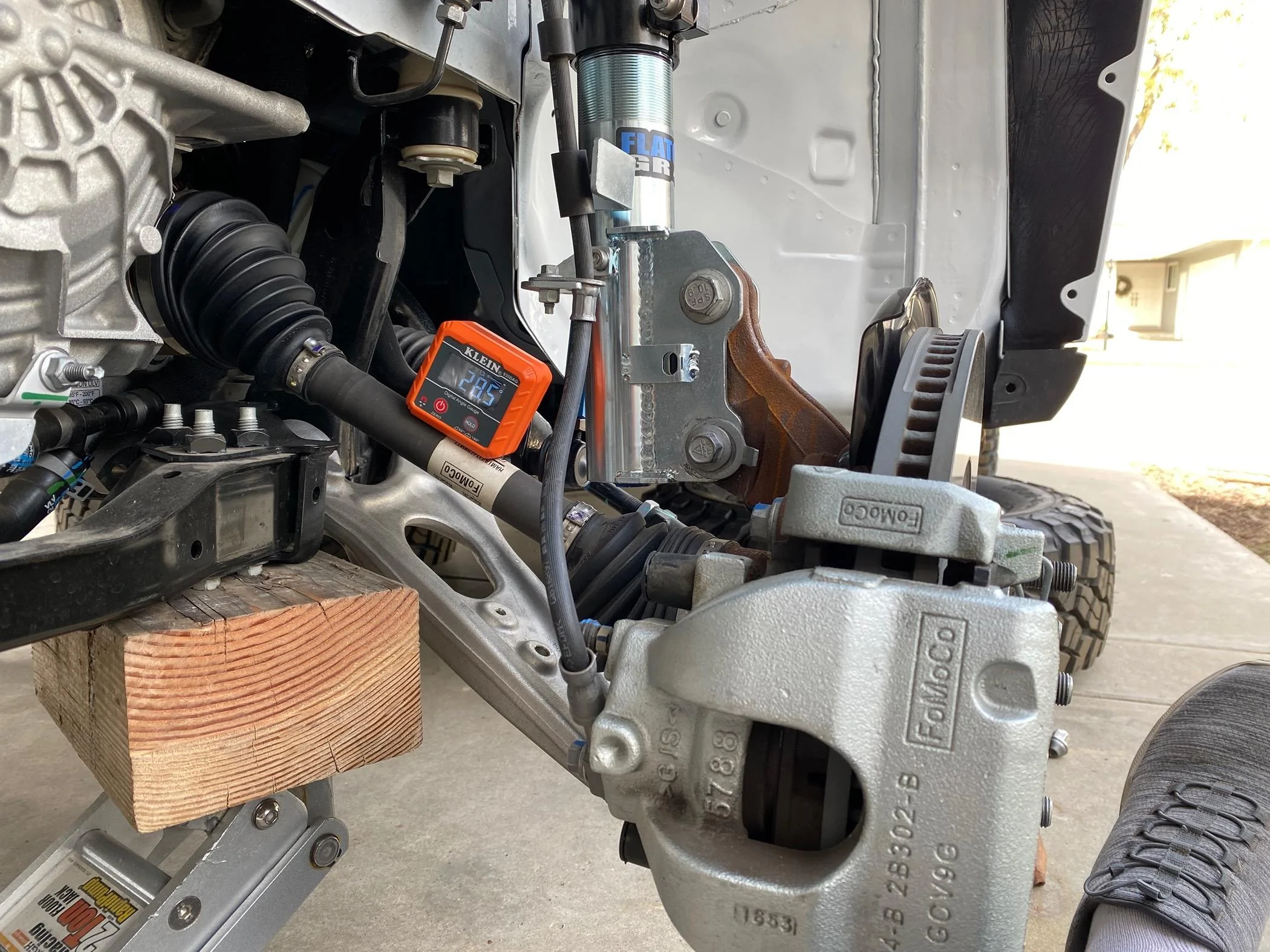

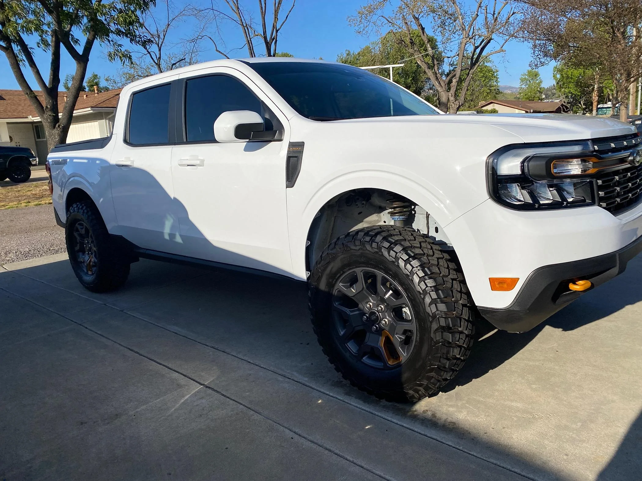

I have the gr40 kit along with my current 3” drop ( spacer) kit .

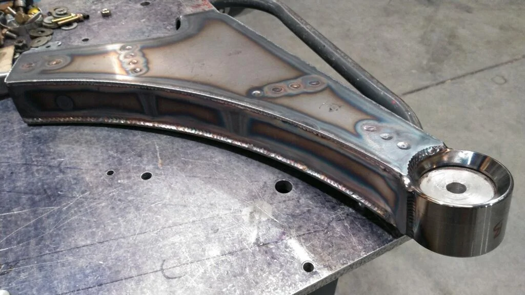

Am currently making a new 4” lift / chromoly front crossmember with optional 3 1/2” wider a-arms with axles .
Will be a few months before testing is done .
Best bang for the money is flat out gr40 or 40 plus kit if you don’t mind cutting holes for the resvoirs. You get additional strut and shock length equating to additional wheel travel in the area of 3- 4”
The shocks are good and adjustable ( softest setting equivalent to stock tremor).

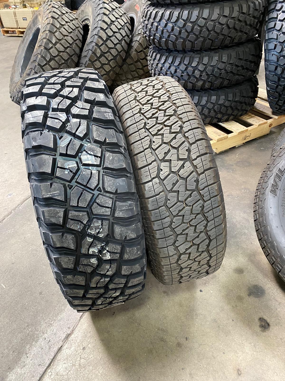

Currently have 255/75/17 (32”) tires , goal is 33” tires wheel base extended 1” forward , 7” wider track front / 6” wider track rear with new chromoly trailing arms .fiberglass fenders and bedsides too.
