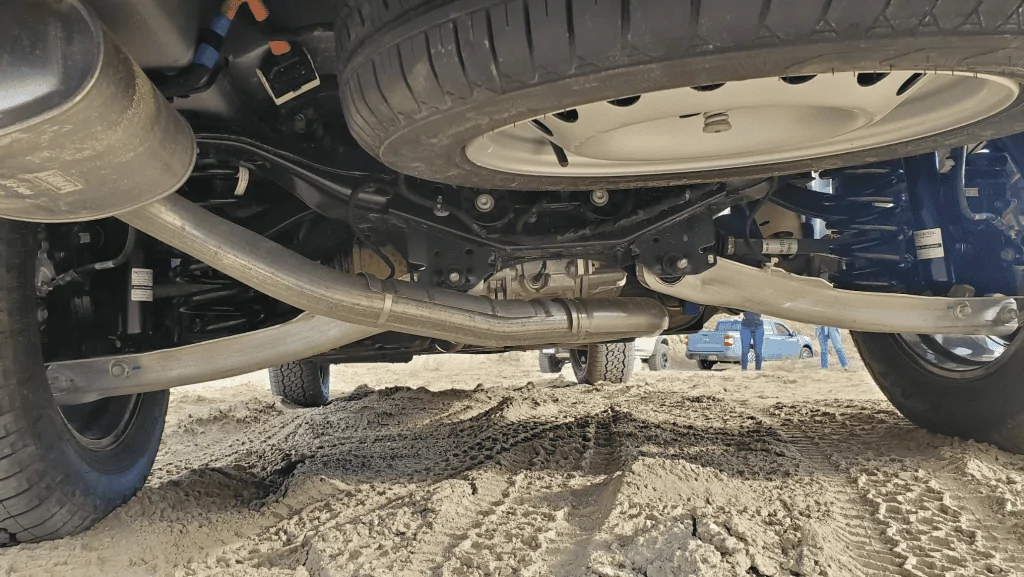

As shown in the Autopian article the rear drive unit is hardly the lowest point. There are some other good upskirt photos in that article, and the only article that claims the final drive ratio is 3.81
Ford Maverick Leveling verses lift kit under

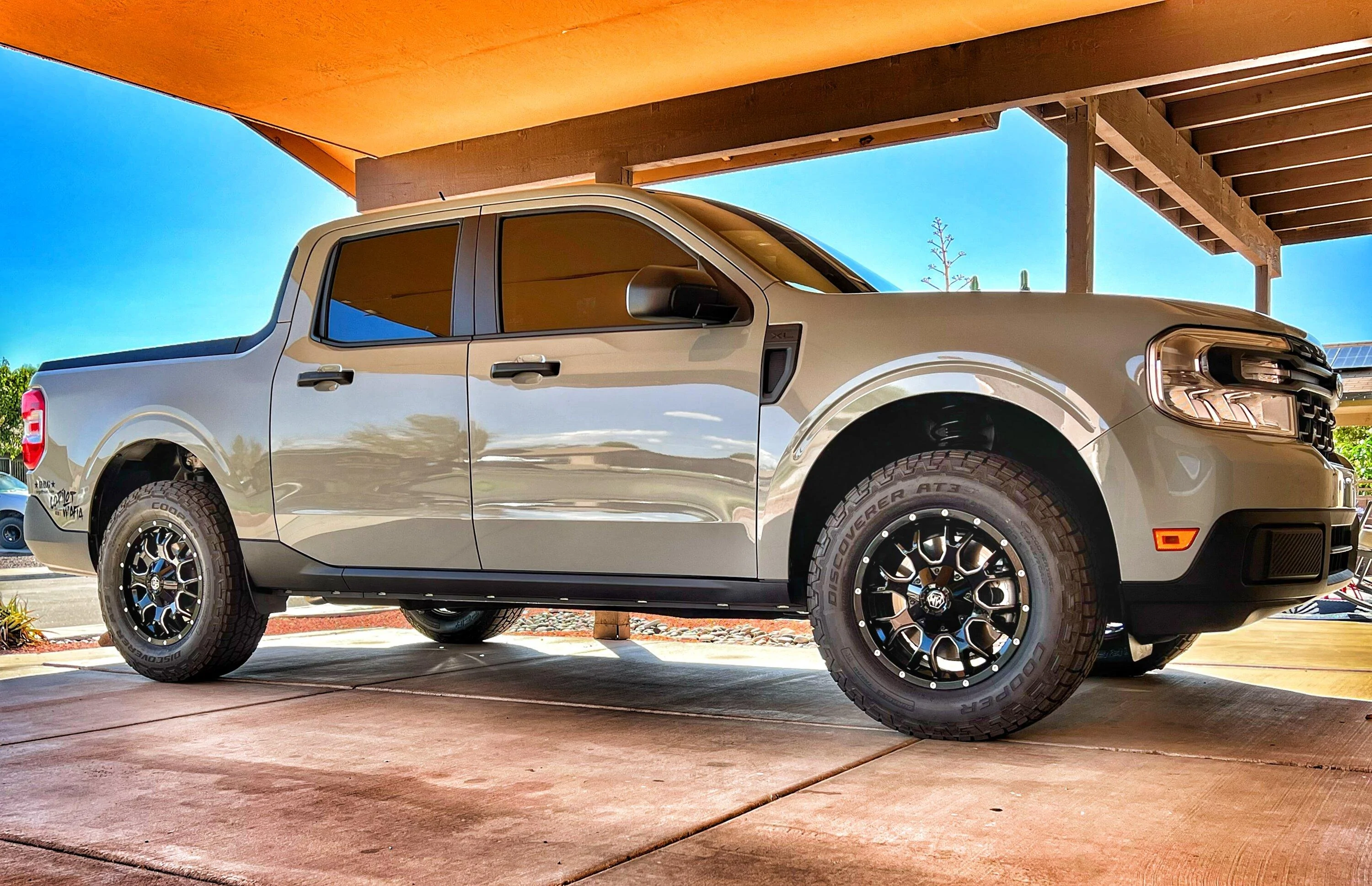

I leveled mine with a 1 1/2" HRG Leveling Kit https://www.hrgoffroad.com/ because I just wanted to get custom wheels and bigger tires, so it could have a better look. My truck is also a FWD so I knew I would not be needing a lift kit. My truck rides great and the kit was easy to install, I did it myself. Cooper Discoverer AT3 245/70R17 tires fit perfect and Mayhem Wheels https://www.mayhemwheels.com/ Good Luck and I hope this helps. I was having the same issue when I was looking to do something to mine.
Would you mind measuring the flor to well height in front and rear? Thanks
Thank you for a plain and simple explanation! I've been searching for someone to simply explain that they installed the HRG 1.5 LEVELING Kit with a picture.
