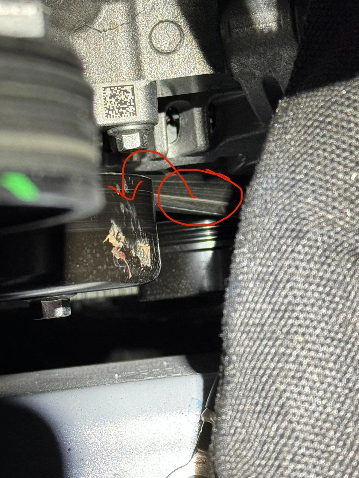

Help! This can’t be good right? "Charging system Service now"

Yep animal for sure but was not a mouse. Mouse are soft wouldn’t even phase the belt. That was some larger animal. But yes super easy fix. Warranty maybe. Depends on how the dealer wants to look at it.
Either way it is what it is. Get it fixed and be glad it wasn’t a mechanical issues and just freak animal delete

I think that a mammal‘s remains would be more bloody red than the peanut butter color it appears.
Does it have a smell?
Or a taste?
Cover yourself, and clean as much as possible before dealer sees it.

First question is how many porcupines have you strangled....?
Yes, something got in there and forced the belt off its track. It should be an easy matter to unload the belt tensioner and put it back in place once the foreign object is removed. The belt -might- be damaged, but probably not.

I poked around in there as best I could, and didn’t find anything at all that looked like critter remains. I’m stumped.

Is the belt supposed to where I drew the arrow (before it then comes down to meet that threaded part below)?

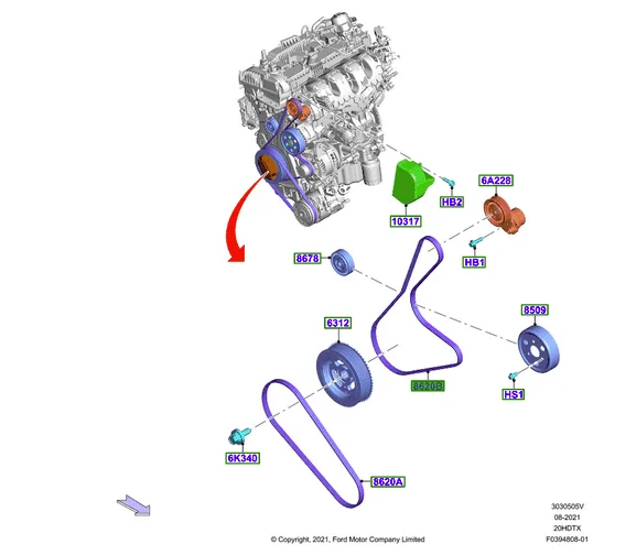

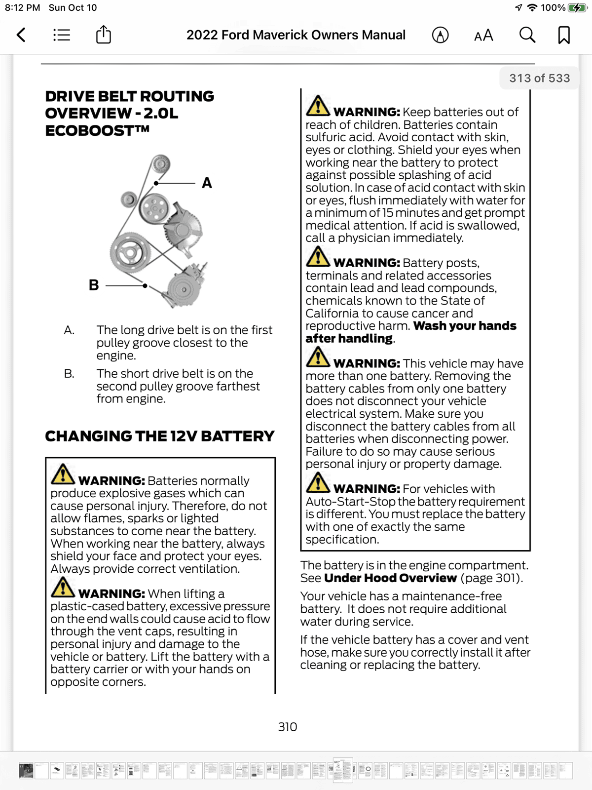

The pulley that the smudge is on is the belt tensioner and rides on the smooth side of the belt as is depicted in the routing diagram posted. The belt should be sitting in the grooves that are in the pulley to the right of the smudged one. I'm not familiar with this vehicle, but usually putting a long wrench on the bolt that's in the center of the idler/tensioner will allow you to remove the tension from the belt and replace it or in this case put it back where it came from. Whatever got in thee way might well be resting in the under engine cover and will be found during the next oil change.

Here is a better pic. The outer belt is a stretch, one time use style belt and would need to be replaced if you remove it. Luckily from Ford it runs $8 and the inner belt runs $35. I definitely would not drive it without the belt, if you can't replace the belt, have it towed to a repair shop, not driven.
