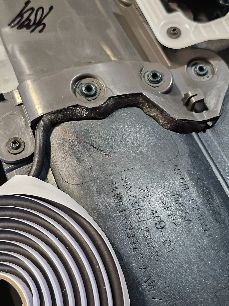

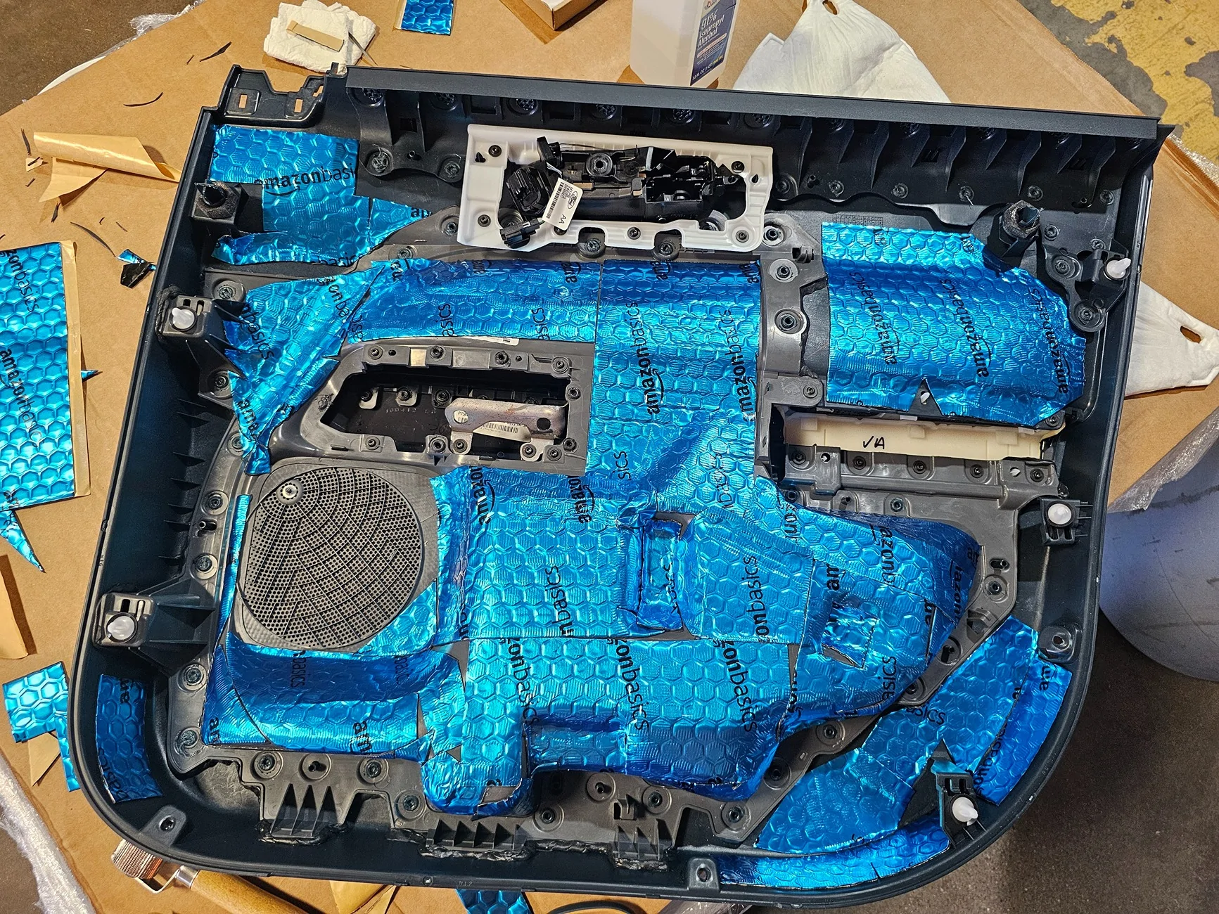

Order sound deadening and butyl rope before you pull your door panels off. Otherwise you will end up pulling them back off to chase down rattles afterwards.

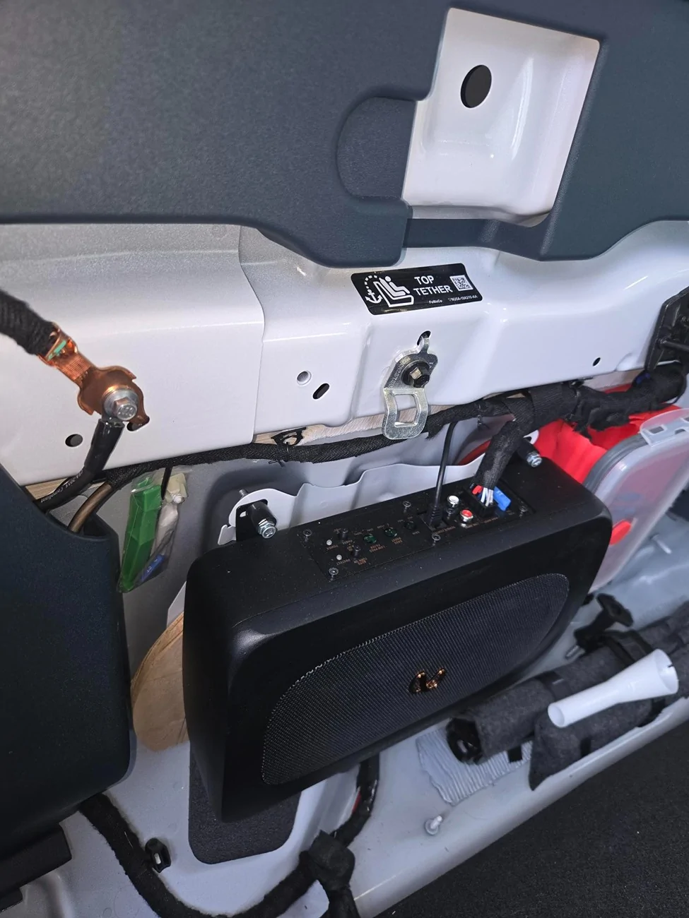

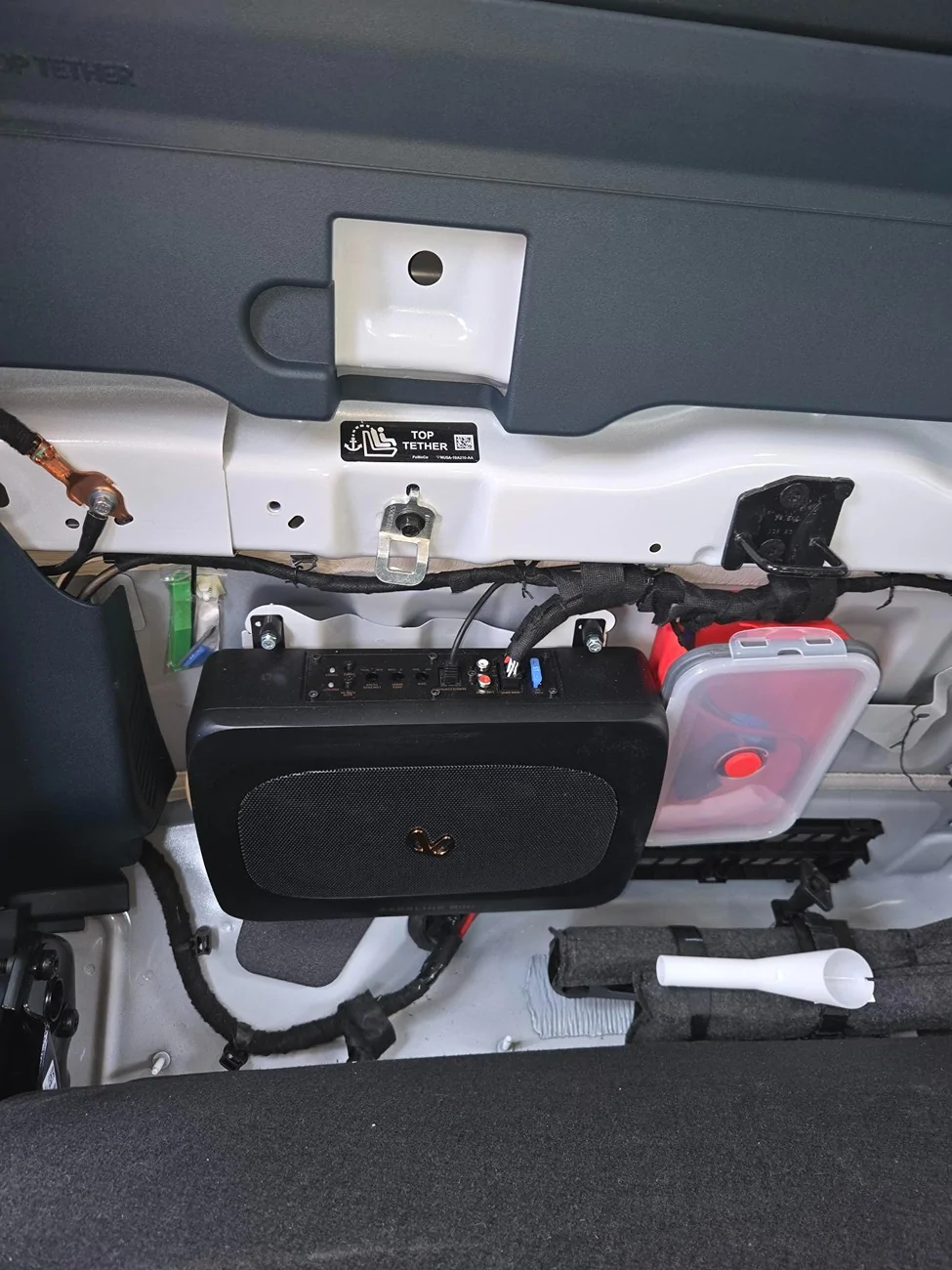

I put a Infinity Basslink Mini in behind the back seat using the empty bracket (as no BO system) (see pic)

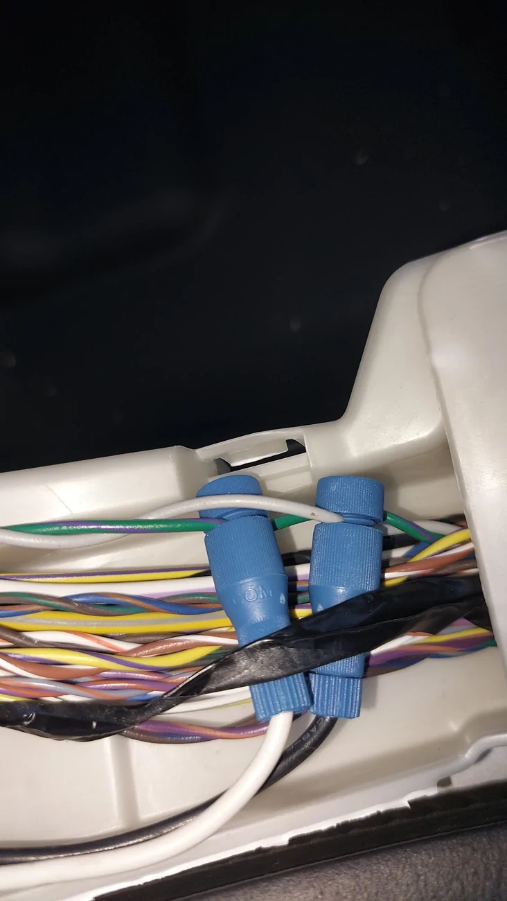

Tapped into rear speaker line. (see pic)

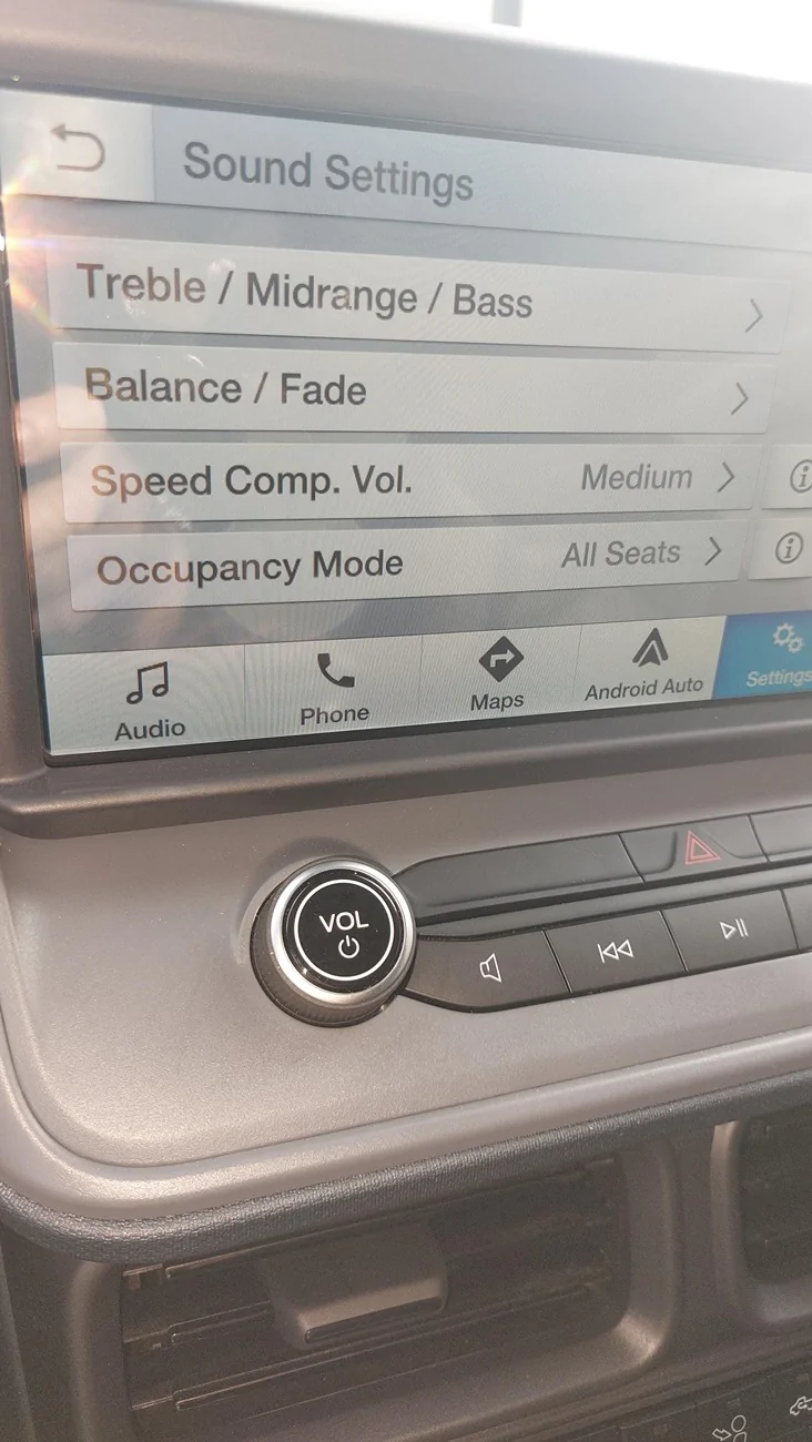

I had only trick issue had to undo Occupancy mode setting back to default "All Seats" the amp would not produce sound until back to default all seats. (see pic)
Good info, kind of thing I'm looking for. Do you think tapping the front speakers would have avoided the 'all occupancy' mode? Do you tap both wires on each side? Where did you run remote to? Nice, clean install without going overboard BTW.
