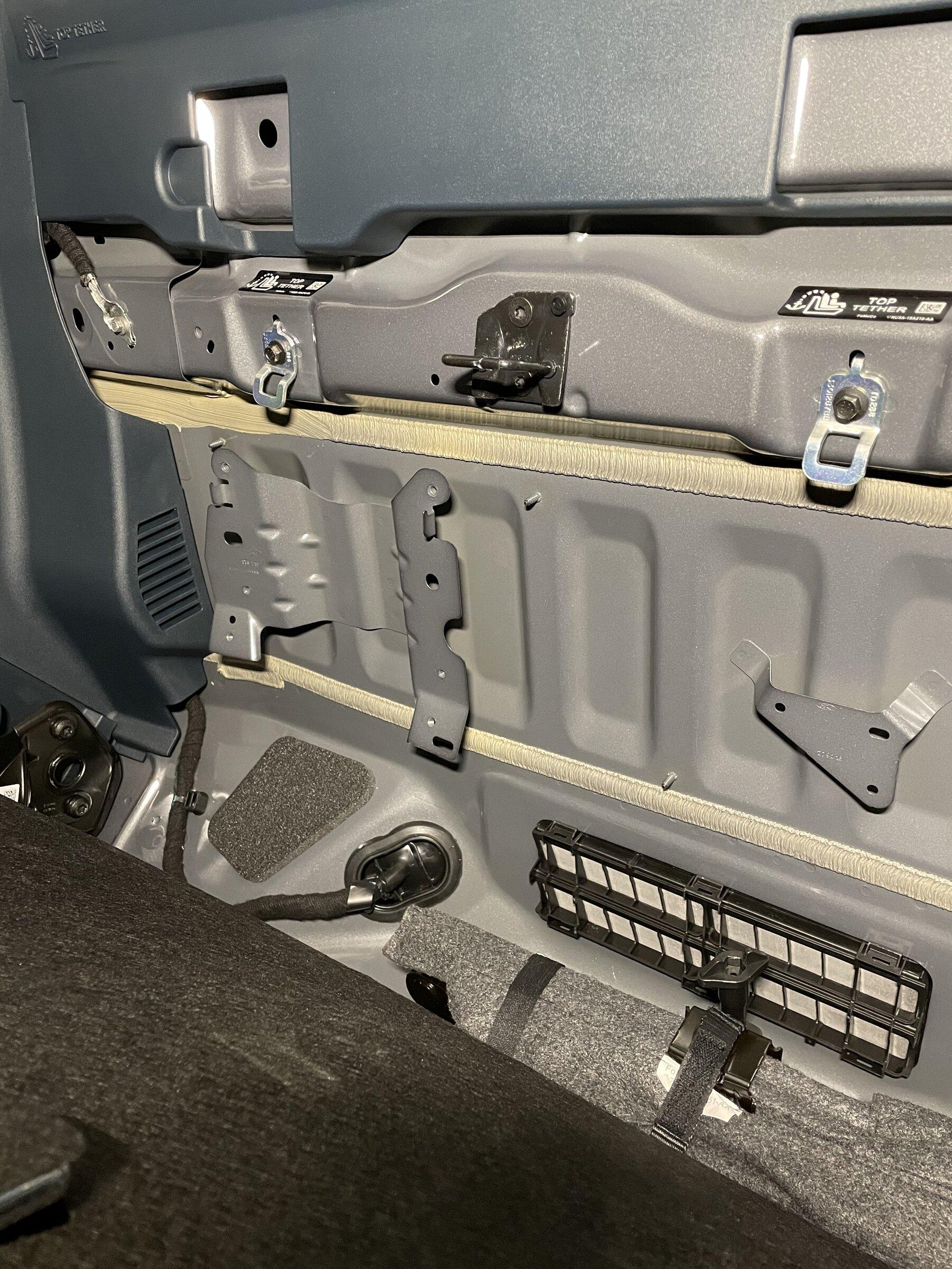

I got the Rockville 10” sub and it won’t fit under the front or rear seat. Looking behind the rear seat I’m a little puzzled. Should I rip these brackets out that aren’t doing anything? Wanted to mount it wood but not sure how to mount the wood without putting new holes in the truck.
secondly I am going to use the high level input (which I’ve never done).Any issues using speaker wire or should I go buy normal 14 or 16g wire for this?

You can break it out of there or mount it using that bracket, if you break it out you can mount a wooden board using the bolts that are coming out (you can also use a thin backer board behind the stock mounting bracket and attach your mounting board to that)
definitely use speaker wire for running the high level inputs, the higher the speaker wire gauge the better

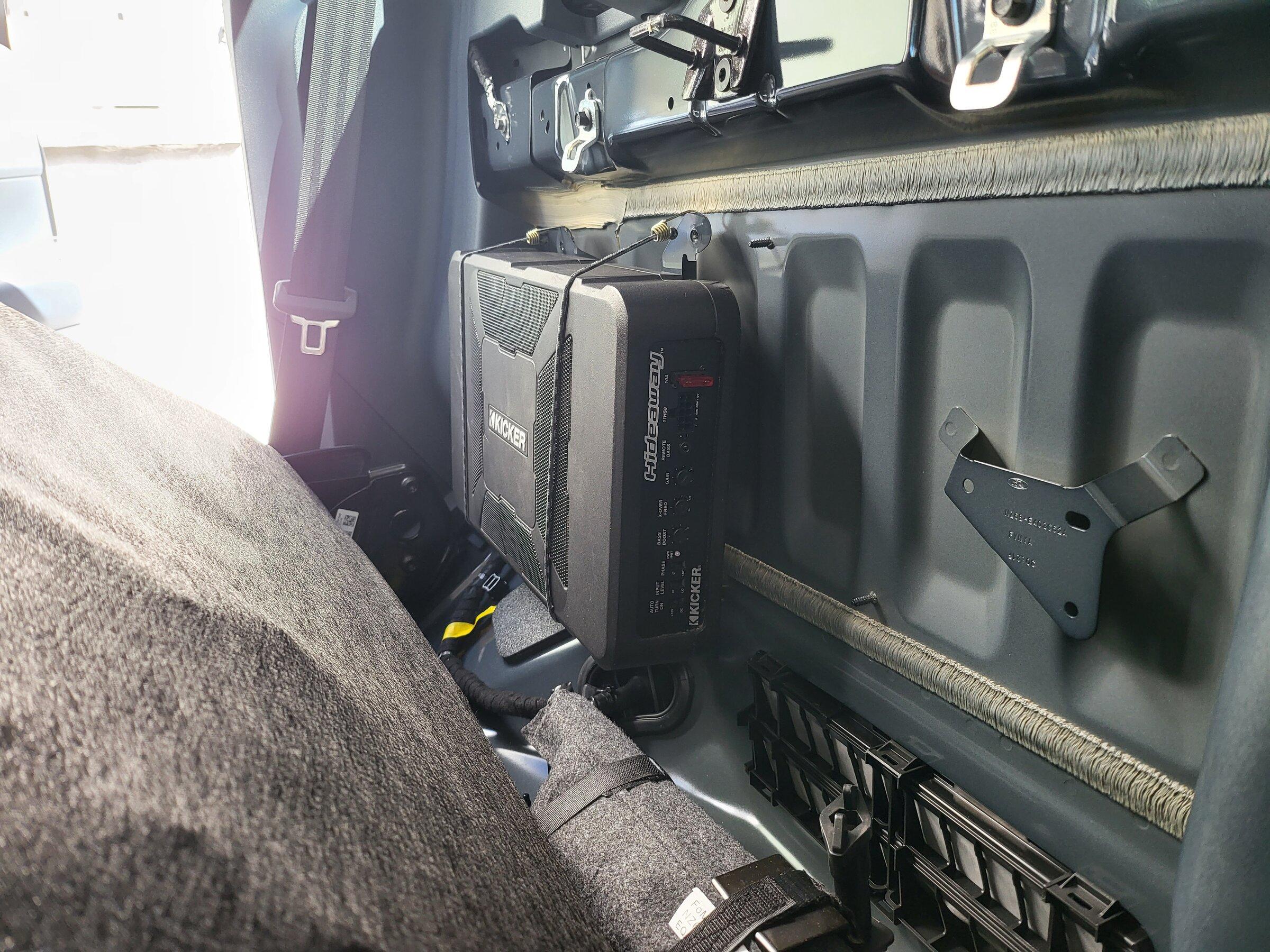

I used the bracket to mount mine with the sub resting on the foam pad below. I bent the bottom of the brackets straight. For wire, I used 4 stranded shielded security cable soldered to the front speaker wires behind the heat and air controls. I don’t know if security cable is the best choice but it is working great. Good luck with the install

Great looking install. Good job!

what size and model is this?

That looks really good. Sadly the brackets on my speaker are on the long ends. You don't get any noticeable vibration from being mounted there?
I did cut some 3" wide 1/2" thick wood and notched around that bracket and screwed the sub in but it's not very sturdy but I don't think it will move with the seat resting against it. Its still ugly
my other thought is to cut some steel brackets that will bolt to the factory bracket and extend out to each corner but again I don't think these 3 tiny spot welds on this thin bracket was made to support the sub/amp, it's about 15lbs. I

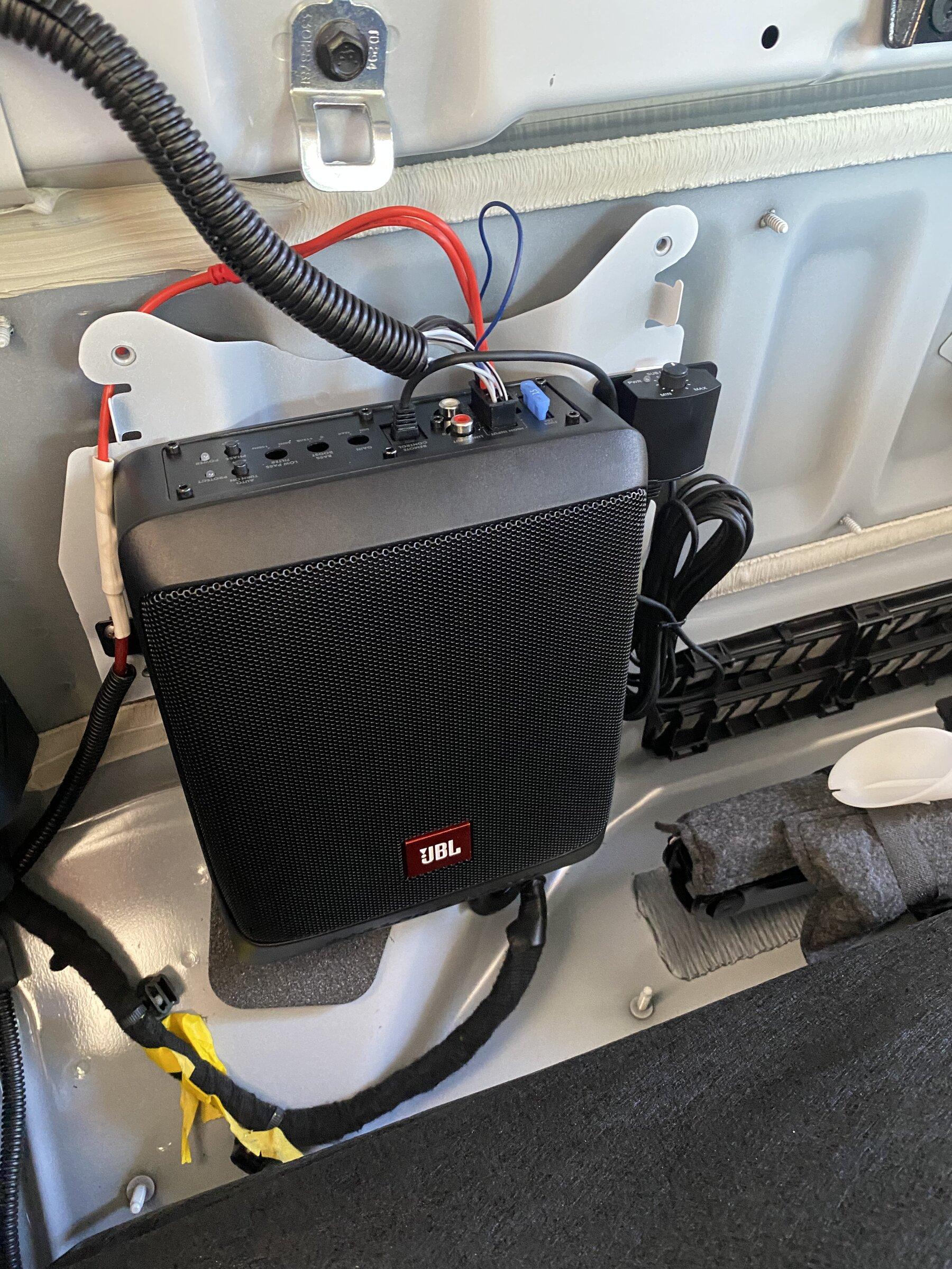

Just some good ol' bungee cord for mine 🤣
I did add foam behind the thin mount & 2 more bungees in an X pattern. Works great no rattles & sounds amazing!
