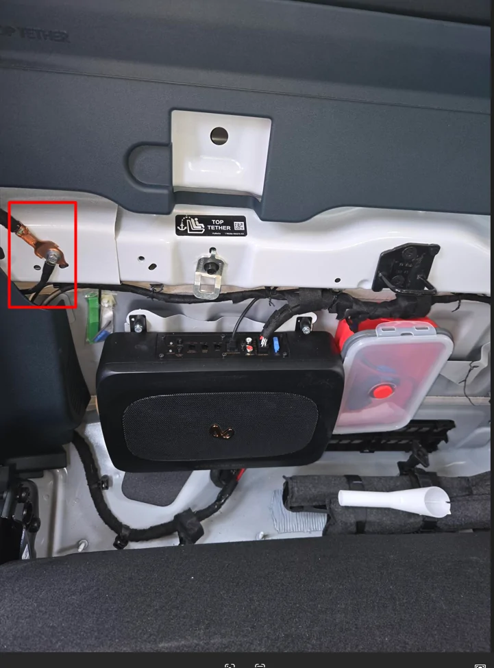

Not sure if still needed as i am late to thread but attached is where i hooked up ground from powered subwoofer/amp to existing ground as mentioned above and it has been working fine
(i dont have rear power window but there was something already tied to it my connection is one coming up not sure what the one coming in from top down is)
