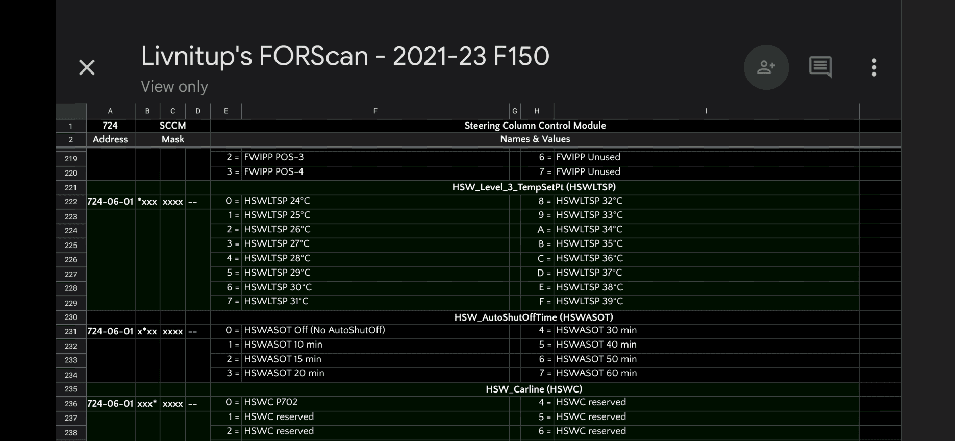

Can someone with ForScan and the heated steering wheel let me know if you have access to these values? If so, have you had any success modifying them? My heated steering wheel times out after like 10min, despite the light being on. It would be nice to know if it could be changed.

I would like to be able to adjust the temp as my wheel gets too hot to handle towards the end of the cycle. I would change it if I knew how. I have a cable and Forscan.

There are temp settings in forscan that you can change. Not sure about the time. I think the wheel heats in cycles; heats up and then goes to a cooling period once a threshold temp is reached.

Welp, I got into the right place and lowered the temp on the steering wheel. I now can feel it get warm but does not get hot before going off. I think I set it to below 30 degrees C.
I made a lot more changes and logged them all so If I need to do it all again when they flash me back to the OEM settings I can do it. I think I will save all the mods and have a back up at hand as well.
FORSCAN is a little bit of a learn but once you do it a few times it is like any other process computerwise. Save your work!
