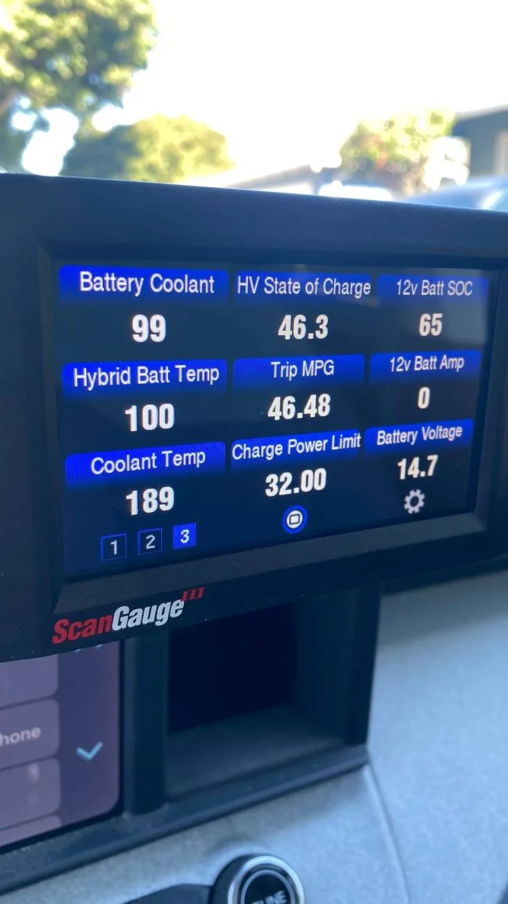

Example of ScanGaugeIII screen.
Pricy, but you don't need a phone or any technical skills. You just plug it it.
And it will show data from about 75 things. Up to 9 at a time that you select.
