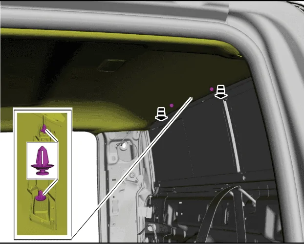

My dealer fixed it in 5 minutes at the 2nd trip for the sag, the tech said they had to adjust the clips where the headliner snaps into, they thought it might be a half hour or 3 hour job but a smart tech knew what had to be done, giddi up!

There should be clips in the center area looks like about the width of the rear window apart that hold the headliner up.
Where can one get their hands on a manual like this?
