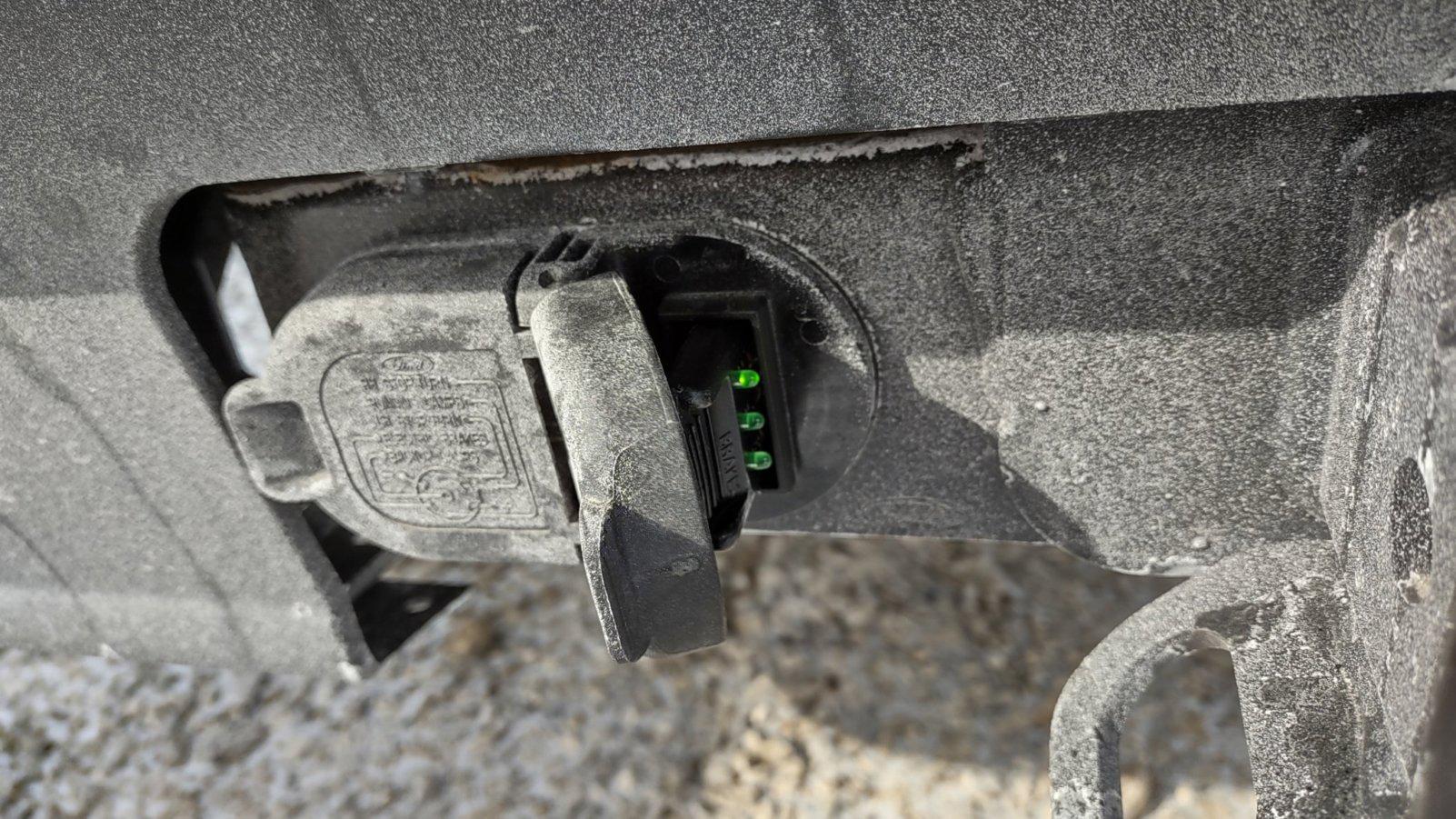

As mentioned by @Finklejag I stopped in at Harbor Freight and got the $3.99 brake light tester, and results are confusing.
Ford Maverick Hate auto start stop Brake Tester
Once stopped, often the little panel indicator will show auto start/stop as disabled and the engine continues to run. But, many times it doesn't disable and the engine will shut down. If I relax brake pedal pressure the engine will start and then the disabled indicator shows again and the system seems to be bypassed. And after this initial cycles, it seems to be bypassed more consistently.
I can't imagine why it doesn't either work all the time, or not at all. But I am intrigued that this seems to be heading in the right direction. Please let me know your thoughts if you have any!
(and of it does prove to work in the long run, I'll trim the molded grab area of the tester down so the 4 pin door and close over it)
