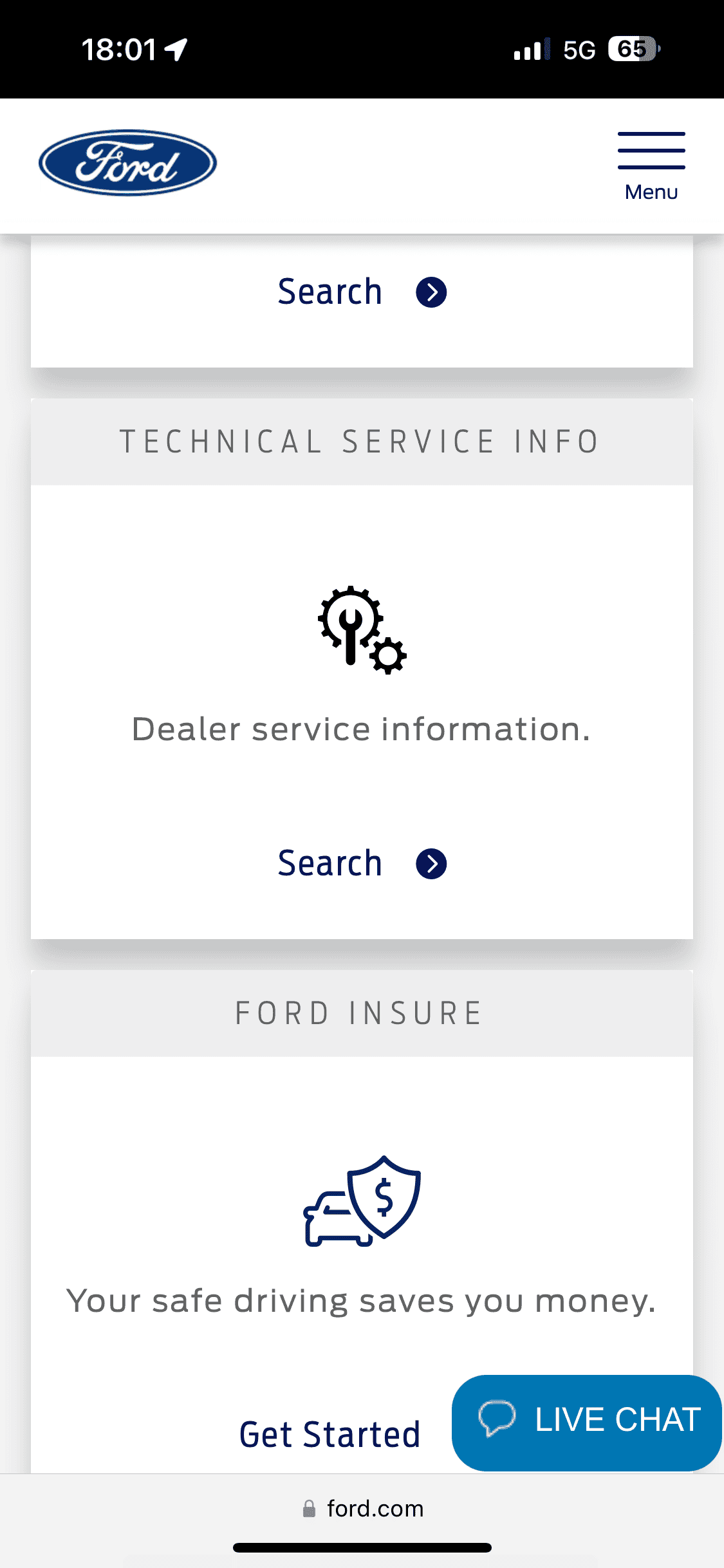

If you create a ford account and link it to your vehicle you can go to your vehicle dashboard. Scroll way down. You can see a lot. Service history, current recalls and a list of TSB’s that are related to your vehicle. Along with other stuff.
Here is a mobile screen shot of what to look for.
