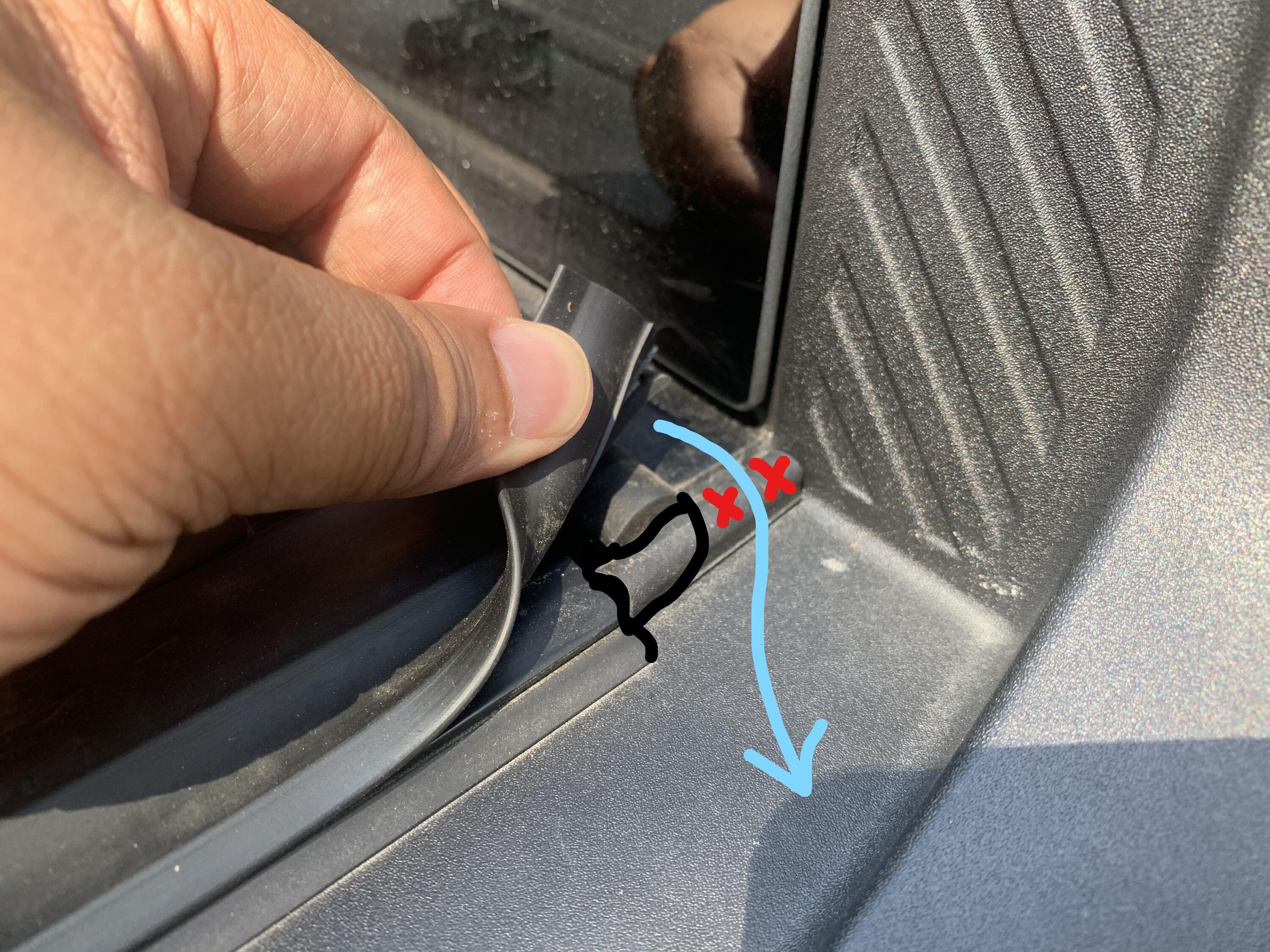

Super thanks. I'm going to take off the cover and rails and reinstall after doing some weather stripping similar to yours. From what I read elsewhere here, looks like all covers on the Maverick have an issue with this area. There will always be water accumulation on the ledge because of the design. I may try to experiment with getting it to overflow onto the plastic rail cover part (as shown below using your photo). I'll likely need to use some RTV silicone to make it as watertight as possible. It likely wont' be the perfect solution since it will trap a few mms of water on the ledge.
Wish there was a way to get the water to drain into the cover rails though (and out the tube). I'll take a closer look when I take the rails off. I have the drop-in bedliner which adds a fair bit of thickness against the cab (and entry points for water to slip behind the bedliner.
That was my exact thought, either let it run left and right out of that back channel. Maybe 3d print or like a rubber ramp of sorts to do it. Only thing we don't want is to trap that water in there.
Saw the Bak X4 install and they actually use a rubber edge upwards all across so it's minimal water going into back channel. Its not bad but someone or something pushes any of it downwards, there's the fail. Might try something along that route as well.
When you take the rails off, if you can do some photos of that back channel and left/right connection area...might give us a better idea of what to do.

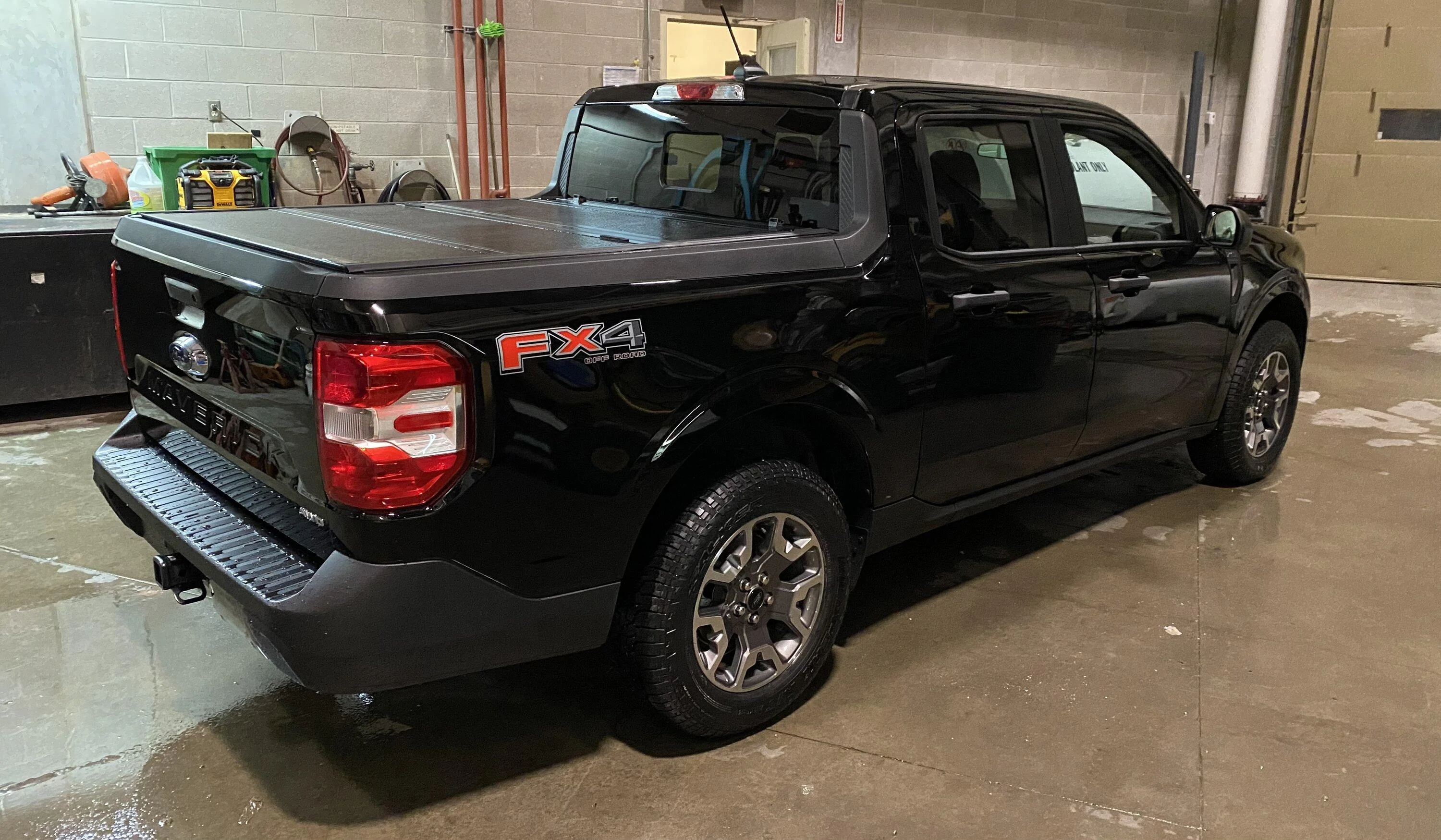

Just installed the Bison cover on my Maverick that finally came. I like it's low profile and low price. A buddy at work has a BakFlip on his truck and it has some minor leaks as well, he couldn't believe the price for pretty much the same cover as his.
I wish I would have found these waterproofing tips before installation. Thanks for the tips, I'll be implementing them soon.
