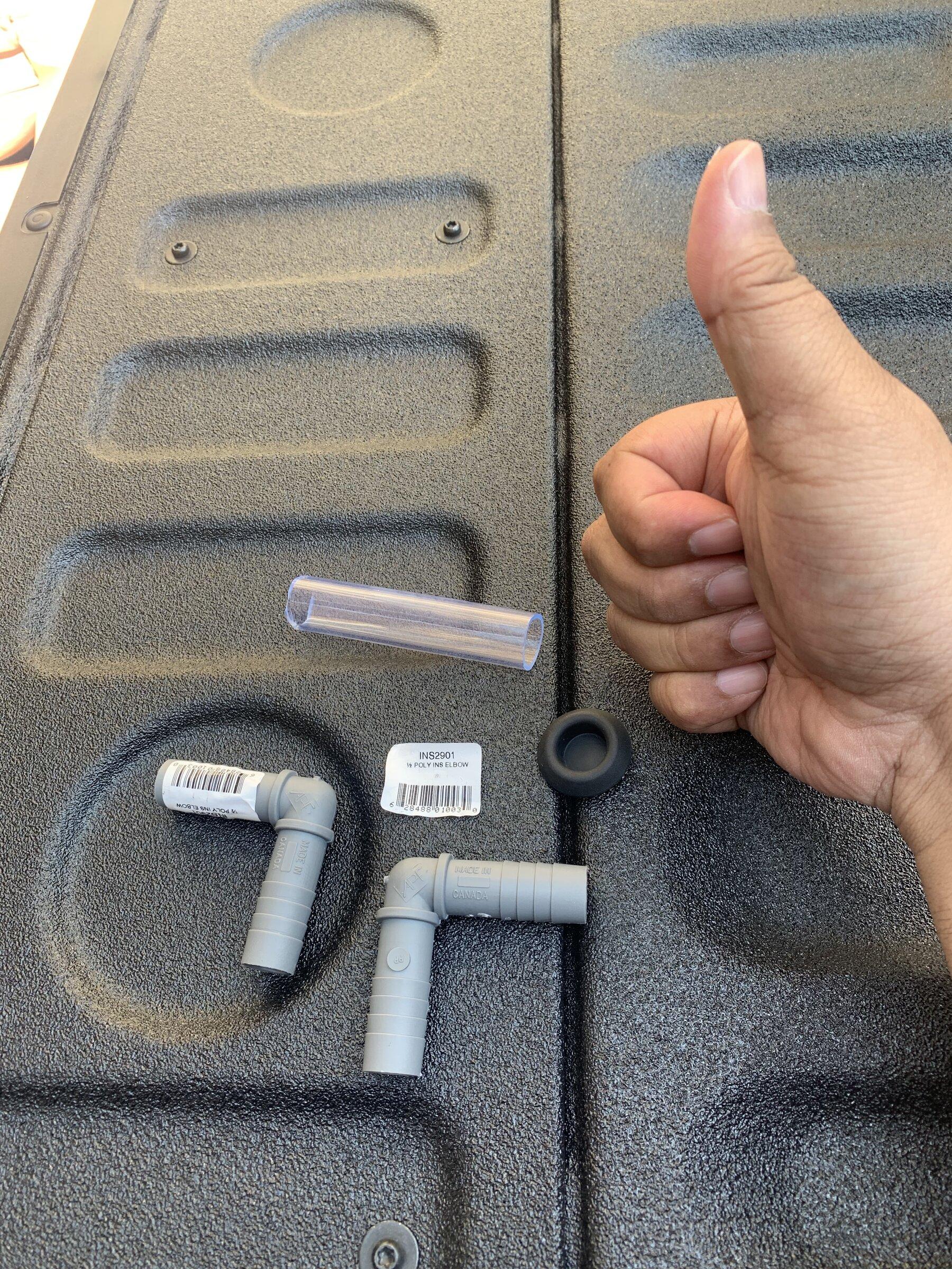

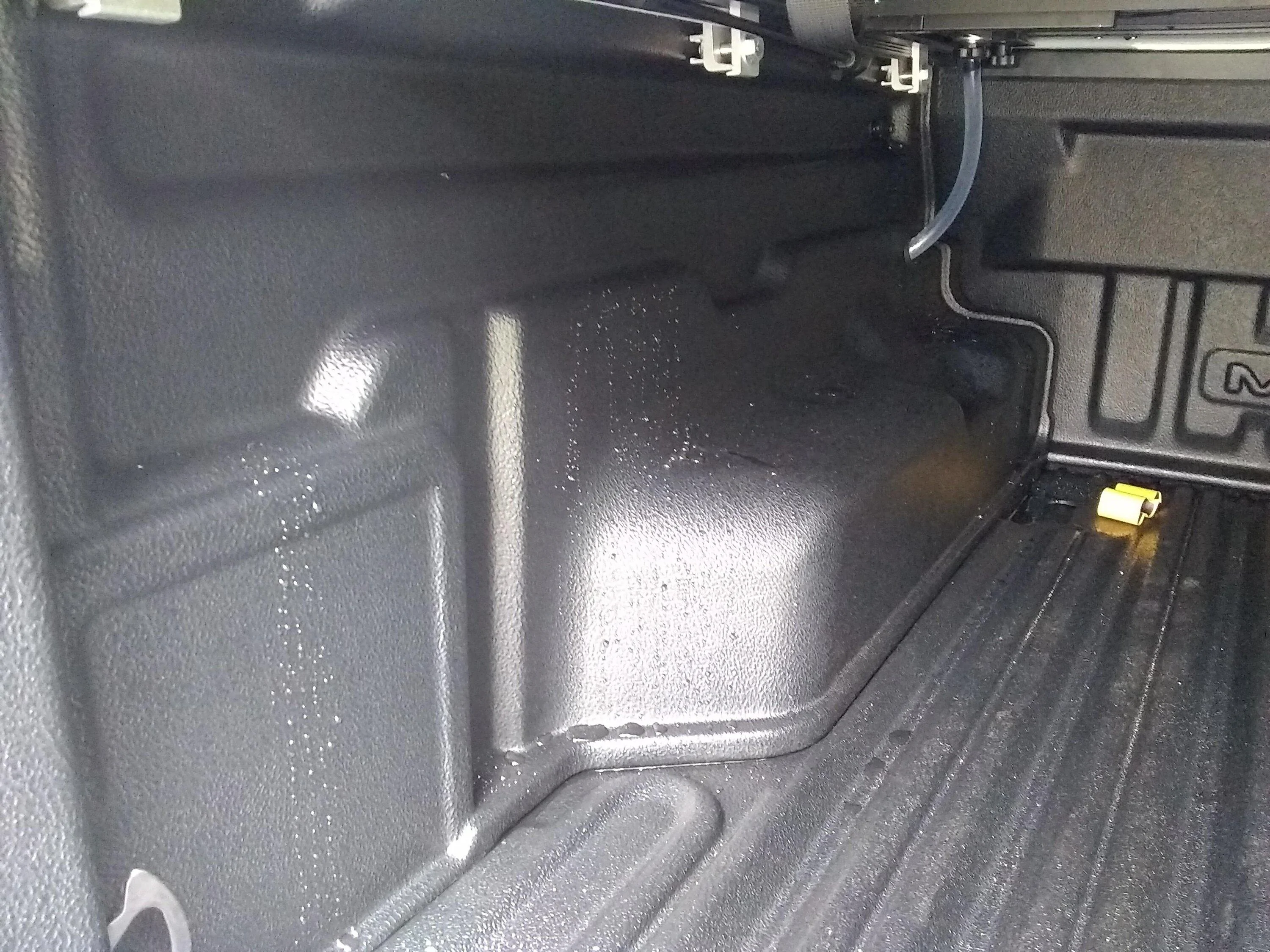

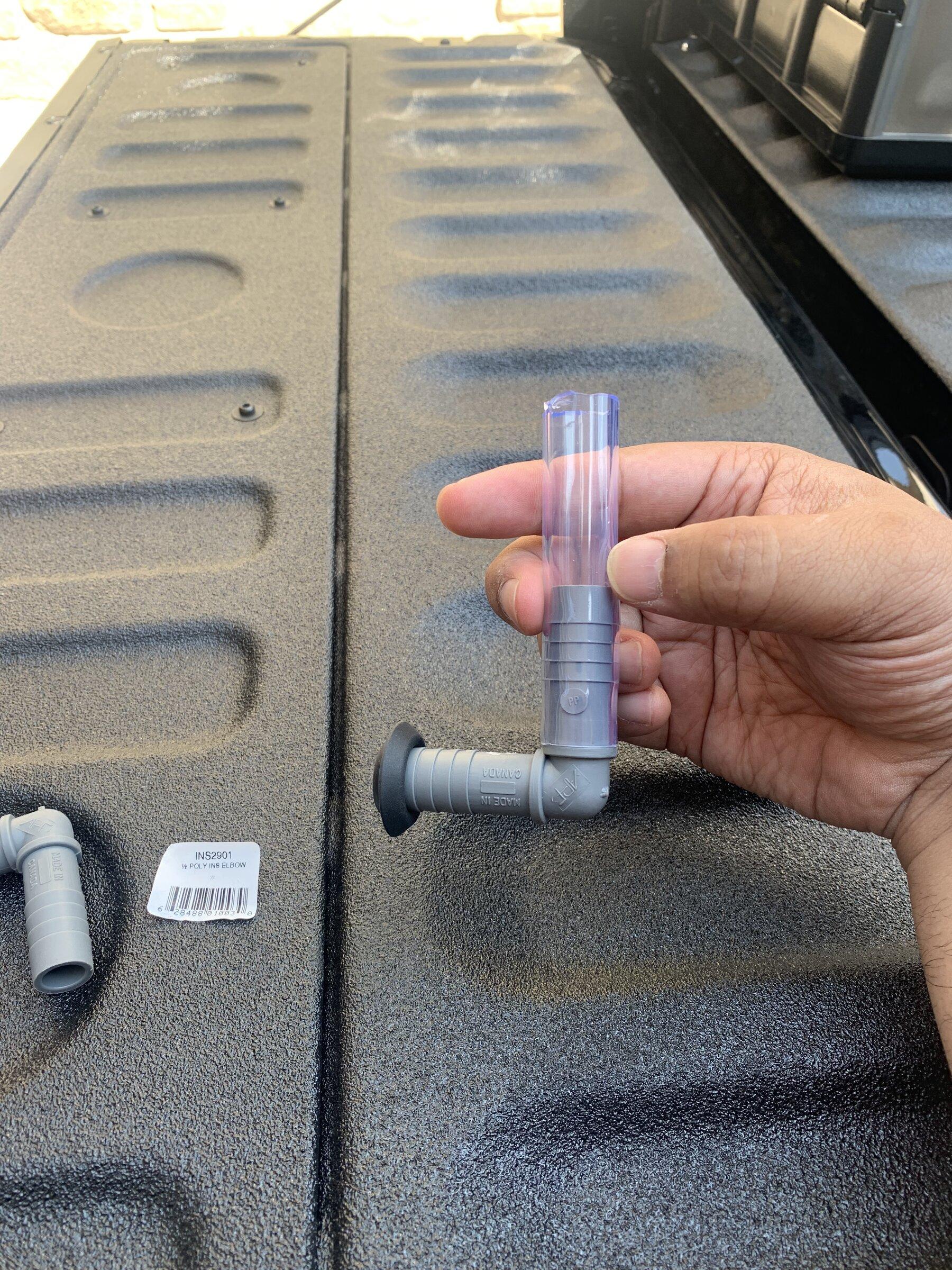

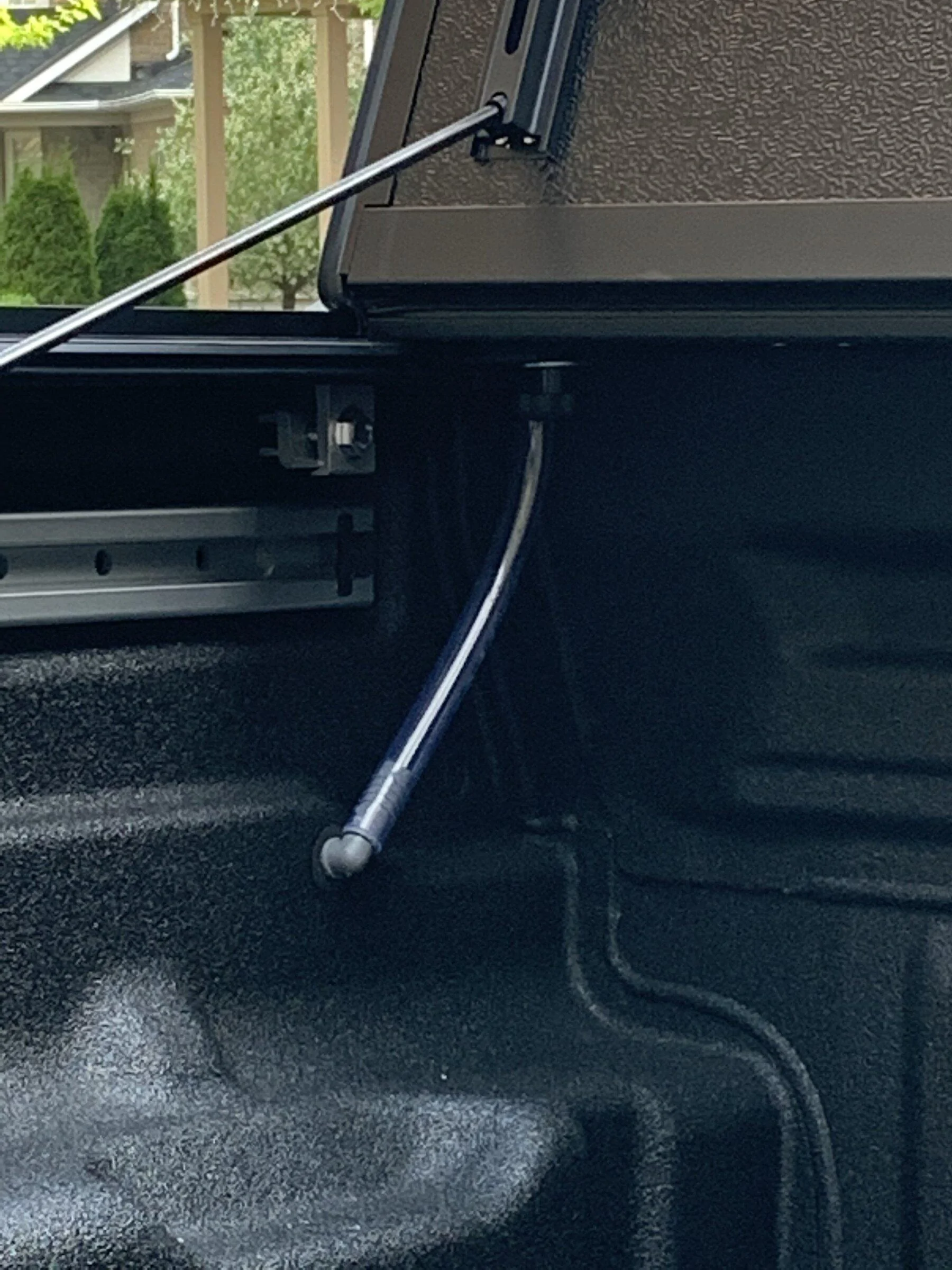

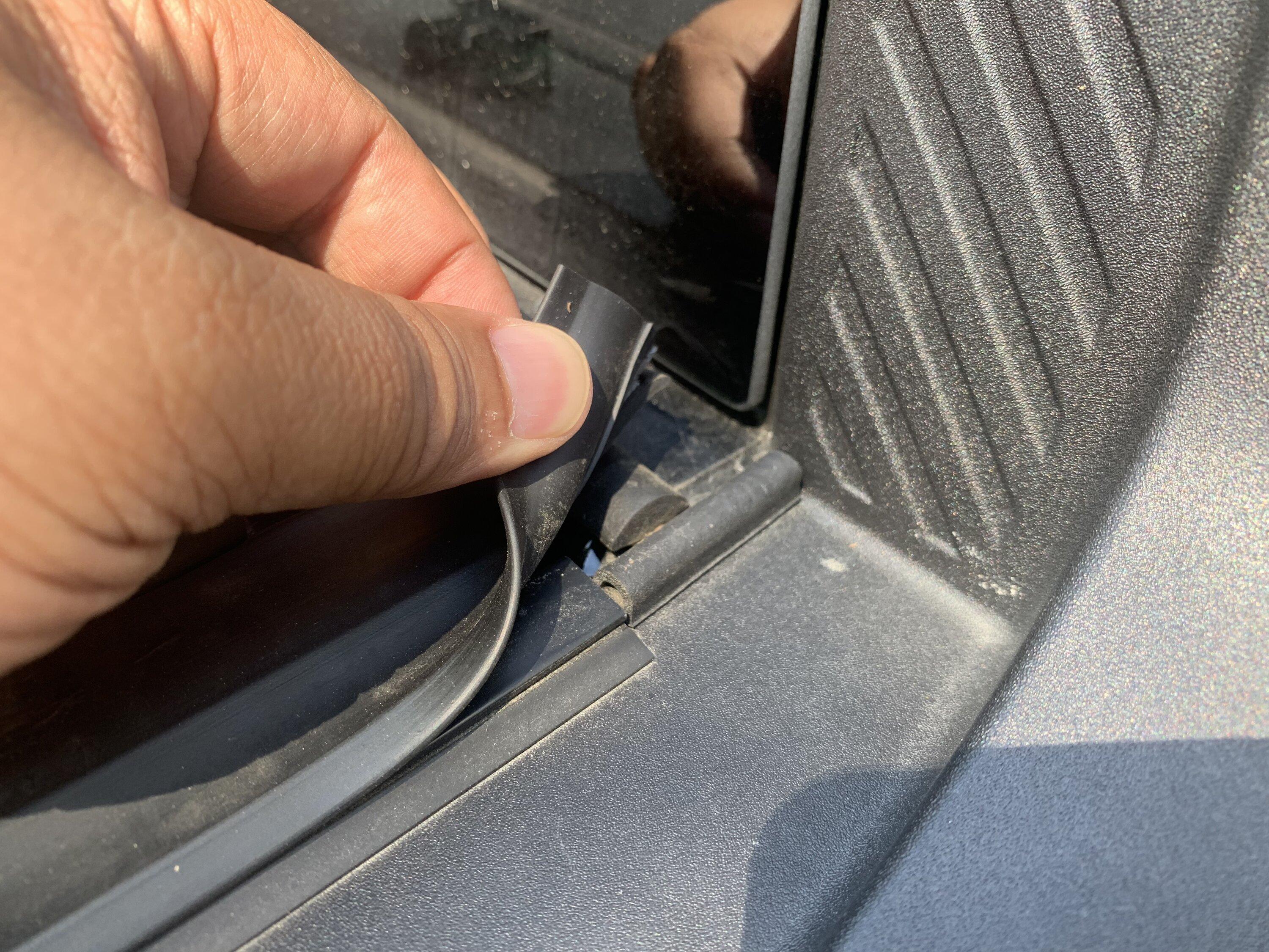

So drain tube update:
Went to Home Depot and bought 2x 1/2 poly elbows (the grey guys). Came out to 2 bucks or so.
Tube fits in as so and the other L part will fit in the hole cover (the black thing). You'll have to make an x cut to
fit it in as well as cut the drain tube to fit.
You can find the hole cover in the photo, about a 8-10 inches down from the tube start.
Put it all together and should work great as it's all tight fitting.
I'll send a photo of the finished later.
