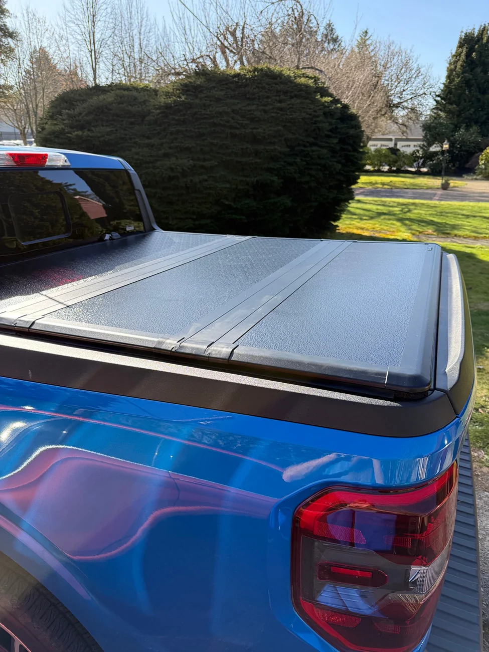

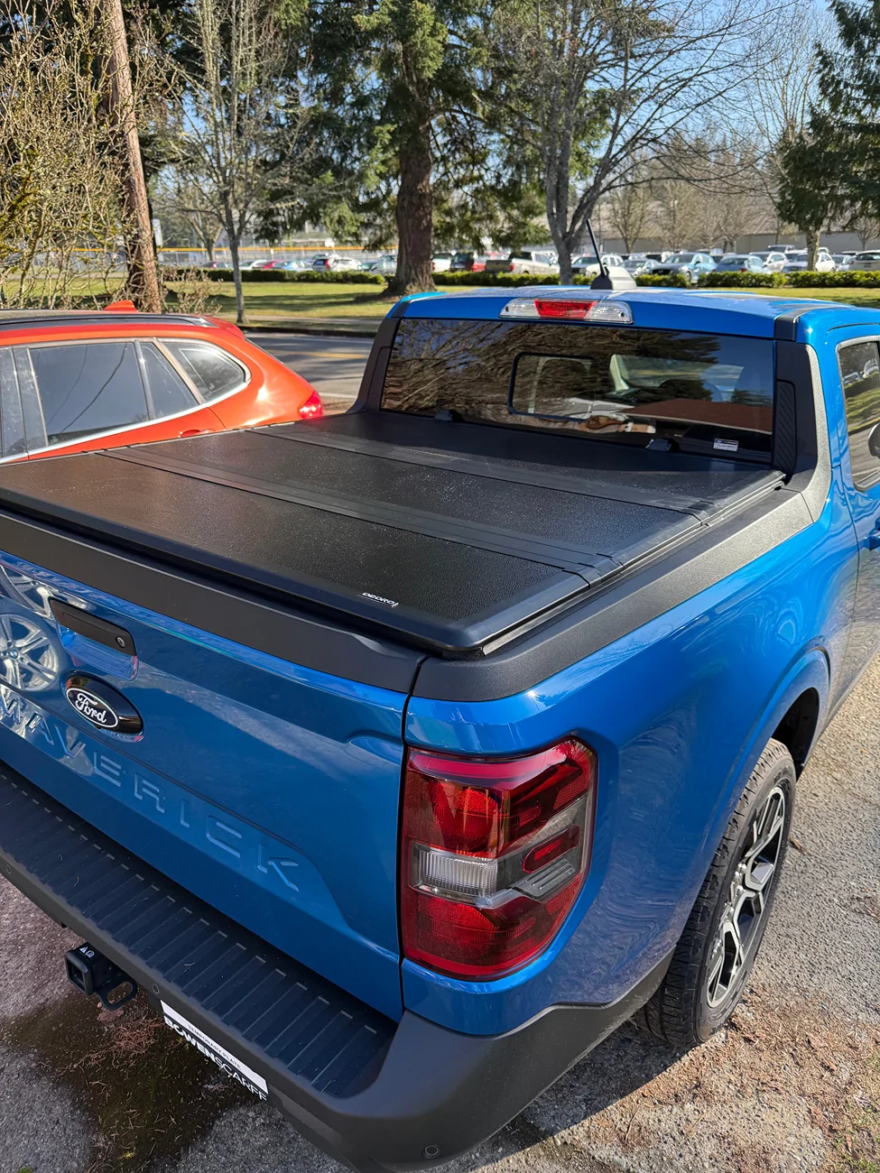

Just to throw this in the mix. I have been using the Oedro tri-fold hard cover I got off eBay over a year ago.
There are various others using them on the forum. So far it has been great! No issues. Get barely any water in the bed even during a real gullywasher.

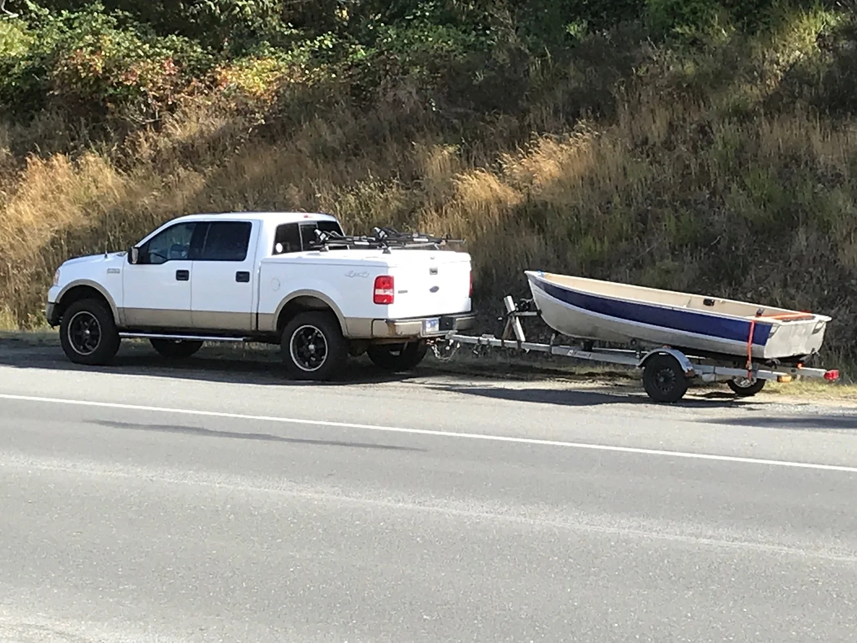

I have a DiamondBack cover and it's pretty good but not perfect. I still think it's a good option and would buy it again. It provides the security I want while traveling and camping. I also mounted T-slot rails on top of it to attach cargo cross bars to haul bikes or a hard sided luggage carrier. My biggest complaint is that it's not as water proof as I had hoped. I get leaks dribbling down the sides of the bed at the break in the cover seal where sections meet and at the expansion joint in the Maverick plastic on top of the bed side. Here's a poor quality picture of my camping setup with bikes on the cover.
I did a similar setup on on old F150 with the Lund hard cover, and a Yakima permanent mount system, and it was a great solution. Lockable, lighted, etc, and strong enough to stand on when loading bikes or gear. My Mav came with the dealer tri-fold tonneau, but I'm considering options to add a similar low-profile rack system.

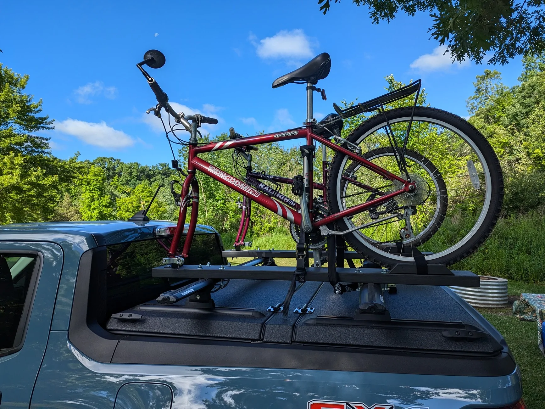

Care to share some pictures of your bike rack setup? I'm looking to do something similar
This is the best picture I have right now. The 2x6s are held to the Rhino Rack cross bars with U-bolts. The fork mounts are from Amazon and bolted to the 2x6. The rear wheels are sitting in a channel made with 2x2s and held with velcro straps. The frames are also tied to the 2x6 with ratchet straps and a security chain goes through both bike frames and around the 2x6s. Not the most elegant setup but it does the job.

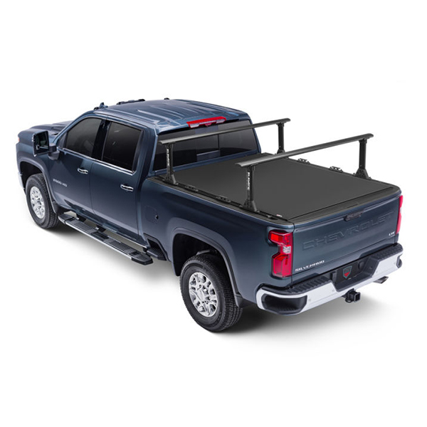

Yes, I'm expecting to either have to replace the tri-fold with a hard cover, or considering options like the Truxedo Elevate. That one would work well for my 13' inflatable boat, but not be ideal for bikes or a cargo box unless I could drop it right down to the level of the bedrails.

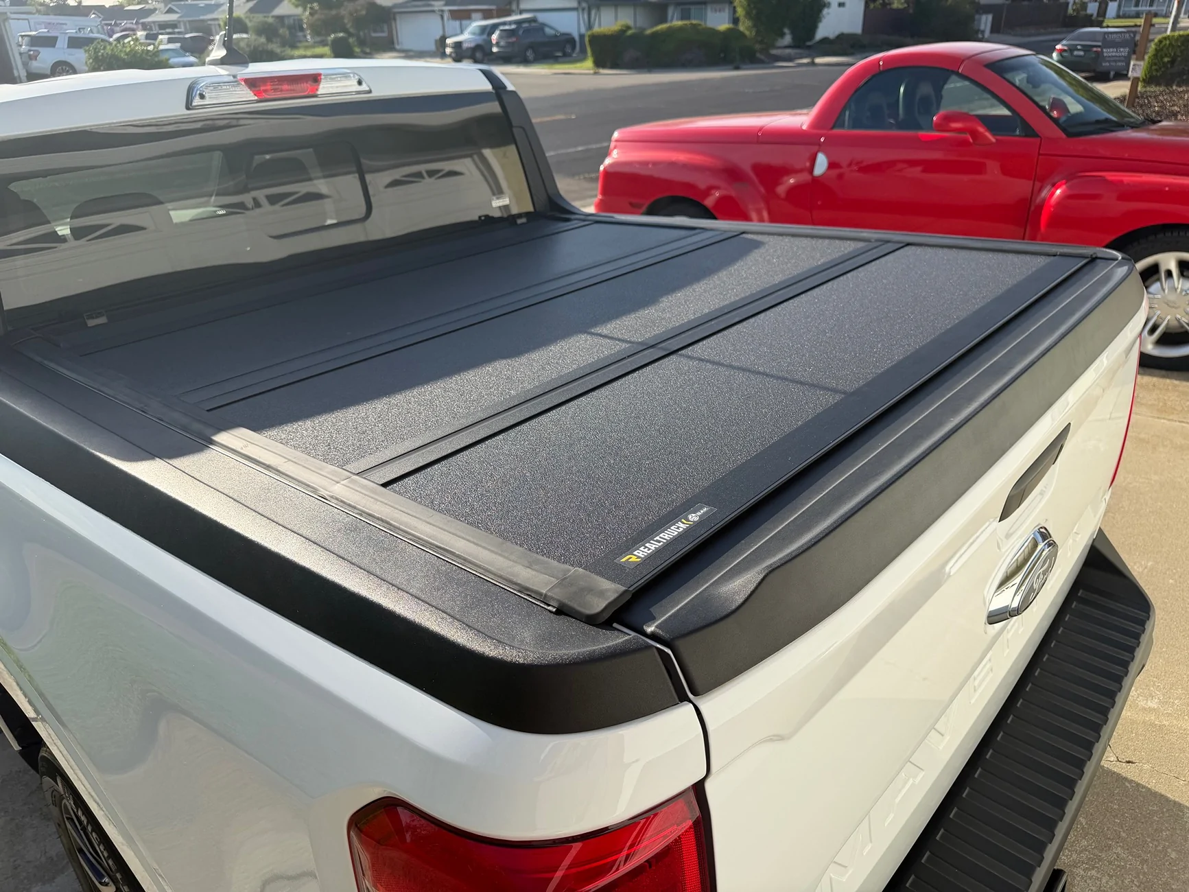

I have the Real Truck Bakflip MX4 Gen 3 . It’s a low profile folding hard cover.
I’m happy with it.

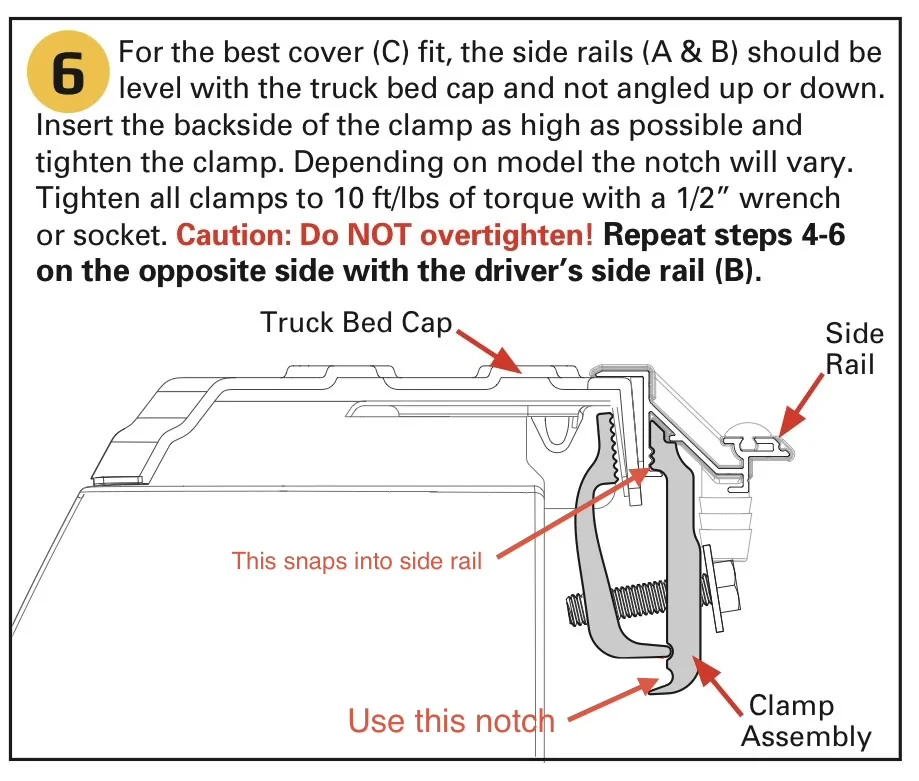

Something I hadn’t noticed right away is that bed rail clamps do not interfere with sliding the clips along the stock cargo rails.
About those clamps, I found the notch specified in the instructions didn’t allow the clamp/rail to fit properly. Use the bottom notch. Also while one person might install the side rails it is much easier with second set of hands.
Real Truck is coming out with a new version that has levers to release the panels, instead of pull cords. It also incorporates torsion springs to assist folding the panels.
