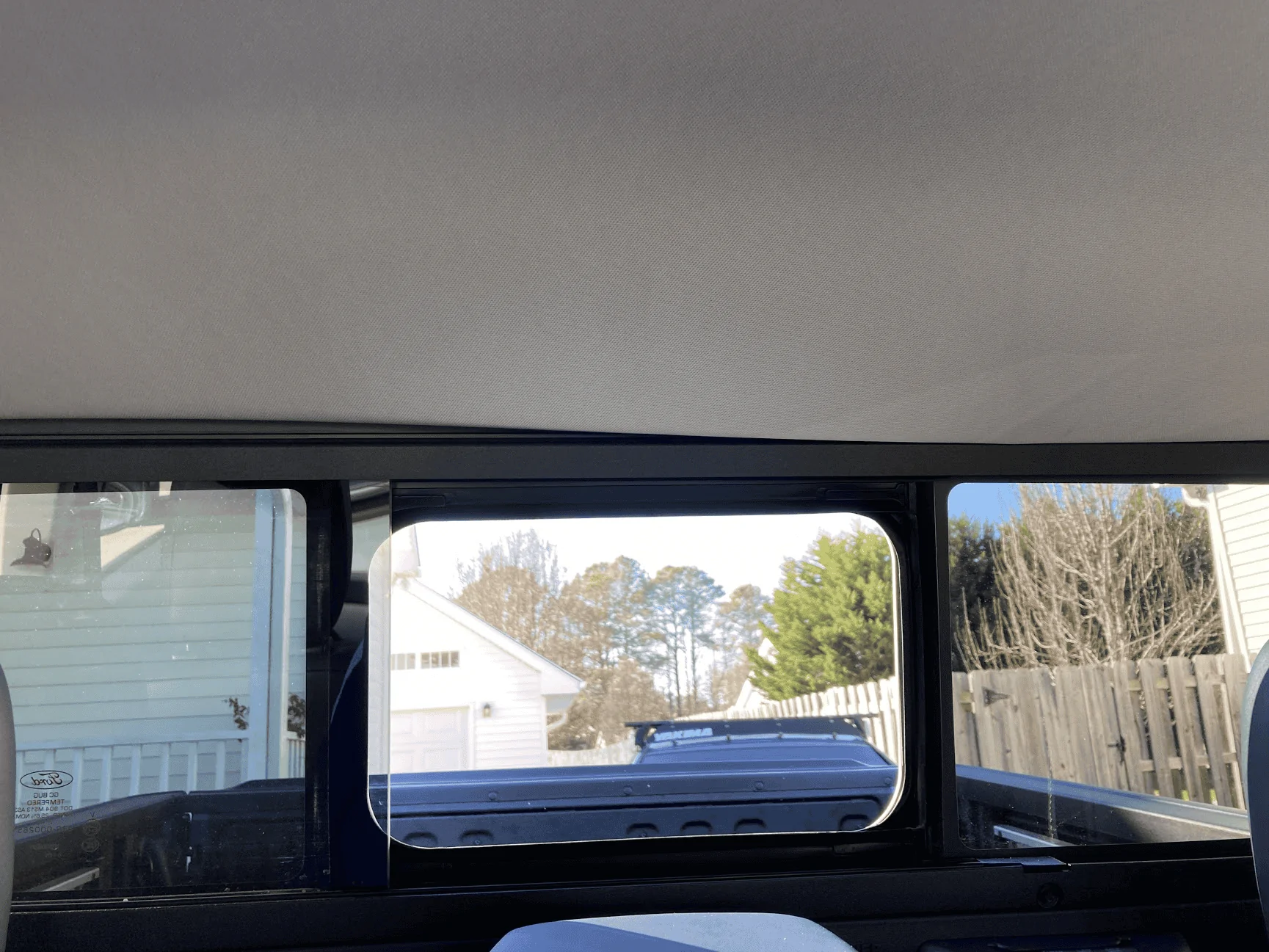

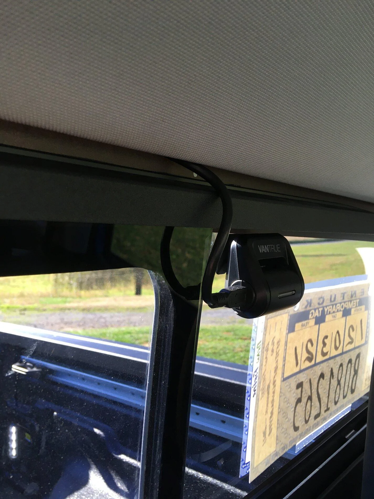

Won't your sliding rear glass impact that placement of the rear dashcam? I figured it should be on the other side.I installed a front and rear camera yesterday.

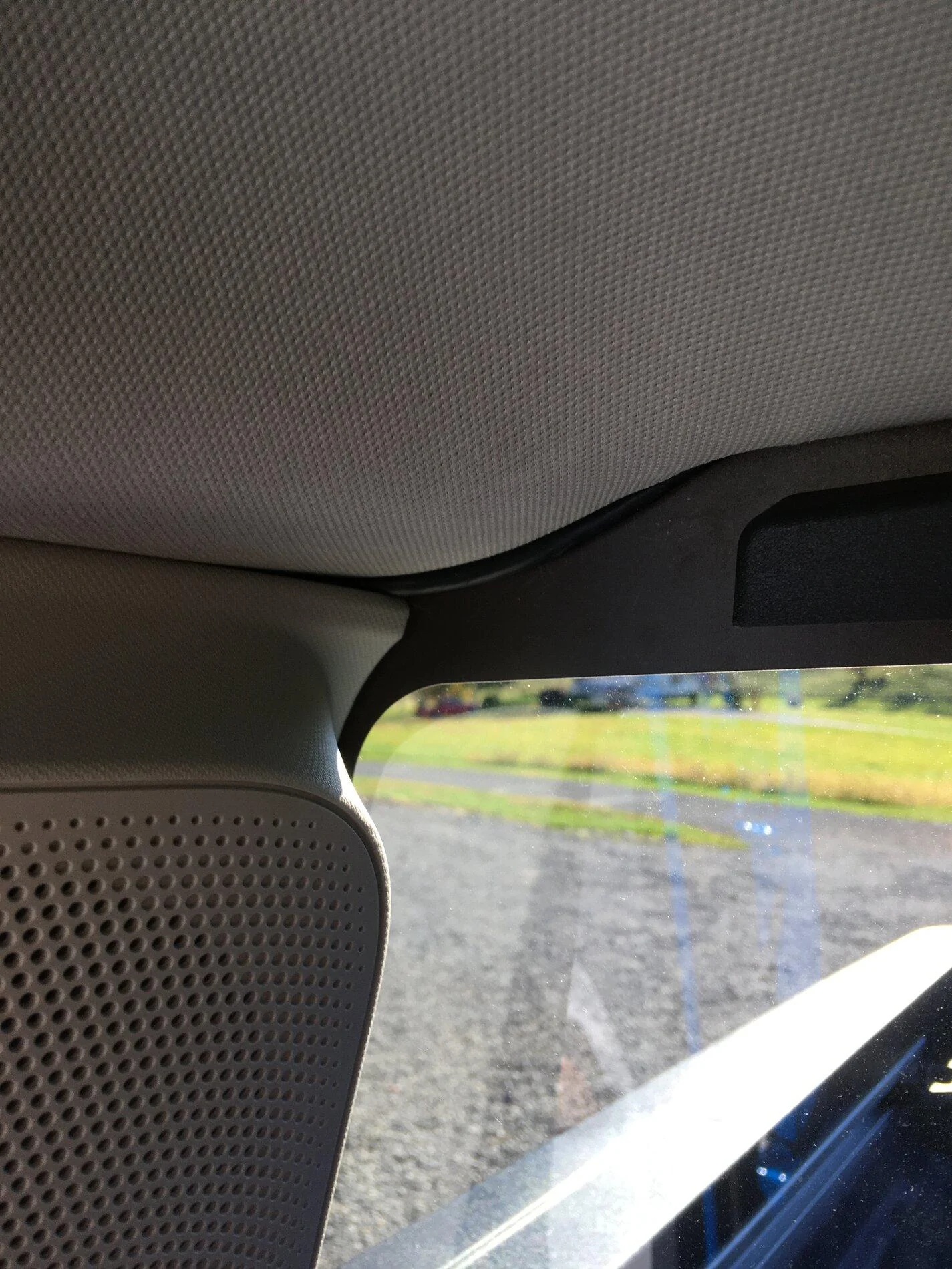

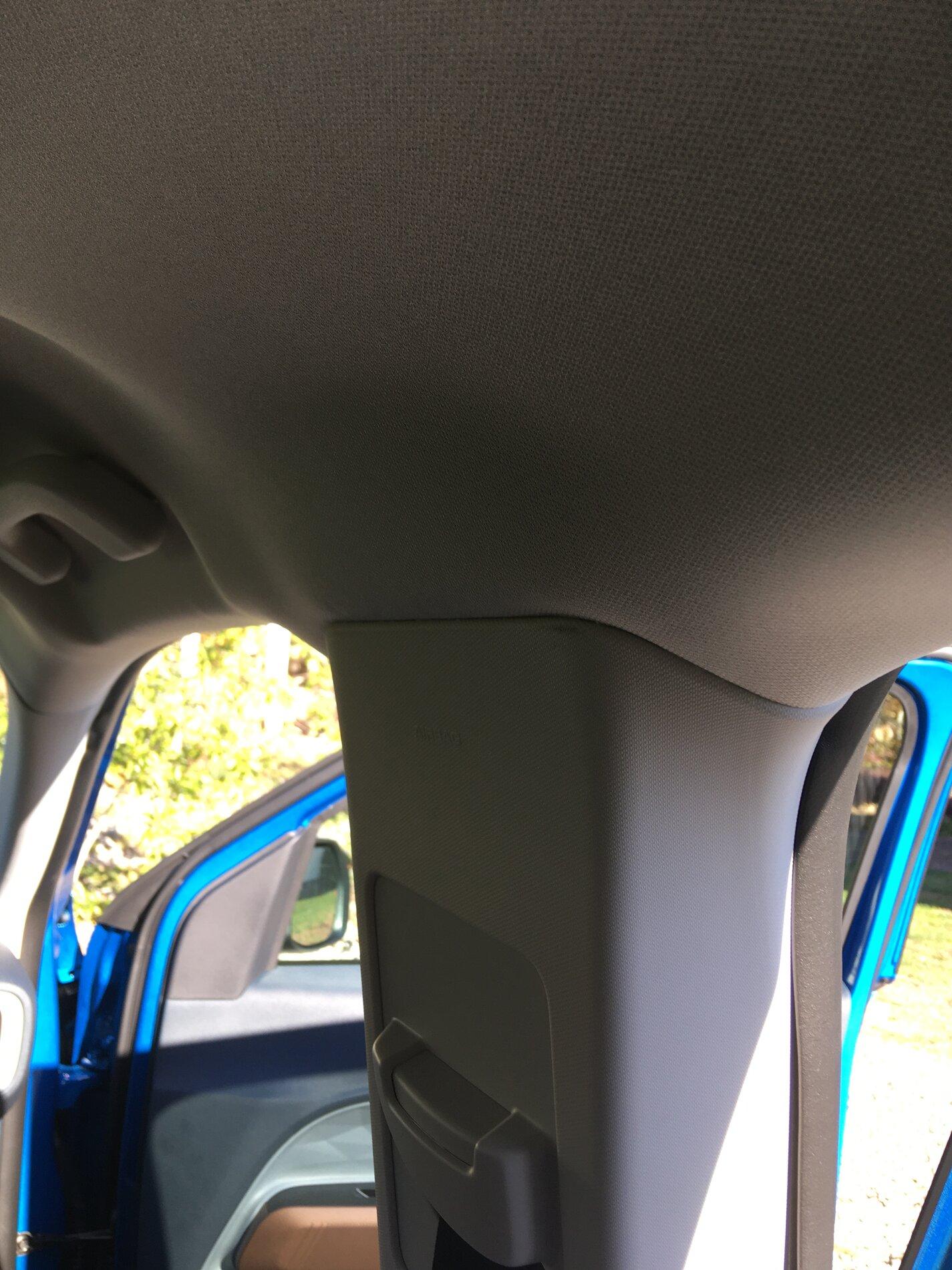

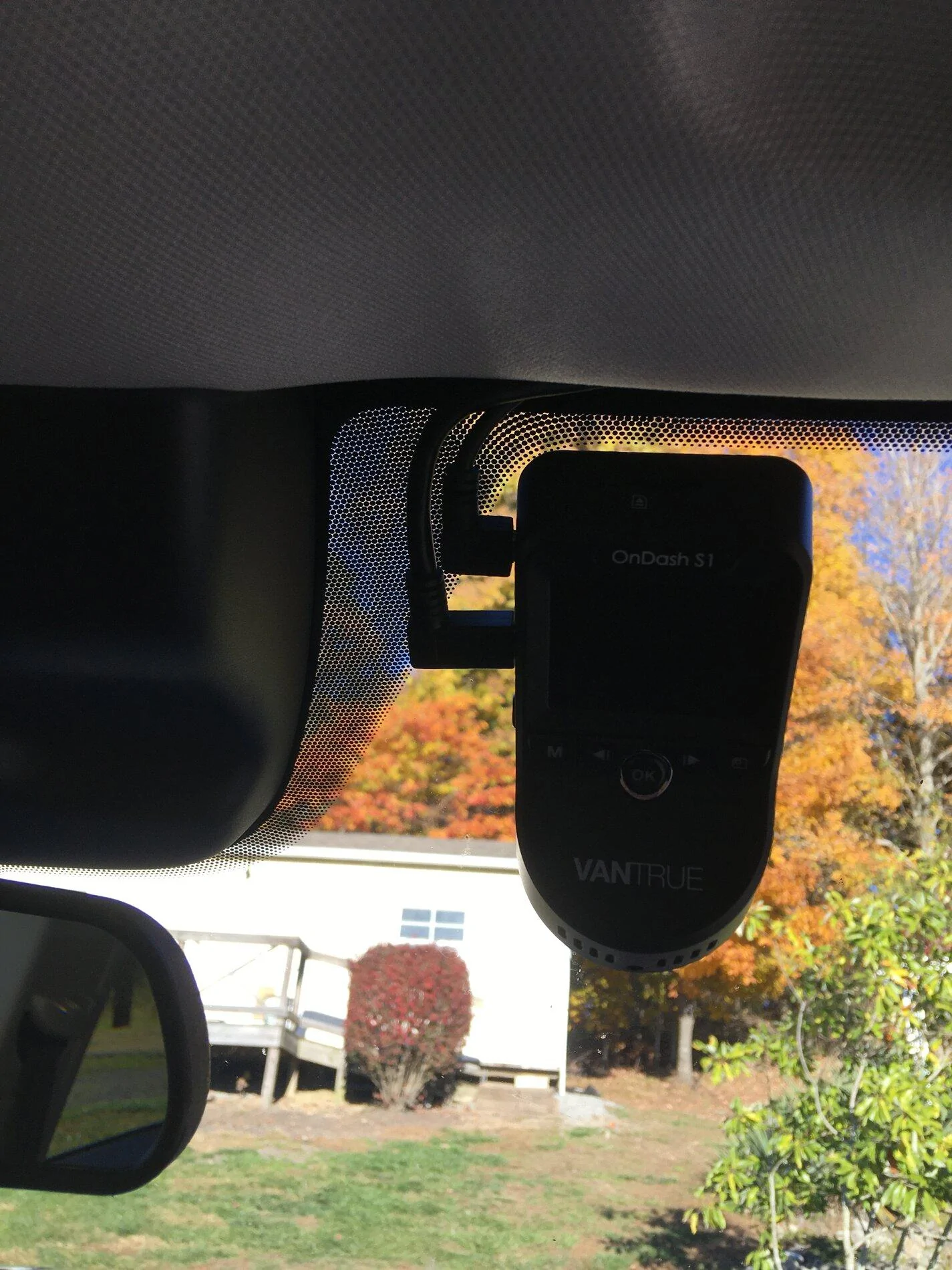

I have included a few pics of the finished product. The only tools I used were two small trim tools designed to loosen the trim without scaring. You can pick them up for less than 10 bucks at any automotive store or online.
The only spot I wasn’t able to totally hide the cable was in the back passenger side corner. I think if I had stayed at it or had a second set of hands I’ld got that tucked away too.
This was done without removing any of the trim or headliner.
I was able to tuck the cable up and behind the trim as I worked my way from front back.
