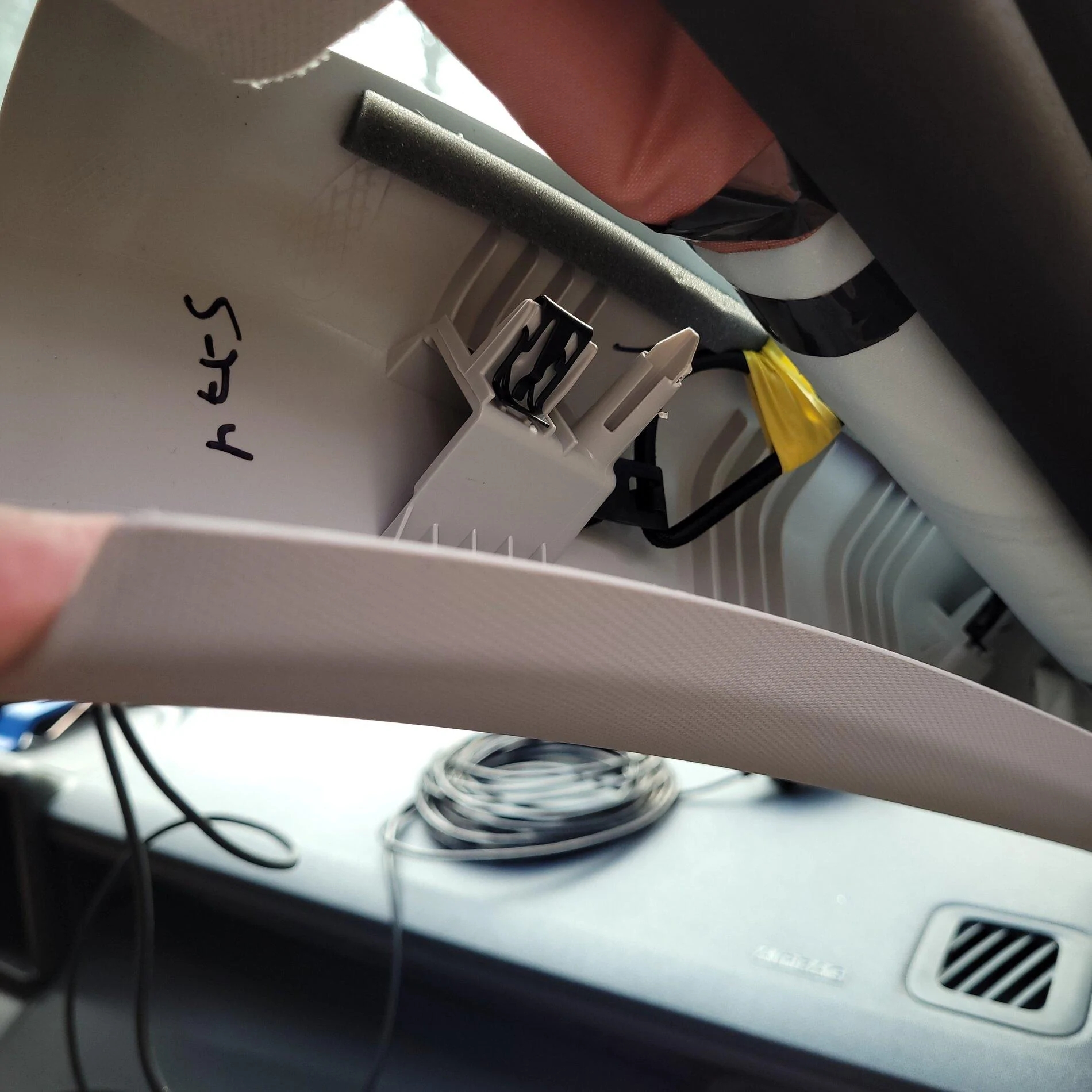

I installed a front and rear camera yesterday.
I have included a few pics of the finished product. The only tools I used were two small trim tools designed to loosen the trim without scaring. You can pick them up for less than 10 bucks at any automotive store or online.
The only spot I wasn’t able to totally hide the cable was in the back passenger side corner. I think if I had stayed at it or had a second set of hands I’ld got that tucked away too.
This was done without removing any of the trim or headliner.
I was able to tuck the cable up and behind the trim as I worked my way from front back.

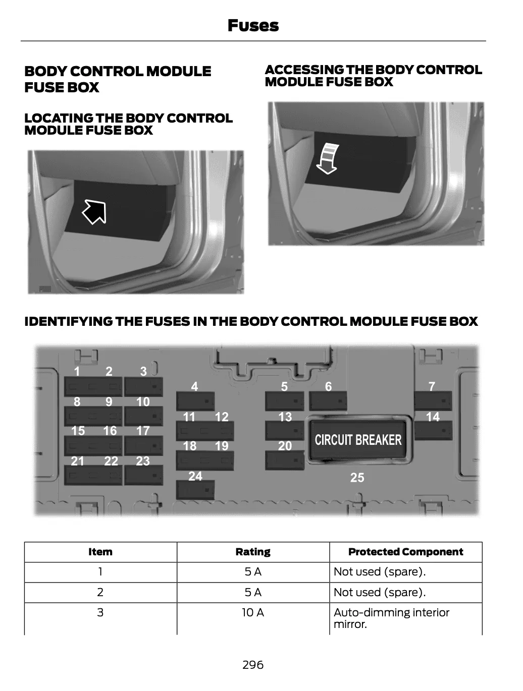

I just finished mine today. I ran front and rear like The Weatherman and tucked up wiring just above headliner like him. I also had that small spot in the rear corner that I couldn't tuck up, but haven't tried too hard as it doesn't bother me since it's hard to see with the black behind it.
I tapped into the #2 fuse slot in the fuse panel under the glove box. It's unused, so it's a good place to tap into. I tested it with a multimeter and it is powered with ignition.
Question about your tapping into fuse #2.
So that's a 3-blade Micro3 fuse type, do you simply put in a Micro2 fuse on the appriate side for #2 load (middle is common line?) and leave the #1 load slot 'empty'? I guess you need an extra 5-amp Micro2 fuse if you're using a fuse-tap so that both fuse slots are filled, since you aren't re-using the Micro3 fuse?
EDIT: Oh the plastic housing standards for Micro2 and Micro3 don't work together. Do you use one of these one of these (two sides) or one of these (one side)
I also tested 1/2, 8/9, and 15/16 Micro3 fuses as also powered by ignition.
Otherwise it seems only #3 and #6 are the default Micro2 fuse slots that are powered on accessory/ignition.
What does "Extended Power Module" mean I wonder.
