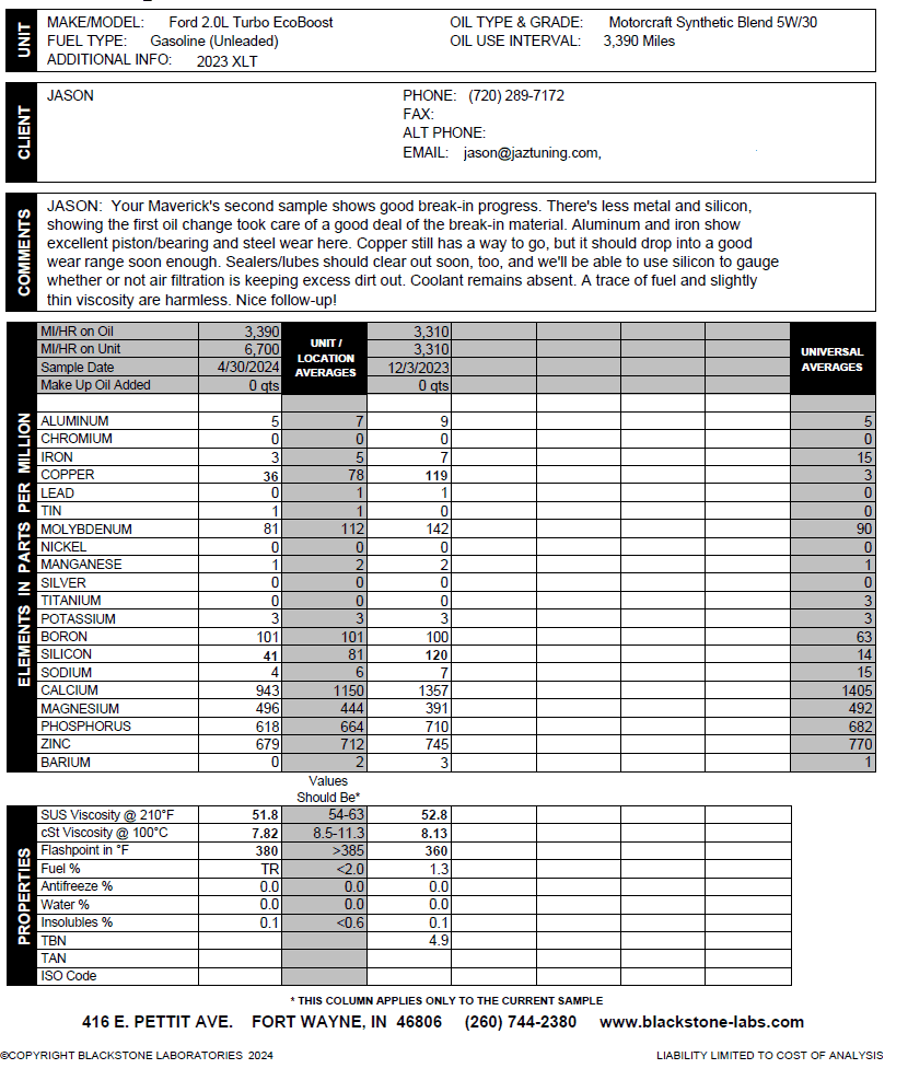

Aks them specifically what oil and what the extra additives that are used in it are. Then ask them for proof.
Because Blackstone has proved that to be BS. Just one post for proof:
https://www.mavericktruckclub.com/f...ut-break-in-oil-in-the-2-0l.46798/post-819750
FORD is not using anything special.
It's not dye, it's not additives. It's just assembly lube/greases. There is nothing wrong with changing early. There is nothing wrong with running it for a normal interval.
Entirely too much bad info being passed around from someone that heard it from someone that heard it from someone that made it up.
