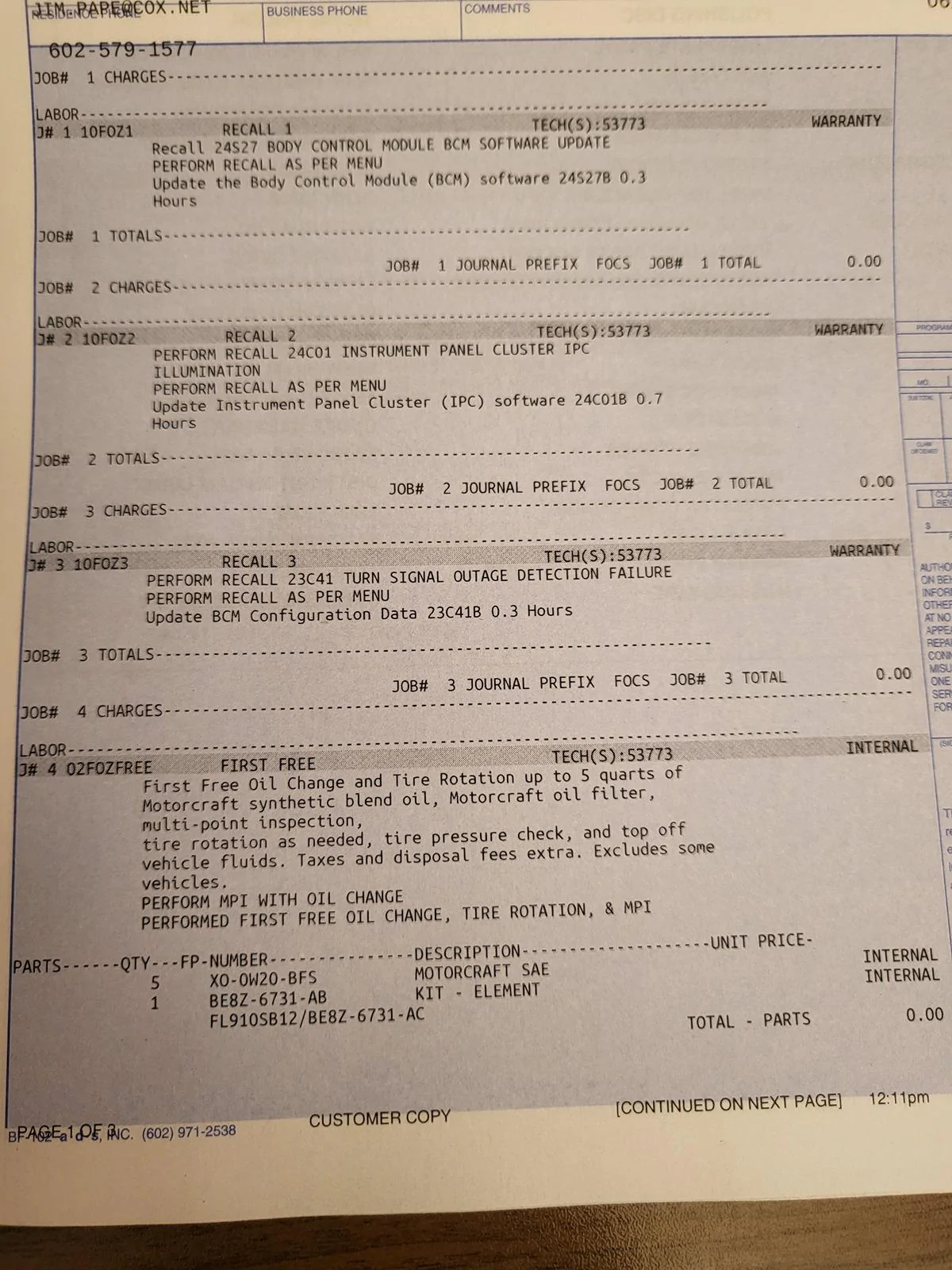

I have been Holding Off as long as possible to get these recalls done. At 6,100 miles I decided to get my 1st (free) oil change and take care of all these recalls. I hope 🤞 and Pray 🙏 that "The Twinkie" survives these recalls and is unaffected by installing the updates. I sure hated to screw up a perfectly running vehicle and take the chance. I will keep you all informed if anything strange happens to the Maverick as a result. Happy Mavericking!
Edit: After looking at the receipt, I see they put synthetic blend in my Hybrid. I was a little upset with that and called the service dept to verify. They (Ford) said all ford vehicles get synthetic blend (except Mustang GT). I should have requested full synthetic from the beginning. I told them that I will be changing the oil myself asap to get full synthetic in my Maverick.

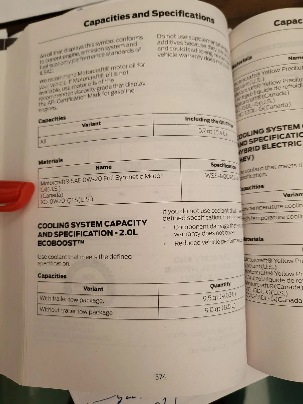

Edit#2, I just sent them a copy of the owners manual (page 374) showing that Hybrid's require full synthetic oil.
Edit#3, The next day, Ford asked me to bring "the Twinkie" back in and they installed the correct motor oil. They also told me that the correct motor oil (full synthetic) was originally put in the truck the 1st time, but they changed it again anyway and provided the correct verbiage on my invoice.

Based on the oil part number on your bill, it does look like you got full synthetic!
XO0w20BFS FS is for full synthetic, b should be for bulk!
The 0W20QFS is full synthetic by the quart
I see that the text says "synthetic blend" That just looks like the standard text that is used w/ the oil change. They are putting in "02FOZFREE" in as a menu item, and the text is automatically populating. Most vehicles take synthetic blend, so that is why the text says that.

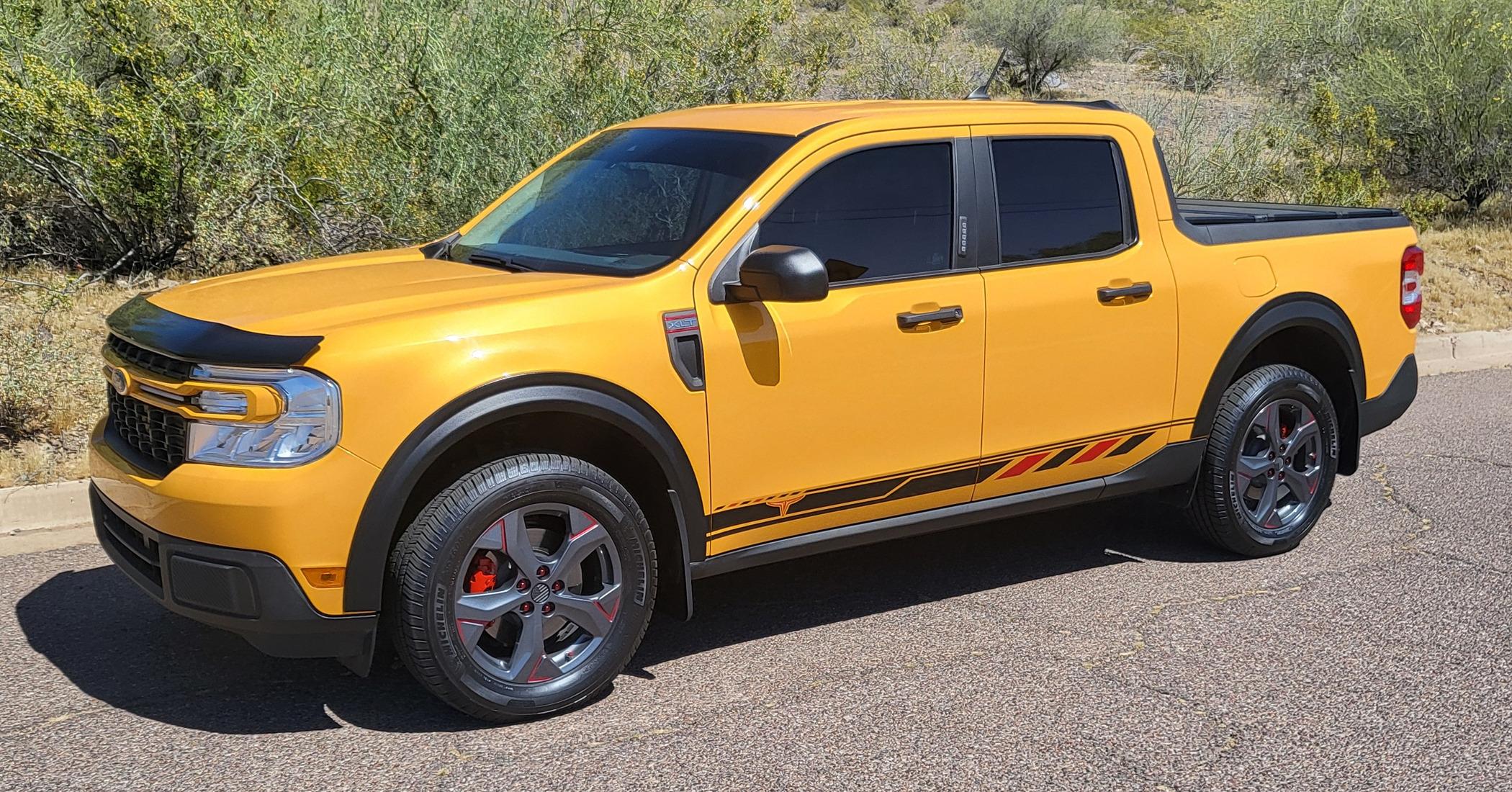

I like all the mods you did to your truck. That's the best looking Mav in that color that I have seen on this site. Leave well enough alone. don't add anything else!
