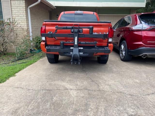

I've been driving around TX with bike racks in TX for over 20 years and have never pulled over. Hell, I got pulled over for speeding in west Texas with a hitch tray. It was loaded with totes that completely obscured the plate, and the cop didn't mention it. This is my current set up.
After looking it up apparently, I'm legal and you're not.
Bicycle Rack Obscuring License Plate. My bike rack obscures my license plate, is that against the law? No, there is an exception for bicycle and motorcycle racks. § 504.945 Section C, item 4.
Makes perfect sense.
