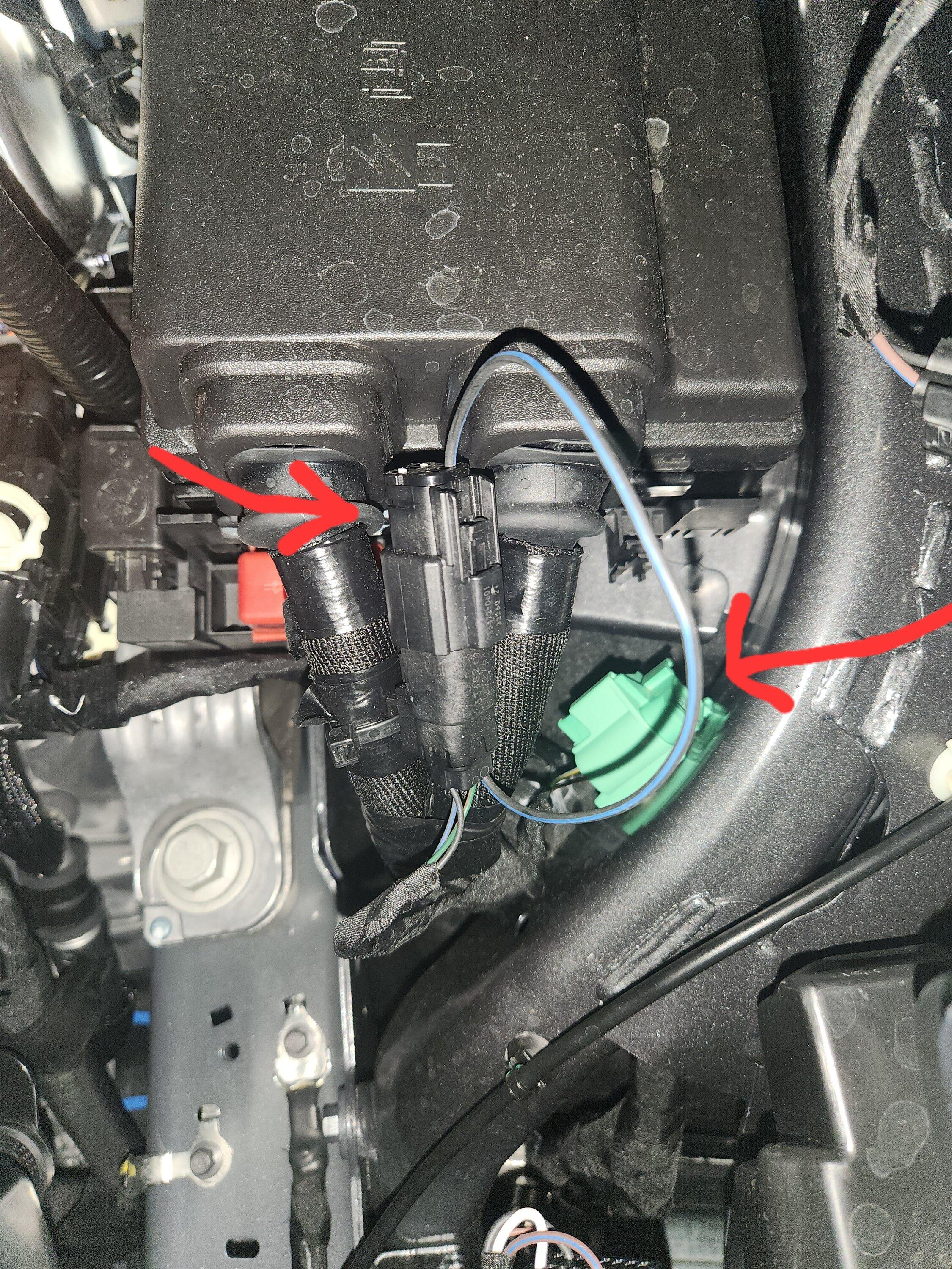

So here is the next question... What are these extra dongles attached at the bottom of the fuse box?
Ford Maverick Engine bay fuse box... Add fuses? 20230406_210926

Maybe the other one is some sort of relay? I don't remember that one being there on my XL EB.
I've done aftermarket mods in the past that look MUCH cleaner than that thing... Its location makes it difficult to flip the fuse box over...
Checking the service manual I think that other connector is C1026 and labelled simply as 'EVAC and fill'. No other reference to it that I can see, but the grey-blue and green-orange are HS-CAN Low and High lines respectively. The thicker black-blue wire looks like it's just used as retention for the female connector being used as a cap.

Confirmed. The cap is easily pulled off, and that's all that wire is for.
Apparently this is something for them to access the CAN interface during service?
Easy to pull
Or possibly for during manufacturing. When I searched there weren't any procedures in the service manual that called out interacting with the connector.
We certainly need to find a reason to hack into the can bus using that baby. There's got to be some practical use for it...
