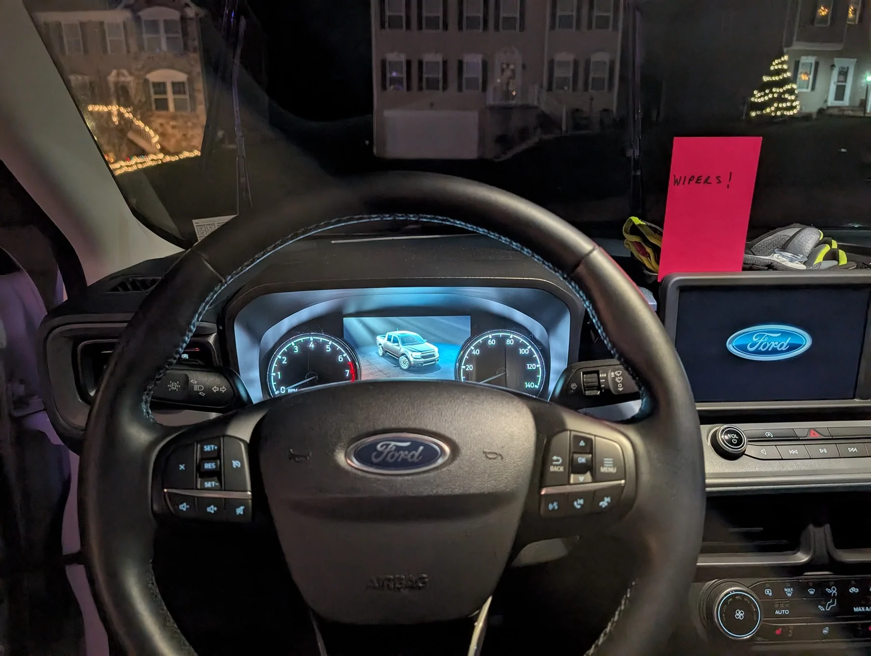

I bump the wiper control down and turn off the key as the wipers swing up, then pull them off the windshield by hand.
Thankfully, the wipers won't run when you remote start the vehicle. But as soon as you turn the key on in the ignition, they'll come crashing down and remove a couple of good chunks of paint from your hood.
It was dark that morning and I didn't see the wipers up and forgot about them. Since then, I have a neon pink reminder card I stick in my dash so it doesn't happen again.

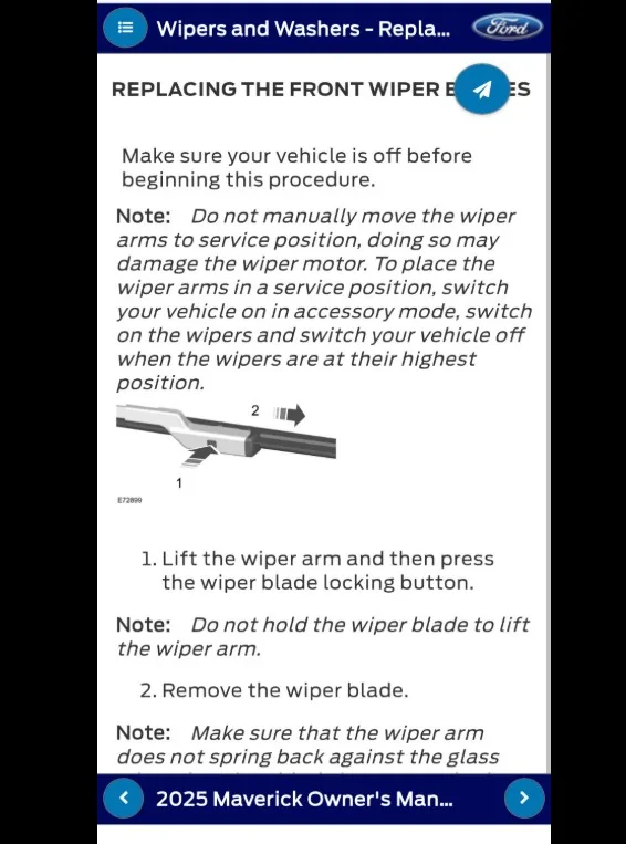

No where in my manual does it contain the statement "to avoid stripping the motor." If you or @ZABSMAV can site the page I would appreciate it. Not doubting you I just can locate it, thanks. I verified just now my printed manual and the latest up to date online manual BOTH say this.
REPLACING THE FRONT WIPER BLADES
Note: For vehicles with a service position, make sure the windshield wipers are in this position before proceeding.
Note: You can use the service position to provide easier access to the wiper blades for freeing them from snow and ice.
Note: Switch the windshield wipers off before switching the ignition off.
Make sure your vehicle is off before beginning this procedure.
  1. Move the wiper blades to the service position.
Note: To place the wiper arms in a service position, switch your vehicle on in accessory mode, switch on the wipers and switch your vehicle off when the wipers are at their highest position. (mine DID NOT cycle in accessory mode only with truck ON)
Note: Do not manually move the wiper arms to the service position unless the wiper path is obstructed by snow or ice.
Note that part I put in bold type. I tested starting the truck with the app and the fob. Both cases the wipers stay in the service position. I parked mine in the service position before this storm with them pulled away from the windshield. To test the remote start I had to completely clean the windshield including the cowl area of ICE since the arms were encased in it. Had they tried to return to the parked position with all of the ice in the cowl it most certainly would have damaged them. To clean that area well required opening the hood also. Based on this first major snow storm if I were not retired the Maverick would be traded off by weeks end. Worse design for wipers and cowl I have ever owned since the 70 Torino which had hide away wipers.

Just going by what Ford says NOT to do. Same info on our 2023 Lariat with Lux package and Heated Wiper Park on the SoundScreen windshield.
Thanks. I didn't look at the 2025 manual only the online 2024 manual.
ZABSMAV
Gary
Mar 7, 2024
632
691
Utah
2023 Maverick Lariat Hybrid
People were damaging their 22 23 and 24 models by manually moving the wiper blades and Ford was having to warranty replace those. They changed it in 2025 going forward so it's on the person if they screw them up.
